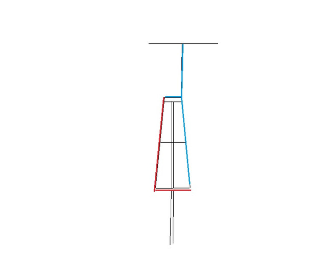

I believe we've been so accustomed to the center feed of coax driving the driven element of a shunt fed antenna that we've forgotten that the braid or outer of the coax will radiate either the top or bottom of a half wave dipole equally well.
There is no doubt what so ever that the AP is a loop antenna fed the exact same way as we feed a loop antenna and it electrically isolates itself into the two halves of a dipole in the same way as a loop does.
The braid is connected electrically to the larger radiator with the top hat via the bracket and the center of the coax is connected electrically to the shorter leg and the basket.
The laws of loop antenna therefore apply, the loop will find it's own inductive and capacitive balance somewhere between the two and a node will appear that is not open circuit but indeed high impedance.
The high impedance node will resist the flow of current but not the flow of voltage and therefore can never be regarded as 'open circuit' nor can it be regarded as 'a dead short for both current and voltage'. It is not a dead short in relation to current but is a dead short in relation to voltage. The blue is the braid radiator and the red is the center feed radiator. Imagine the antenna mounted upside down then you will realise it's nothing more than a straight forward dipole antenna tuned by it's own inductive field which includes the mast.
[/url][/IMG]
So imagine DB that the feed point of the antenna is highly inductive and where the basket meets the large radiator (red meets blue on my drawing) is high capacitance. The voltage is greatest in the high capacitance node and the current is greatest at the high inductance node (feed).
The reactance of the antenna is as follows: Where red meets blue in the capacitance node, the impedance @resonance is in the mega ohms and the voltage in free space is infinite but in reality not so. At the feed point, the current is maximum where it is the most inductive and this relationship is allowed to continue providing the antenna is resonant at the sine wave it's producing and that sine wave is distributed with equal inductance and capacitance per unit length.
In other words the reactance which creates the nodes can only be so when the antenna is resonant and the electrical length is correct. Play around with it's electrical length or resonance then the reactance will change and the nodes will appear in different places around the antenna and screw up the radiation pattern. That's why if you take away the mast part of the circuit the inductance changes and changes the reactance. It's all about the balance and where you make high impedance appear on this antenna.
.....And always remember DB regardless of what you read..the operation of any antenna is dependent on this: The reactance of the tips of both halves of a RF signal towards each other are what actually produce radiation.
It is the high resistance at the tips of the antenna to the flow of current into each other which force the current to swell into an RF pattern. If there is no high impedance there then there is no pattern, capacitance causes high impedance but it can never ever be an open circuit between the tips of an antenna, it can only be resistance or opposition to the tips meeting electrically.

There is no need to do such a thing. Just explain how in a resonant half wave dipole antenna where the current and voltage are in relation to their respective phase angle's, the relationship of those phase's to the distributed inductance and capacitance, explain where the current maxima is, where current minima is compared to voltage maxima and minima. Just explain why the antenna bottlenecks voltage and current in inductive and capacitive regions of the antenna. The whole thing can be written in less than 100 words.
No, i've changed my mind as to the nature of the question, it was too easy. Seeing as the AP is an electrical loop, explain why... when purely resistive circuits have the current and voltage in phase, an RF loop has the voltage and current out of phase, what causes it to be so - involving most of what I asked you above. Phase, current maxima, minima, voltage maxima and minima and distributed inductance/ capacitance (reactance)
Nav2010, your image basically looks just like I imagine the A/P working as a CFHW antenna. The red starting at a <>50 ohm point of a 1/4 wave downward projecting element at the mounting bracket, with the voltage end feeding the high voltage point on an orbital hoop that feeds the high voltage point at the bottom portion of the 1/2 wave radiator. This does resemble a loop feeder, but I'm just not sure how the orbital hoop is described in the science.
IMO the orbital hoop would seem to work differently than a simple length of tubing between the two voltage points like we see in an element on a true loop.
