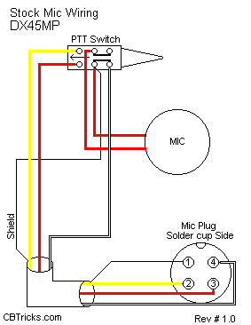

Mic Wiring Diagram
Stock
1- Shield (Ground)
2- Yellow (Audio)
3- Red (Transmit)
4- White (Receive)
