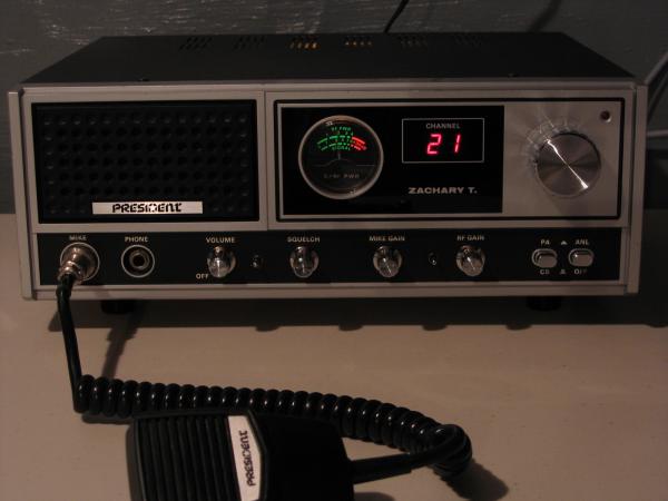

President Zachary T. 40 Channel Base, 10 KHz switch, Extra Lower & Upper Channel select switches, Variable Power Knob
On the front, the switch on the left is a three position switch. Center position is normal CB channels. Up position is upper channels above 40, 41 to 66, selected by the channel selector in positions ch5 to ch26. Down position will give you some lower channels, -1 to -9, on channel selector switch positions ch27 to ch35.
The three position switch on the right is the 10 kHz jump, center is normal, up position will put a positive voltage on the least significant programming pin in the PLL chip, d
