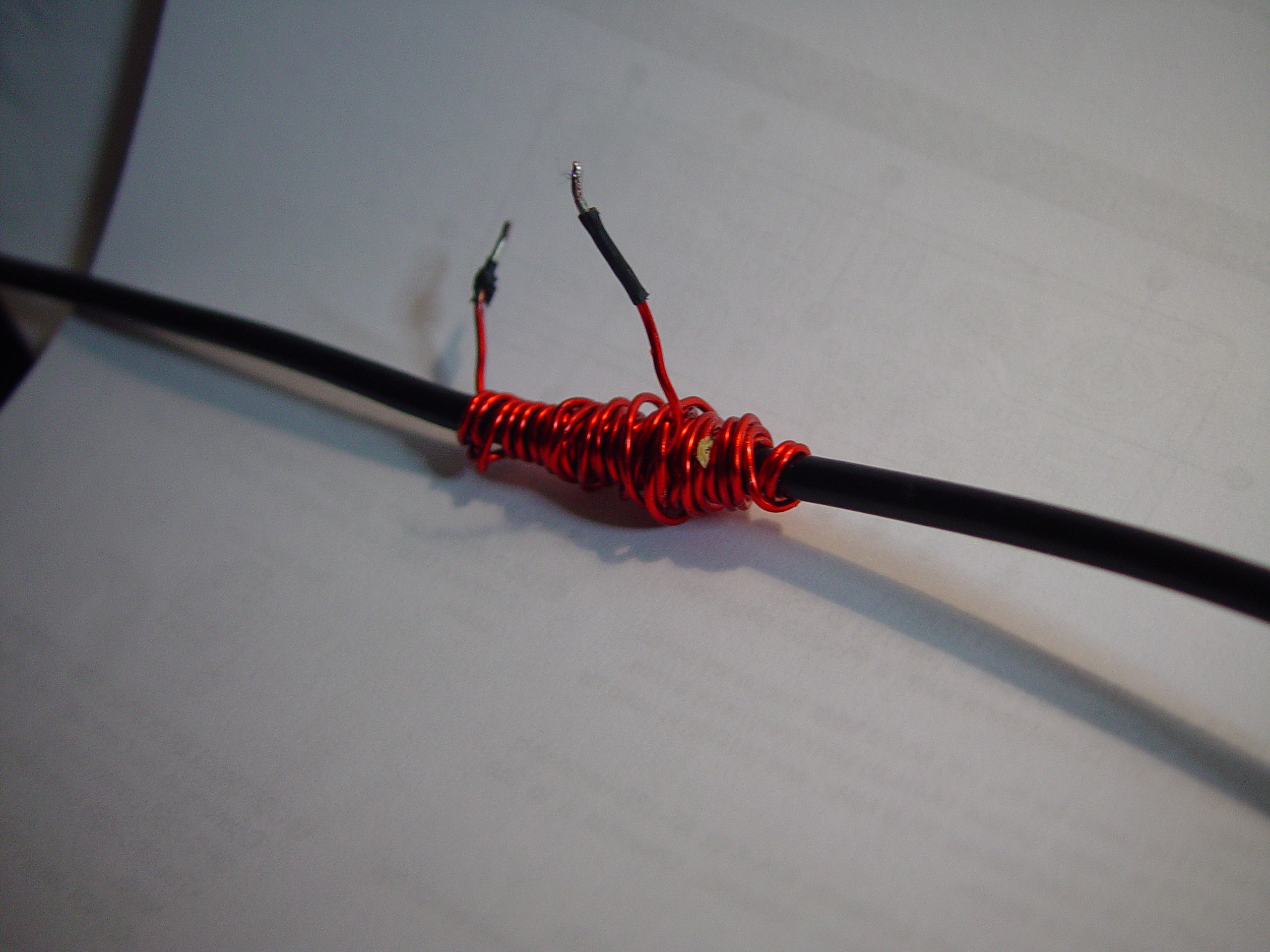

Just a butt load of magnet wire salvaged from an old computer power supply
This is a Common Mode pick up that I use for looking at transmitter outputs. No danger of shorting the RF outputs and no danger of RF burns. Just connect scope probes and use the AC on one channel. Good for watching out for carrier output when doing SSB tune up,
