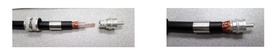

Here is a crimp/solder connector. A ferrule is crimped over the shield against the body of the connector. The center conductor is soldered to the the center pin of the connector. IMO they are 100% reliable and quicker to install than solder/solder types. The do require a proper crimping tool however.
