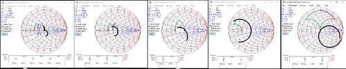

There was also no mention of the projected scale on the bottom of most smith charts, no mention that one doesn't even need the admittance chart to do the parallel components (although smith charts exist with both impedance and admittance for your convenience eliminating the ruler and compass), no mention of plotting coax loss, no mention of Q (the further from the center, the more things change with frequency) etc.

Regarding the bandwidth comment I made above. I got bored and opened multiple smith chart programs, set each to the same center frequency (30MHz) and same span (30MHz) and same impedances (20Ω transformed to 50Ω) so we can see how going further from the center makes the match more narrowbanded. The black line shows where the match ends as the frequency is swept. There comes a point when the added component count and the inductor size and loss interfere with your ability to achieve wider bandwidths.
