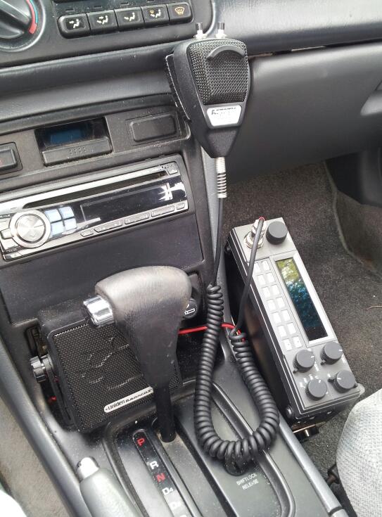

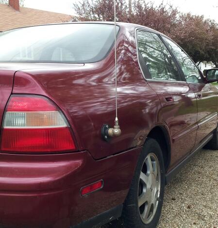

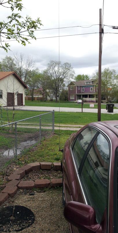

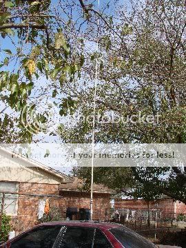

Well finally got around to putting up a few pics of one of my mobile. I always wanted to do a 1/4 wave whip just never wanted to ball mount.....til now. The wife got a new (used) car so I ended up with the 20 yr old honda as my back and forth to work ride. What better than this old beater to drill a hole in the fender lol. I went with a mfj 1966 108 in stainless whip mounted to a Breedlove solid brass adjustable ball mount. I drive this with a (dtb tuned) 2950dx w astatic 636 (with up/down channel buttons I installed) and an old Texas star 250hd. I took my time with my install getting a good ground for the backing plate of my mount, ran my power off the battery and grounded amp and radio to seat bolt. So far I couldn't be more pleased with the results. Wow does this big whip work and is broad banded! I still have to mount a fan on the amp but is doesn't get to hot since I mostly run ssb. Car does get some funny looks though...

Looks stealth honda install to me, im a solid 1/4 wave fan, regardless of its length, we all know a 8.5' whip has the most awesome signal of all! and to drive it with a little bump / no better way to go,,,,trunk mounts are flimsy, and it sounds like you got the back side of that ball grounded and braced well so it dosent flex and rock the body pannel around (as she sways)....good job!

Nothing at all stealth about my install lol...looks like a remote control car. Still working well bout a year later. The Breedlove mount is VERY heavy duty. If some kid thought he would pull a prank and pull it off, the entire rear quarter panel of the car would come off before the mount would.
Is that a 102" or 108". If its a 102" you need to add the pot belly spring to make it a 1/4 wave. It work very well. I had a 90 Corrolla mounted in the same place. got me out pretty well. SSb and AM w/my 2x2879 Davemade.
