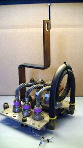

Even high current single diodes screw into some kind of metal used as a heat sink to dissipate heat.
The bottom example has active cooling

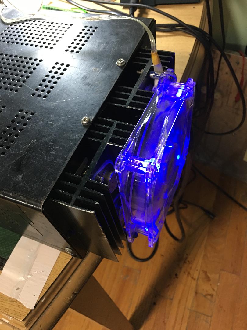

I wired up a home brew PS (Pyramid 35A case but heavier insides) to heat the 4cx300 filaments for several hours (NOS years of storage). I measure less than 7A (just the filaments). I expected less than 6A.
Anyway, the four 2n3771 got so hot I added a fan but it still feels too hot. I can't imagine leaving it for several hours as suggested after years of storage. I'm considering doing one tube at a time. Tubes are 6v so I;m not wiring directly to transformer (>6.3).
