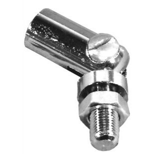

Another easier suggestion to keep what you have is to use on of these adjustable angle mounts. Just try to keep the angle less than 45 degrees.
