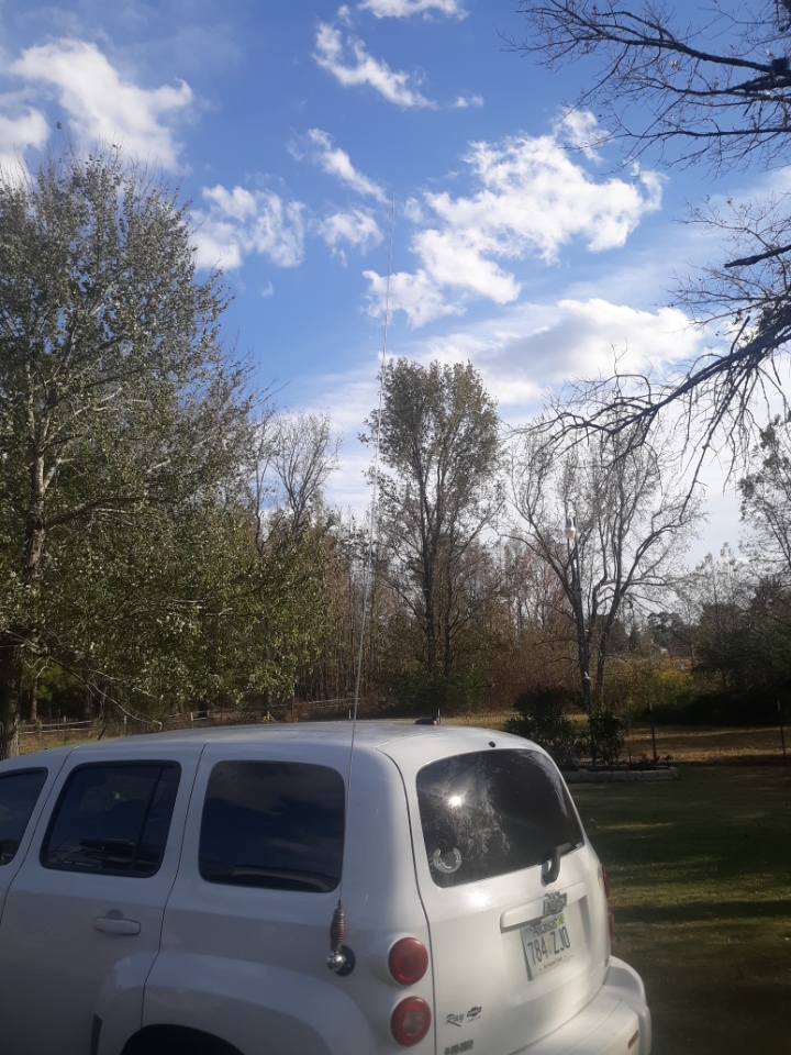

I understand that the antenna uses the vehicle as part of the groundplane as well as the "spill over" of the ground plane that tries to use the real ground for a mirror. All this being said, what happens as you lower the feed point toward the ground? In a base the feed point height changes the take off. Same in a car I suppose?
This all started when I took the radio and 102 whip out of my truck and mounted them in the car. The whip was mounted to the toolbox in the truck but in the car it is mounted on the side by the tail light. So it's almost 3 feet lower to the ground and has zero metal below the feed point unlike the truck. The radio works way better. Amazingly way better. So is it the height off the ground, the ground being used more as the groundplane, the take off angle, the truck bed not trapping or reflecting back into the antenna or what?

Ball mount. Yeah the truck box was strapped and bolted. Same stinger, same radio. Analizer in the truck said it was a good match. Car says it's a good match. Its crazily though. All I can figure is I have a better ground plane.

Car mount location
Wow! Considering approximately one-third of the antenna is very close to the body, I'd say you got lucky.
Consider that I went from an s10 to this hhr using the mount where I put it, I wonder if I had it on the roof how itd do. As much as I'd like to know I ain't gonna try it. Although I did have a car with a puck mounted center of the roof and it did well. I had thought about ordering the trimag mount and using it with a whip. Might later.
