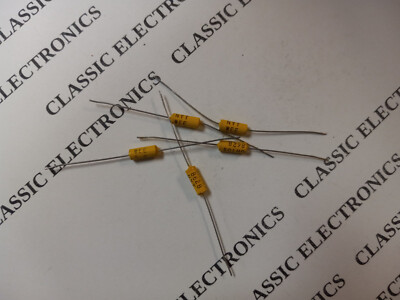

You can try adding a 5.6uH rf choke in series with the varactor or try an NTE614 varactor or a combination of the two.
Chokes like these:
