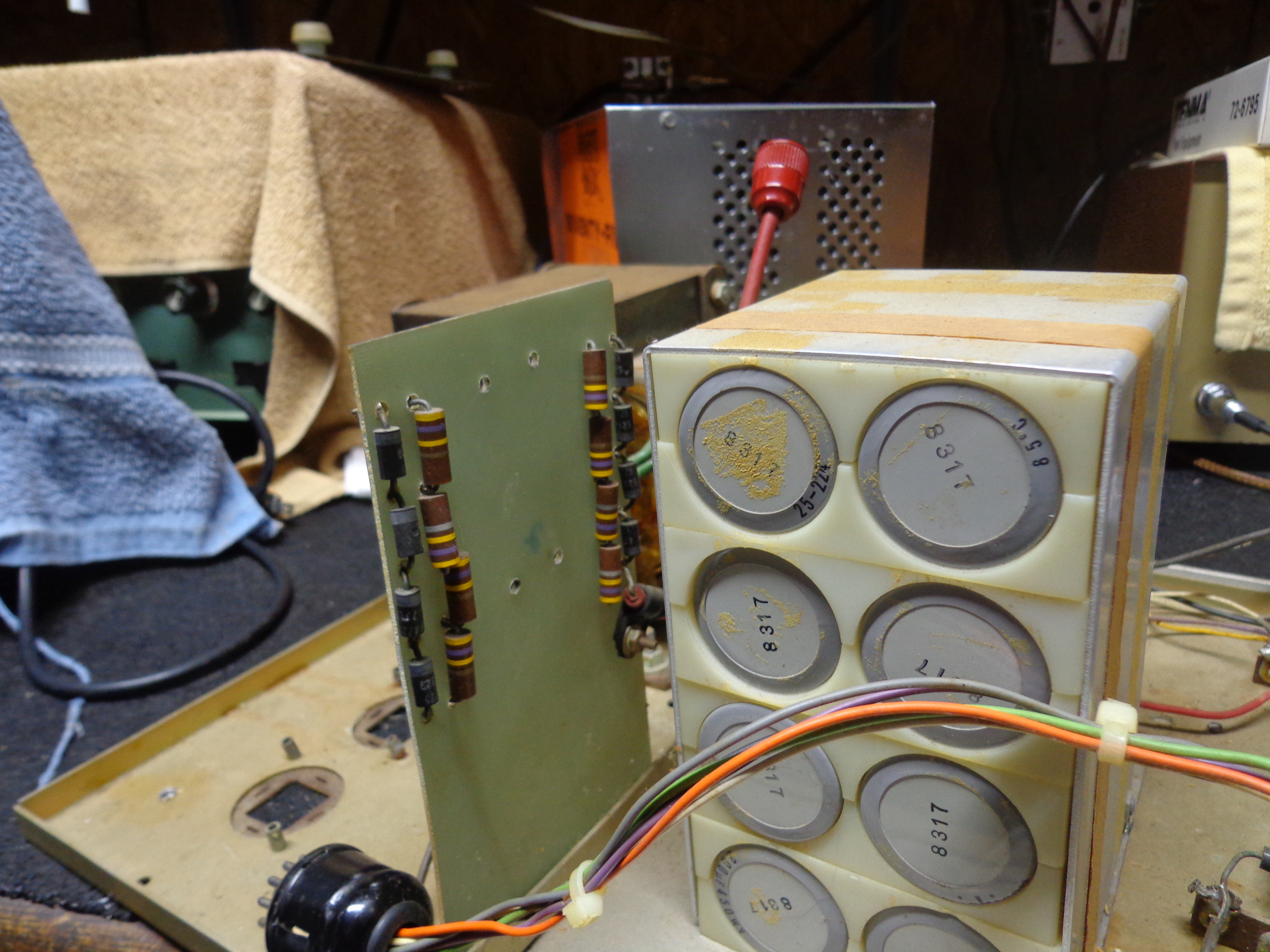

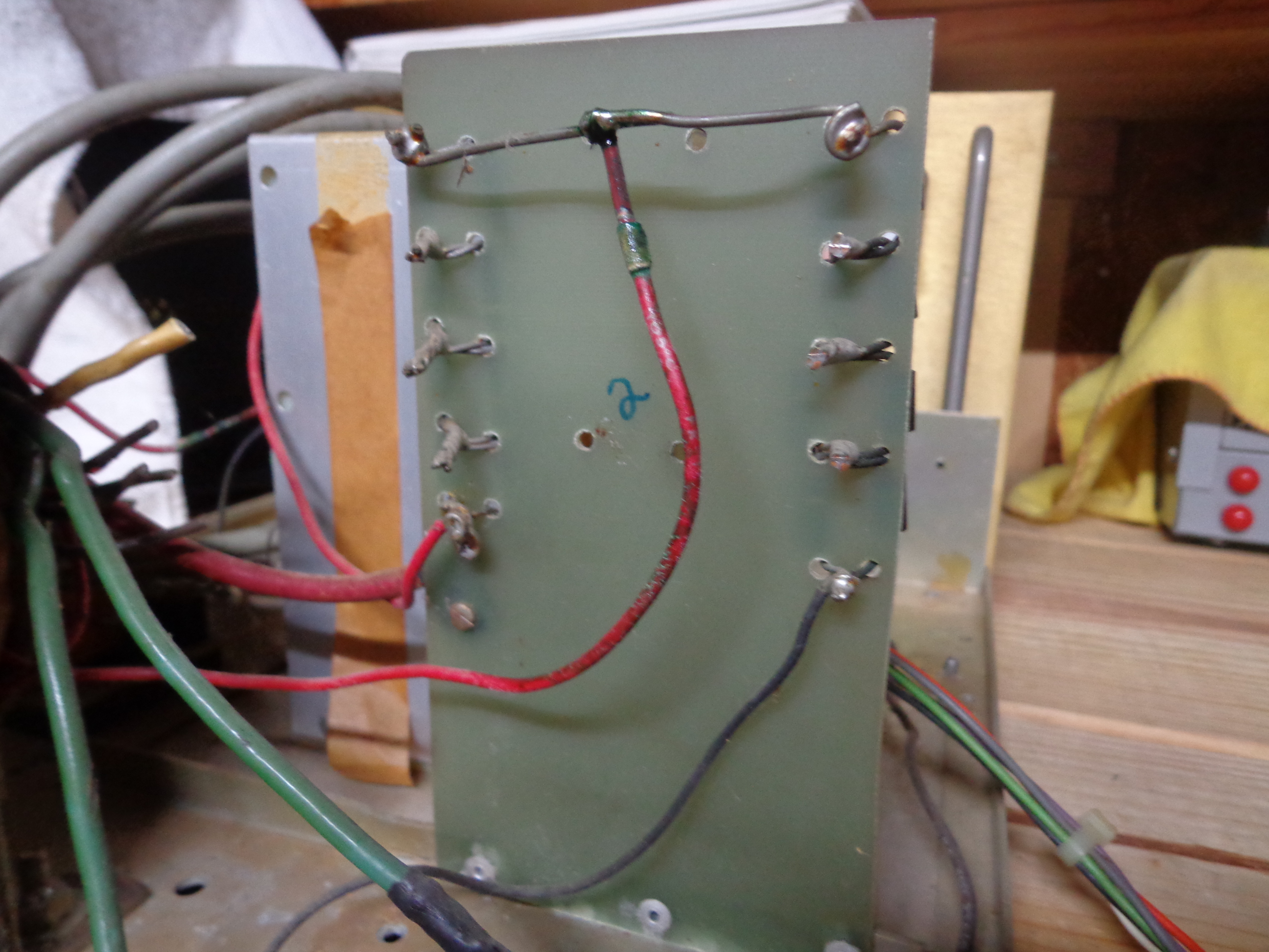

Replacing the caps & diodes & resisters in my one tuber. The diodes are 1N4725 i have 1N5408. By the specs they are both 1Kv x 3 amp. So the 5408 should work ok 238
