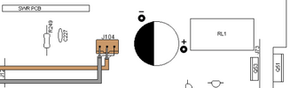

White and Gray shielded wire connects from J104
To CN608

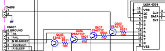

Q603 good? Signal/voltage on pin 14 of U604?
