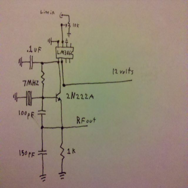

I drew this schematic, its a QRP AM transmitter for 40 meters. Have not built it yet, does it look like it will work? This will feed an IRF510 Final amplifier section that I am building aswell.
Output should be about half a watt from this section, driving the IRF510 Final section and should put out about 5-7 watts.

You need a direct power connection to the collector of the transistor. As you have it now the output of the opamp feeds the collector directly. You should have a direct Vcc connection to the transistor and the output of the opamp should be capacitor coupled to the transistor collector or better yet feed the collector through on side of a small audio transformer's winding and connect the output of the opamp to the other winding and ground. Either way will modulate the power supply voltage causing the RF to be amplitude modulated.
There is voltage present at the colector, through the opamp, pin 6 is the power input, the voltage is also present on pin 5 the audio output ,same as the voltage input on pin 6. But if that is not the case, what value capacitor do you suggest to put between the output of the opamp and the colector?

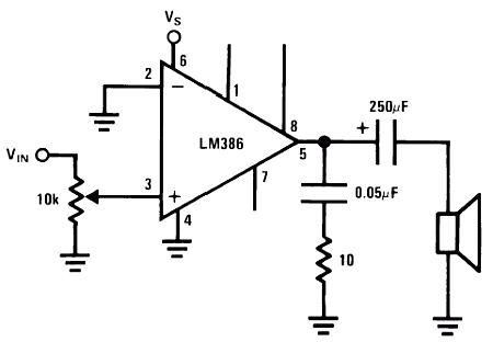

You could try it like that and see if it works. I have just never seen nor used opamps like that. The DC voltage present on pin 8 MAY possibly power the circuit but running a separate line WILL power it. Also in my experiance with those LM386's they won't work without a cap of around 0.05 uF or so and about 8-15 ohms in series to ground on the output as shown below.As for the O/P cap, anything will do as long as it is at least 1 uF. The only thing affected really is the bass response.
Thanks for the suggestions CK, I'll make the ajustments to the schematic and see how it goes, just a side note...How does the cap on the output affect bass response, will increasing the value increase or decrease bass response , volume and modulation? I need this to sound clean but still loud enough.
Thanks
T23
More C equals more bass but after you get above a few uF it makes very little difference. Something like a 0.1 uF however will have a noticeable effect on the low end.

Yeah, I am also trying to fit all this in an altoids tin, too. .I built the fist stage, I tested it, but it did nothing. I think I found the problem though, two cold solder joints... I need to figure out how to do somthing other than toroids for the coils in the final. But first I need to get what I got working...
T23
I fixed it, it works now, I put a .1uf ceramic disk capacitor inline with the output to isolate the dc voltage from the RF, no noise in the signal from the tests, but I haven't modulated it yet.
I am using a different transistor than in my schematic, its a 2n4401.

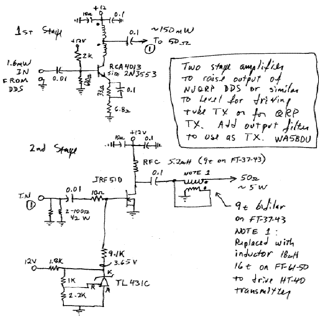

Here is the schematic I am basing my final section on, still debating on the buffer stage. I still have to order the toroids ( two FT37-43 ) and the voltage regulator for the Mosfet bias, I think the bias is suppose to be about 2.5 volts, I have found a voltage regulator at radioshack that is adjustable from 1.5 volts to 30 volts with a resistor combination. I think I'll do my keying in the final's 12 volt input line but keep the bias voltage present even when the final is not keyed, or do the keying in the buffer section if I choose to do the buffer section or not.
