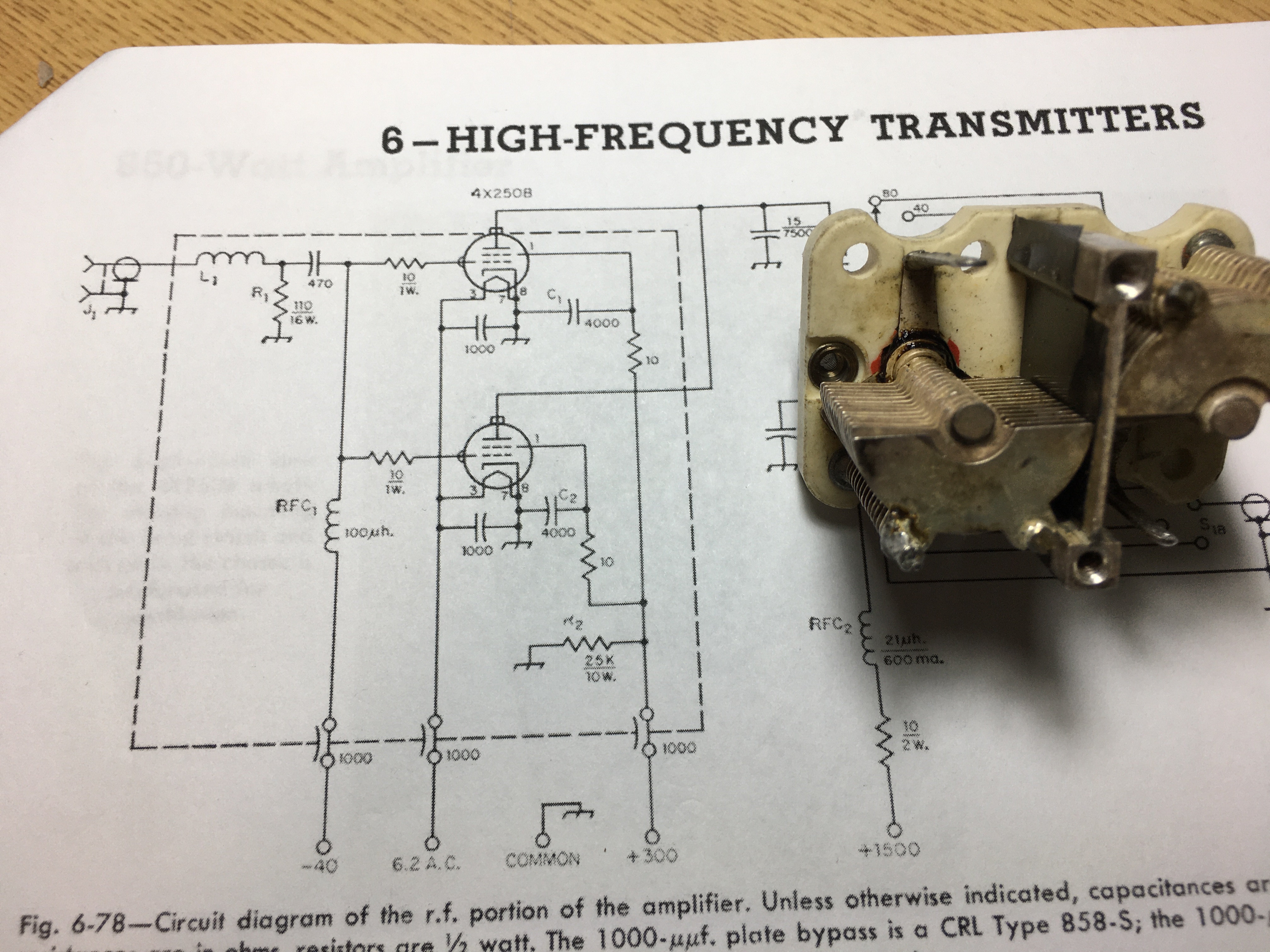

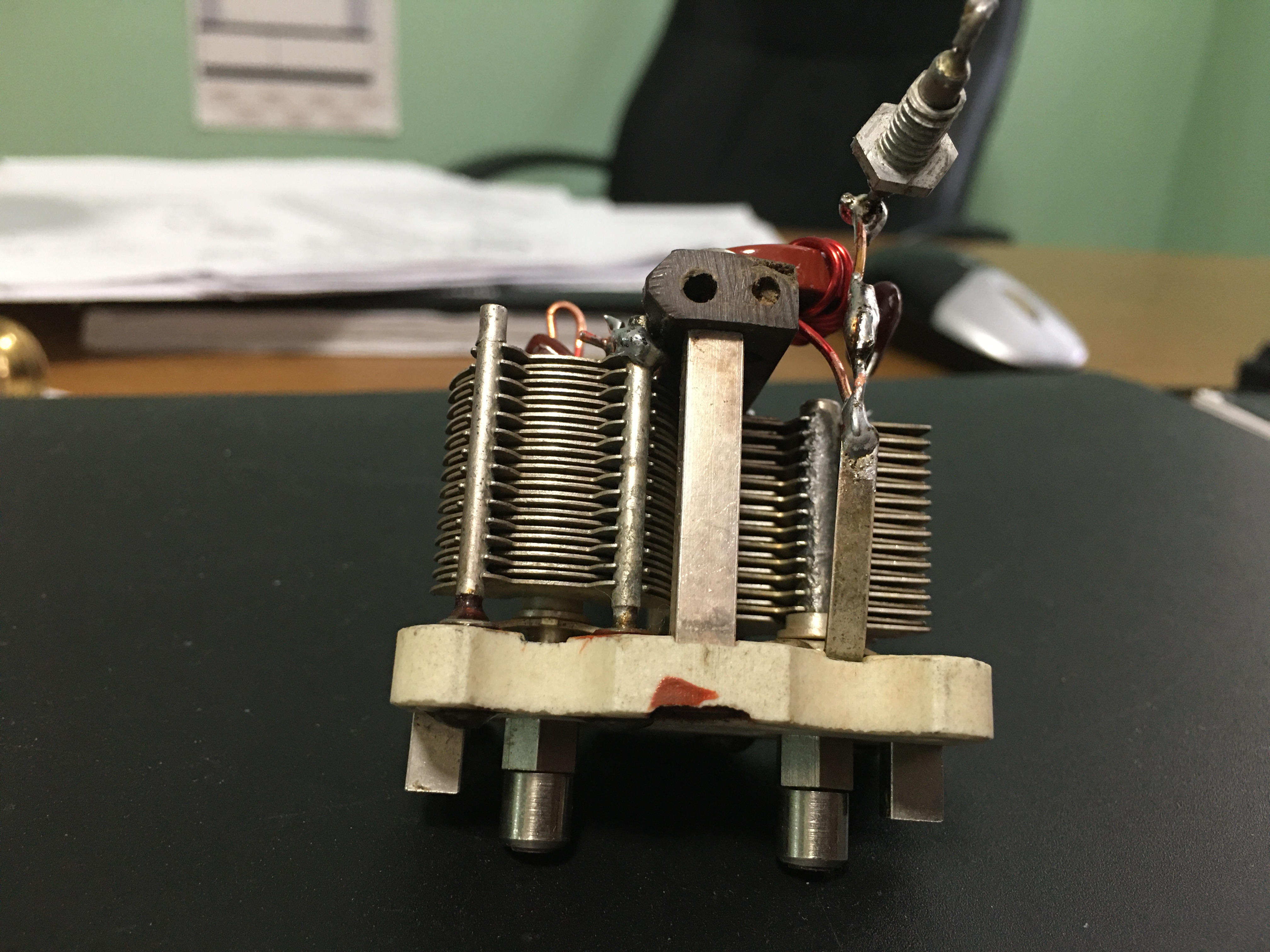

So, I found a grid driven 813 10-80 amp diagram that placed a T-50 red core (11T 20ga) across 2 Variable caps preceding a swamped input so I’m trying to copy that. I settled on a 110 ohm swamping value from a 2 x 4x250b diagram from another 10-80 amp from 1960's ARRL Handbook. The article stated that the 110 ohm value was calculated for 30w max drive. Major presumption here being that the 4x250b is same as 4cx250b/4cx300a. Guess we’ll see but it should be Ballpark and I can always go back to 50 ohm. I may need to rewind the T-50 red core for 1:2 given the 110 ohm resistance.

and swr analyzer said it's OK for matching the 110 ohm swamping scheme for 30w max drive. I used another T-68-2 red core and 20Ga magnet wire. That 110 ohm grounding scheme came from a 1958 QST: A Compact 650-Watt Amplifier.

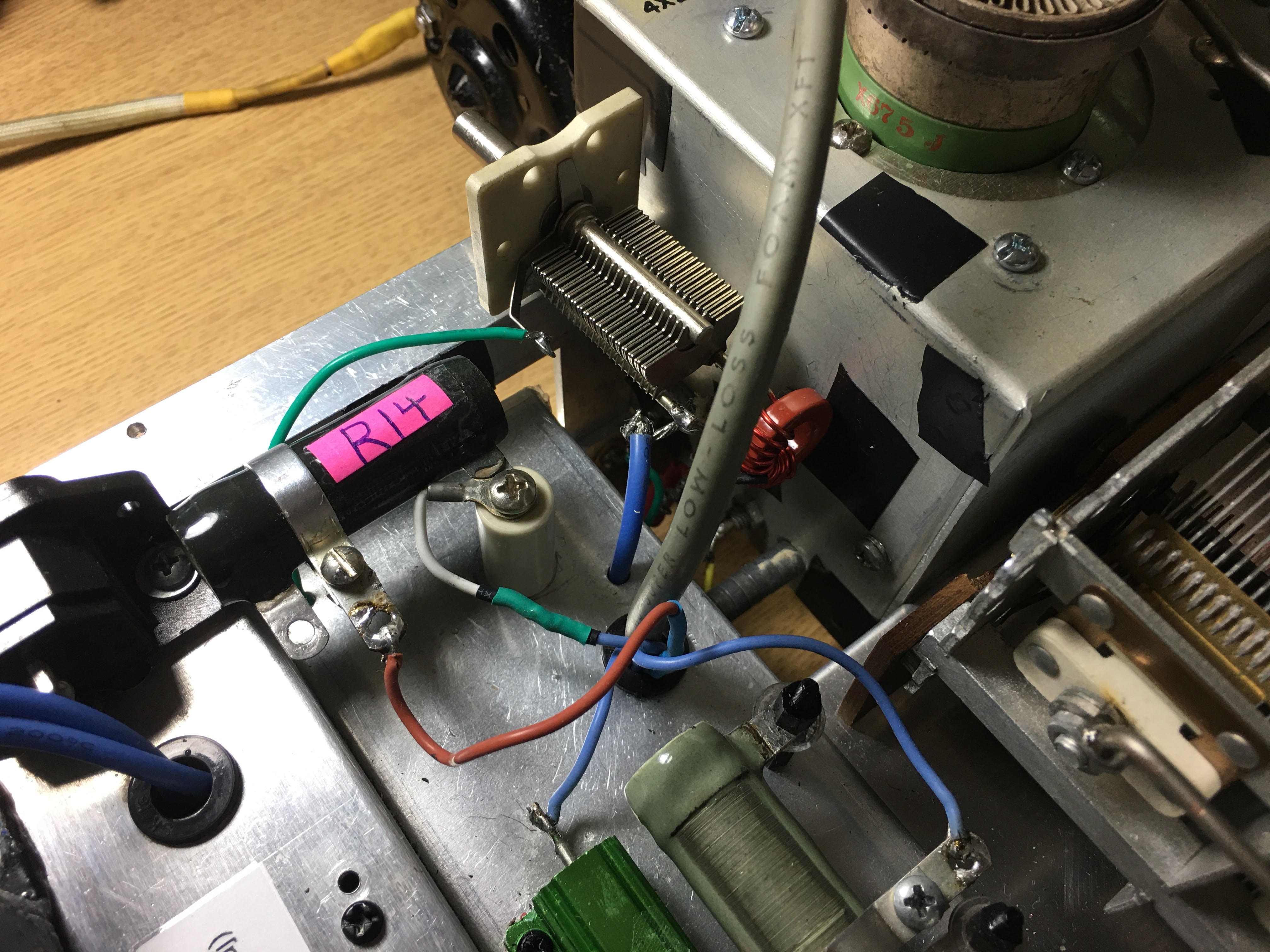

Unun fed by coax from T-R relay. Unun attached to the small T-match attached to outside of blower-box. A pass-thru drives grids inside box. I placed swamping resistor (N.I. 110R 50w) after the Blocking cap.
The placement of swamping R keeps nagging me: Before vs After Blocking cap? Diagrams I found seem to use different locations as variously as DC vs RF grounding is used. Anyway my swamping R is RF grounded only so I made it robust with 4 parallel caps, 2 large ceramics and 2 small polyesters.

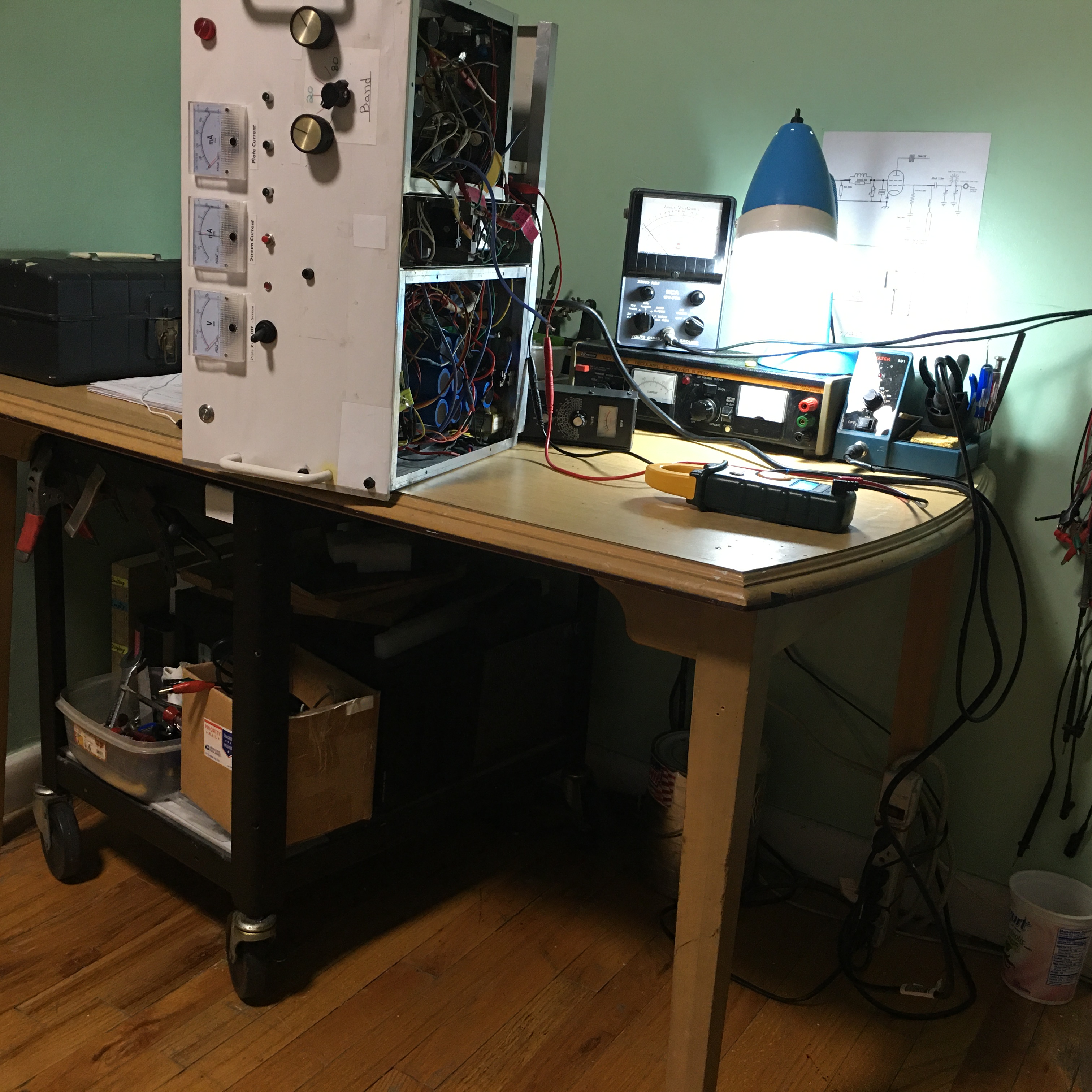

I apparently installed the wrong bias Zener (56v) for the 300a tubes so I'm waiting on replacement (51v). I have 2 sets of new & used 4cx300a & 300y and placed a small toggle to switch Zener voltages (-55 & -70). Looking back it was silly idea. How often would I change tubes, right? This project a mess but I learned a lot.
While re-setting the standing-current & trip levels for Screen & Grid I found that my Screen voltage is low for the 300Y tubes. I'm a 32v shy of 400v on datasheet. Maximum Screen voltage I have at tube pins, regulated is 363v. It's 13v more than the 300a (reachable via Tetrode Board adjust range) but too low for the Y tubes. Remains to be seen if any advantage from the 300Y over the 300a. :censored:

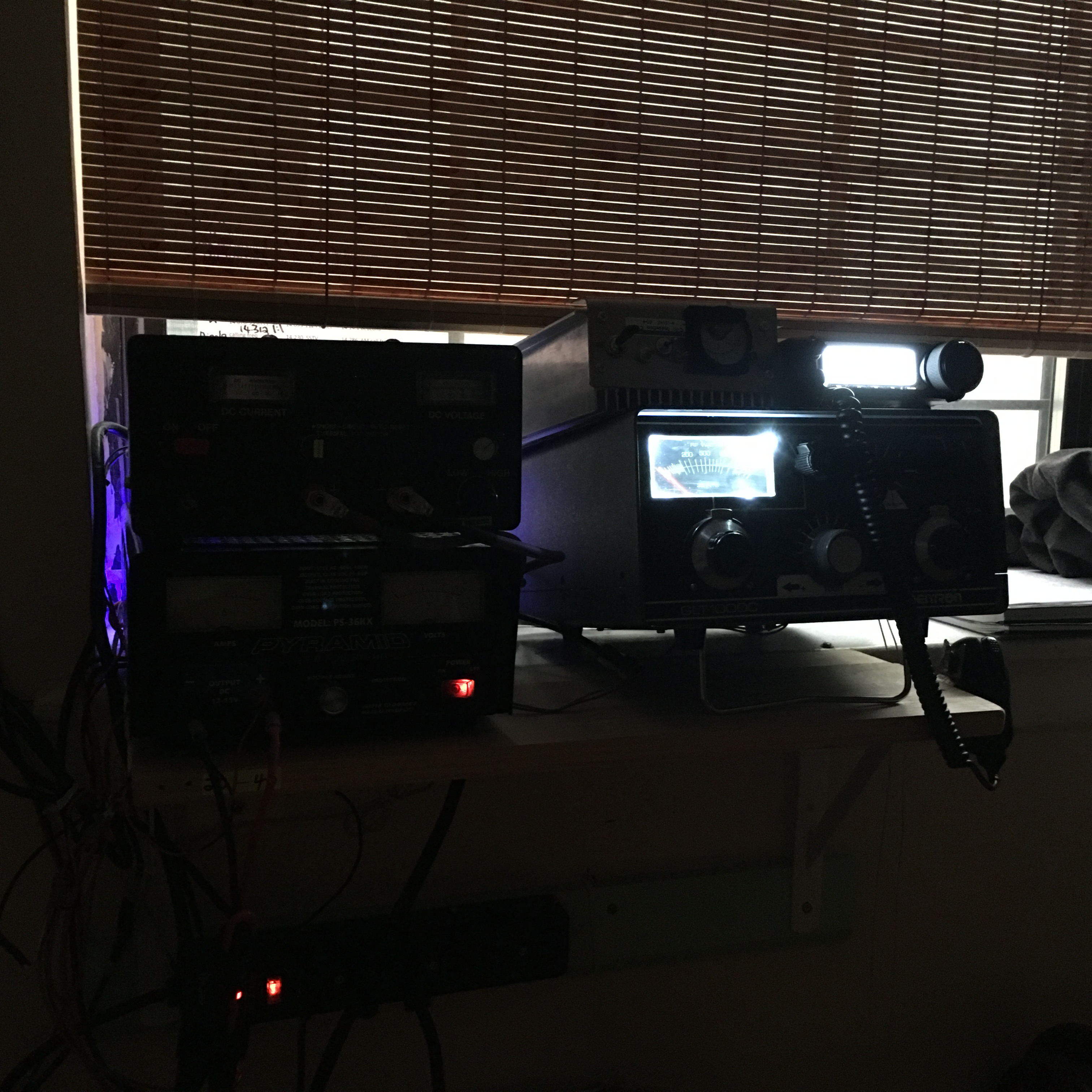

Added some LEDS to my Dentron ATU meter (which I just repaired & calibrated). Pictured glowing away below. Makes evening use easier on the eyes.
