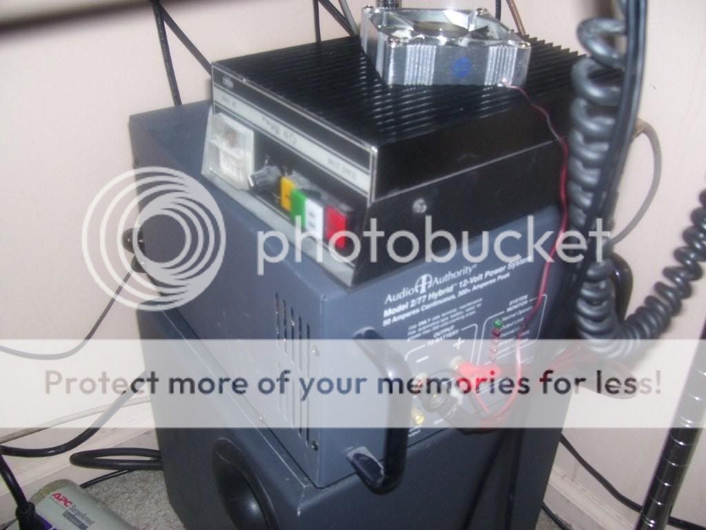

PS: Booty, do you use that amp with your equipment on top of it? The small vibrations would tear your stuff apart! Its not the big falls that break electronic, but rather the small pulses that giggle it all to pieces.

i put some rubber nonslip feet on the bottom of the 500v (as pictured upside down) to prevent it and the P/S from scratching each other . there was no vibration from the power supply it was sitting on . many texas stars have lasted over a decade in mobile installs and some probally have over a million miles with truckers . i dont think theres anything in the house that could shake or vibrate it more than that ........ unless my big fat azz had fell on top of it . hehehehe

Booty, I meant that you have your power supply on top of a subwoofer...haha.
