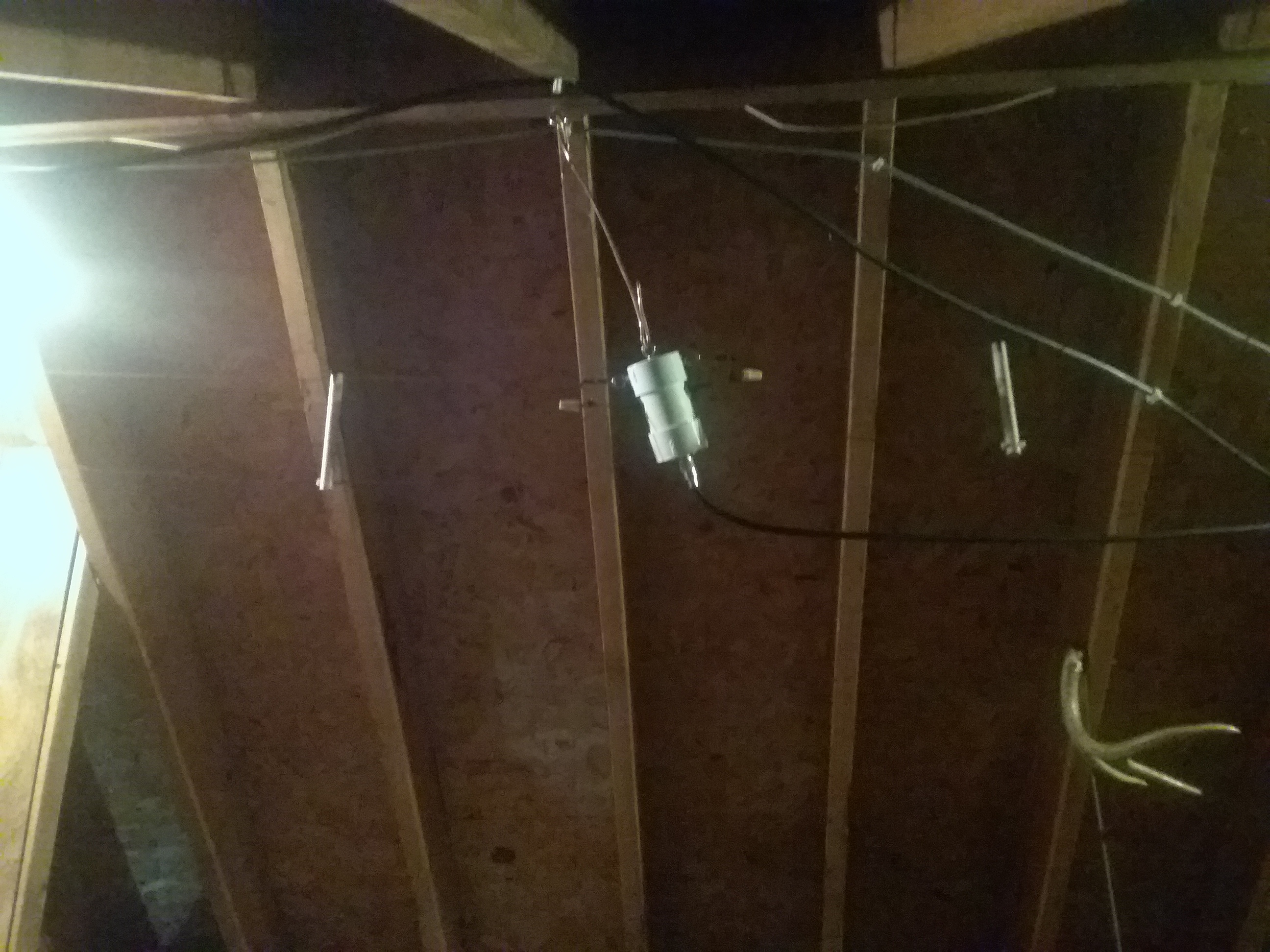

Project of the day. My soldering iron wouldn't get hot enough so I just cut and wire nutted in the 6 meter legs,4' 7" each side. Radio tunes 50.50 at 1.2 swr. Thanx for the help!
