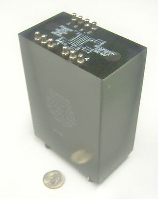

6.3v @14A Transformer Ebay listing, single winding useful

Beware of anything related to use in aircraft. They use 400Hz NOT 60 Hz AC to reduce the weight of the transformers. Higher frequencies do not need as much iron in the core. Look at the specs on the one above and you will see it is rated for 380-420 Hz. Do not even think of connecting that too a 60 Hz source.
