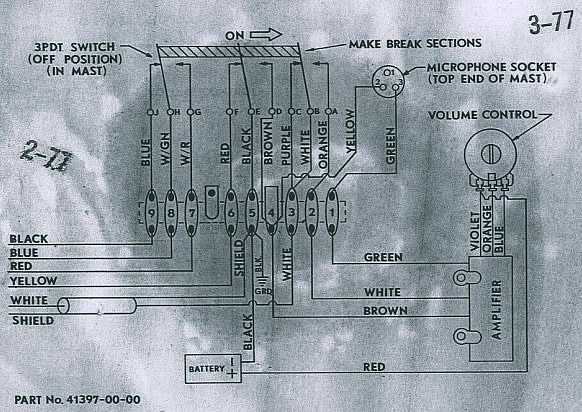

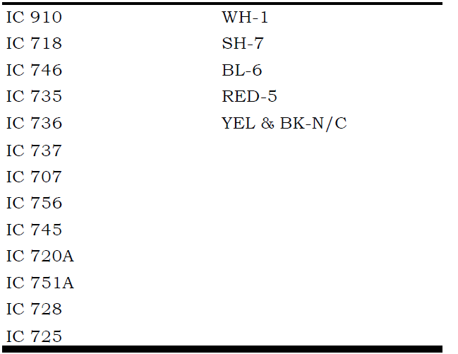

6 wire D 104 to an icom 746 non pro.
This should get you started.

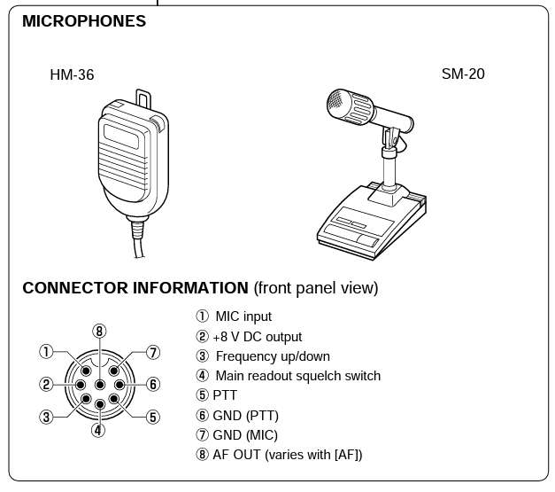

Use above guide or you can always wire it to a 4 pin (Cobra) plug and then get a 4/Cobra to 8 Icom adapter on eBay or elsewhere.
Most amateur radio's have a pretty wide audio bandwidth a D104 would effectively degrade that. Is that on purpose? Plus the Icom has +8V on the cord you could either power the unit or you could replace the mic element with and electret and power it from the radio.
