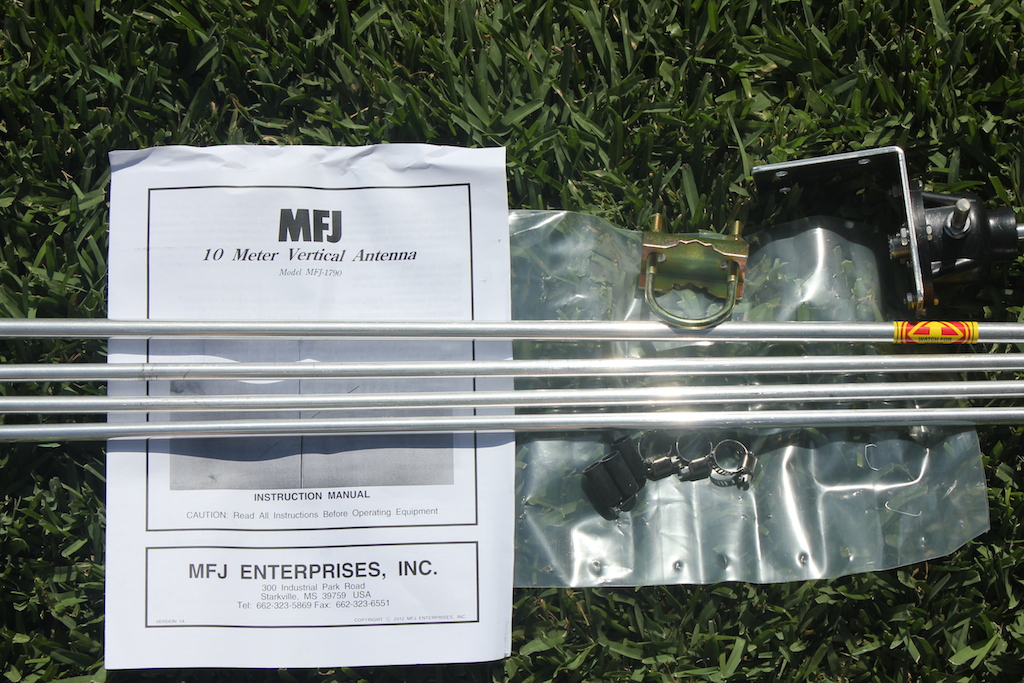

Here's everything that comes in the bag, laid out on the ground:

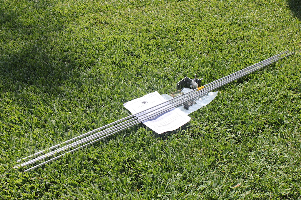

Here's a full length picture. The longest aluminum tubing are about 5 feet long, which doesn't make this antenna the smallest portable antenna available, but at least it's manageable.

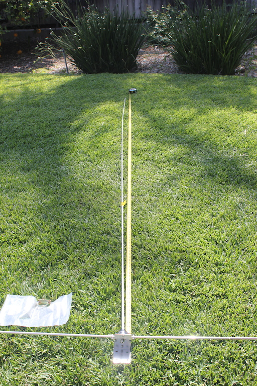

Attach the top section of vertical tubing and then measure the overall length to set it at 11 feet, which is the length indicated by the manual.

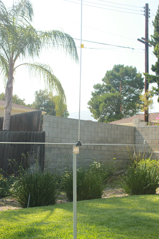

Mount the antenna at least 3 feet off the ground to test for resonance:

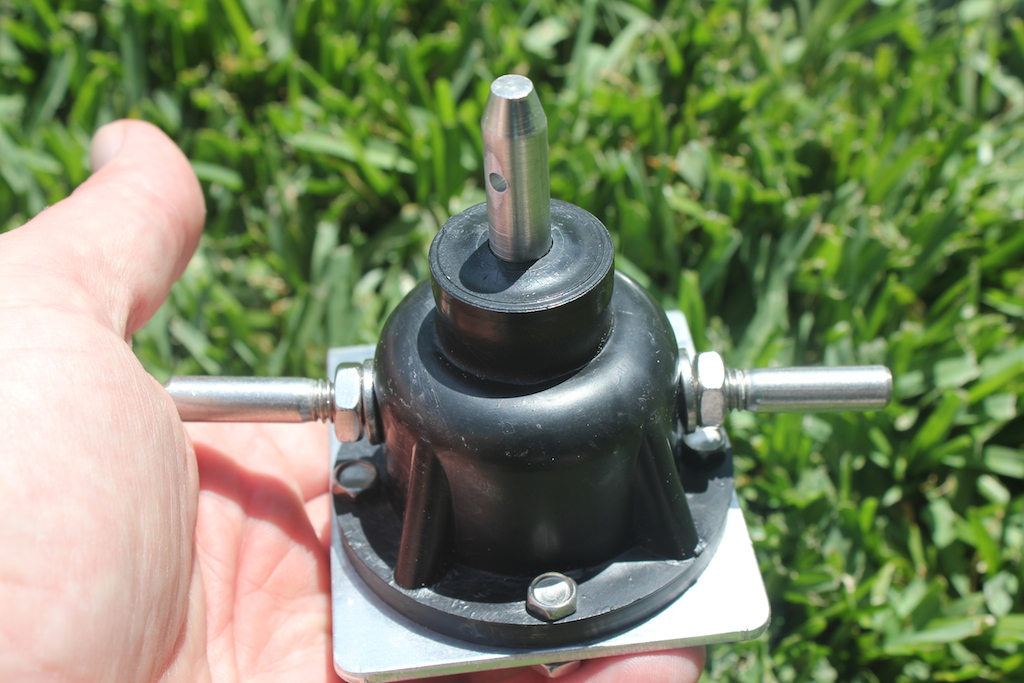

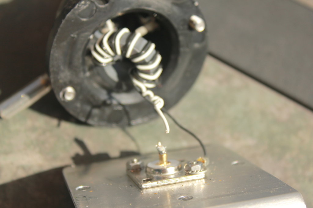

I initially hooked up the MFJ Analyzer and couldn't find any frequency where the antenna would work, so I knew something was wrong. After taking the antenna down and unscrewing the hub from its base, I found this:
The MFJ-1790 claims to be an off-center fed vertical. As you can see, the matching section is inside the hub. The antenna I was shipped had the center conductor broken off during assembly. I quick solder job fixed the problem, but when I put it back together, the tight assembly made it easy to understand how something like this could happen.

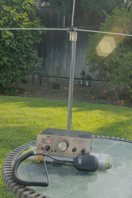

I hooked up the MFJ-9410 10 meter SSB transceiver and was ready for some back yard QRP fun!

what is that sitting on the radial?..... looks like some kind of spray can

The one thing I find suspect in this antenna's manual is how close to the ground below you can mount this antenna. They talk about tuning at three feet and then raising it to mounting height. I would go higher than that as I think this antenna's feed point impedance will change with antenna height at low elevations, at least 10 feet up when tuning if you plan to mount it higher.
