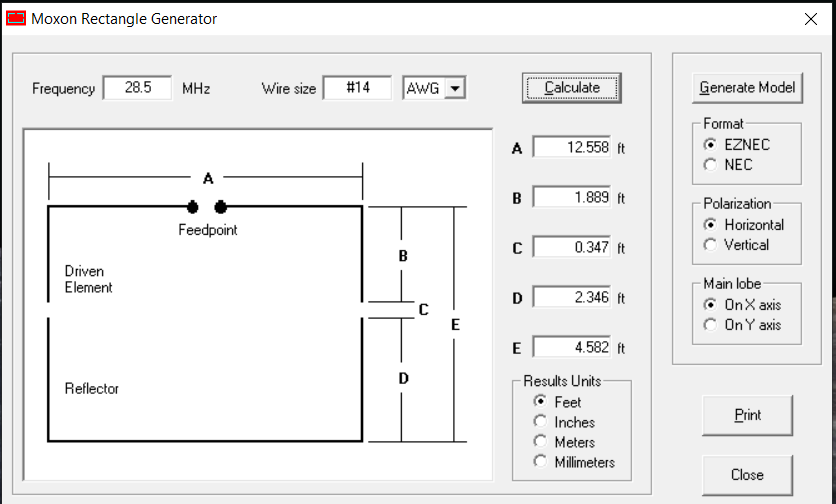

I started By using MoxGen to calculate the element lengths and spacing. MoxGen can easily be downloaded to your computer at: https://www.ac6la.com/moxgen1.html

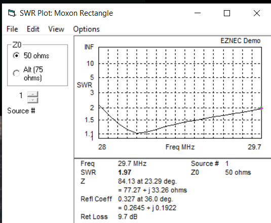

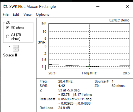

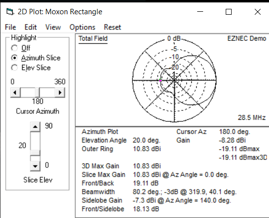

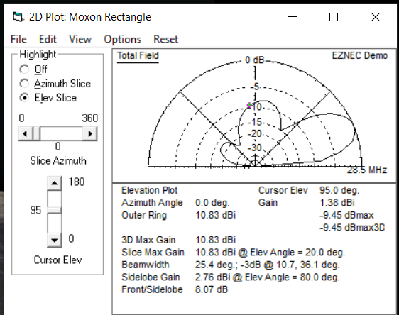

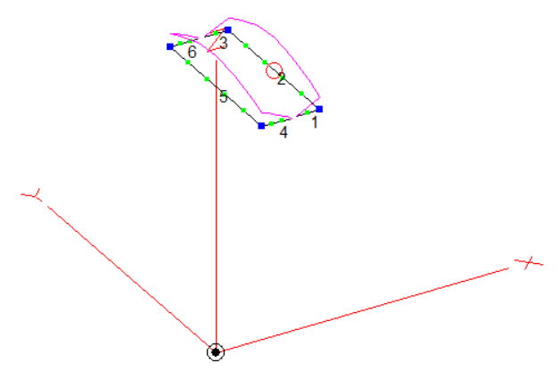

Next I used EZNEC Demo to model the antenna. I settled on 21 feet Above Ground Level.
Screenshot (8).png Screenshot (6).pngScreenshot (16).pngScreenshot (14).pngScreenshot (12).png

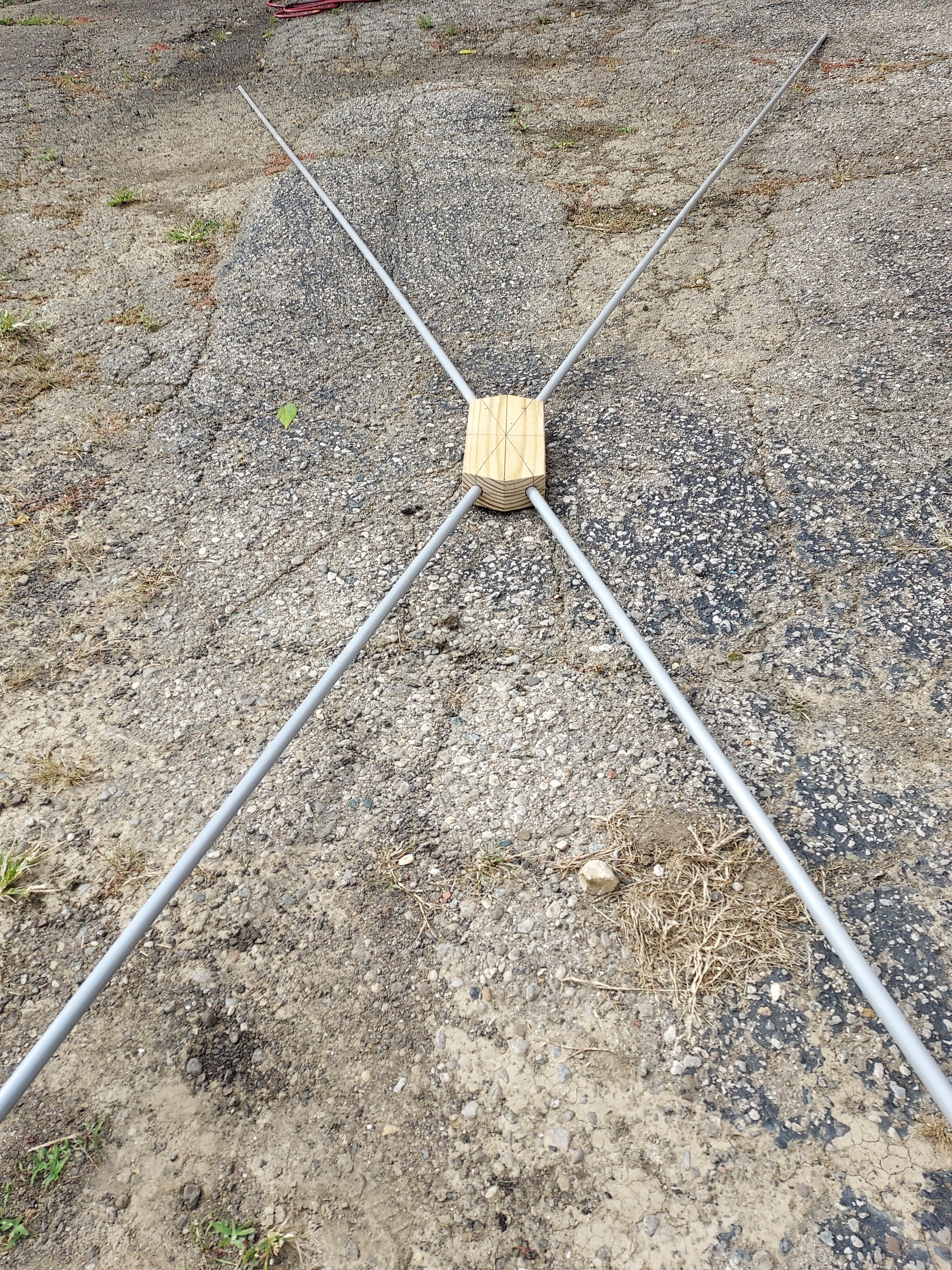

Here's the spreader hub designed and used by KG4JJH. Again, thanks to him for sharing.

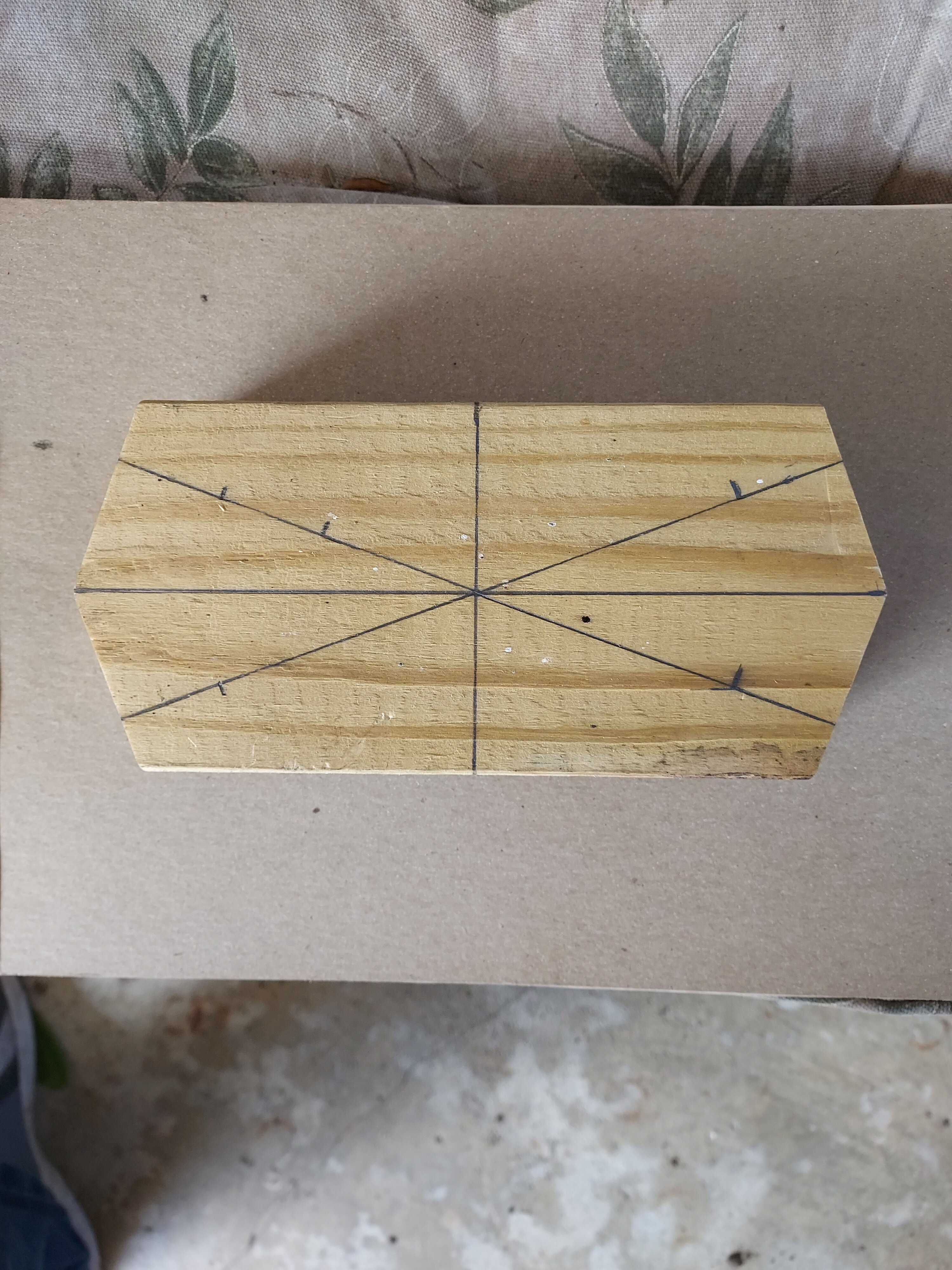

20221001_135935.jpg Took about 30 minutes to lay out, cut and drill this from a 7-1/2" piece of treated 2x4.
Then I test fitted the 1/2" OD fiberglass spreader tubes.

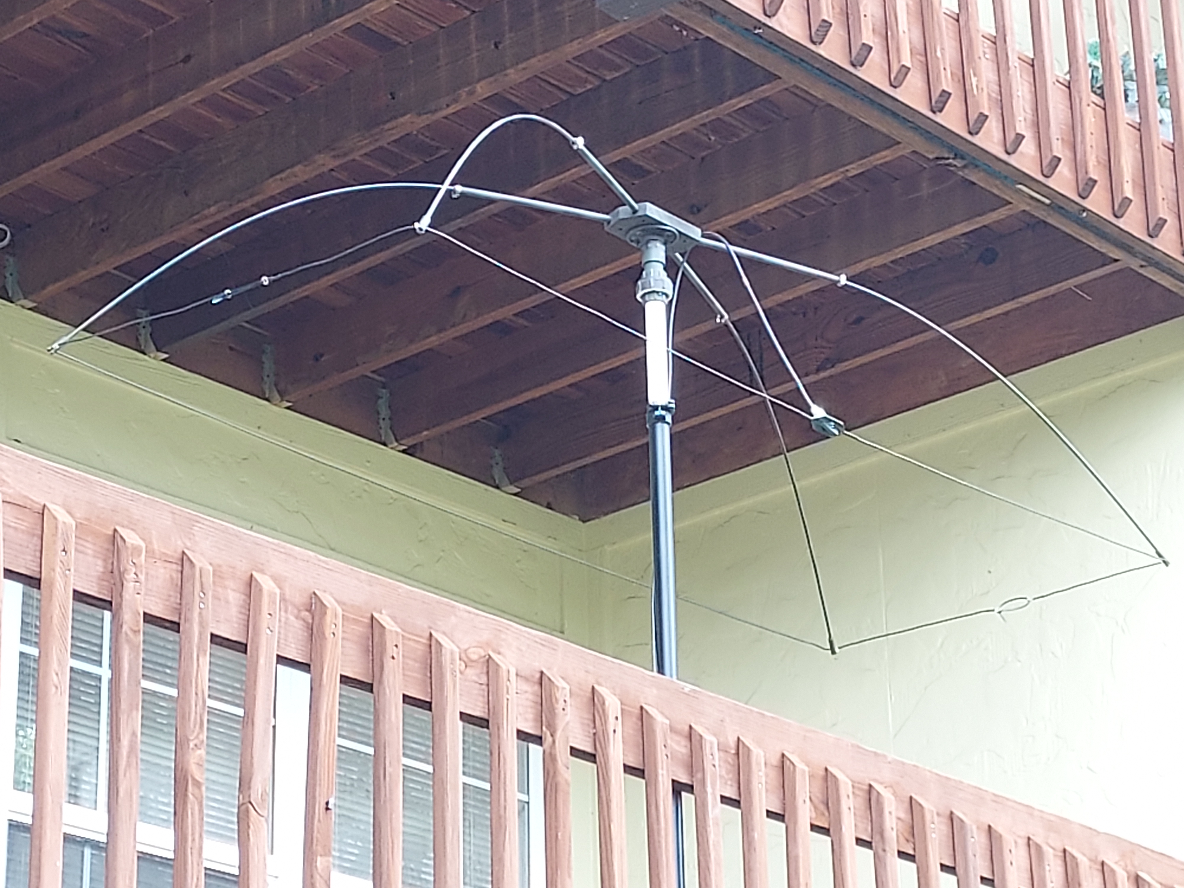

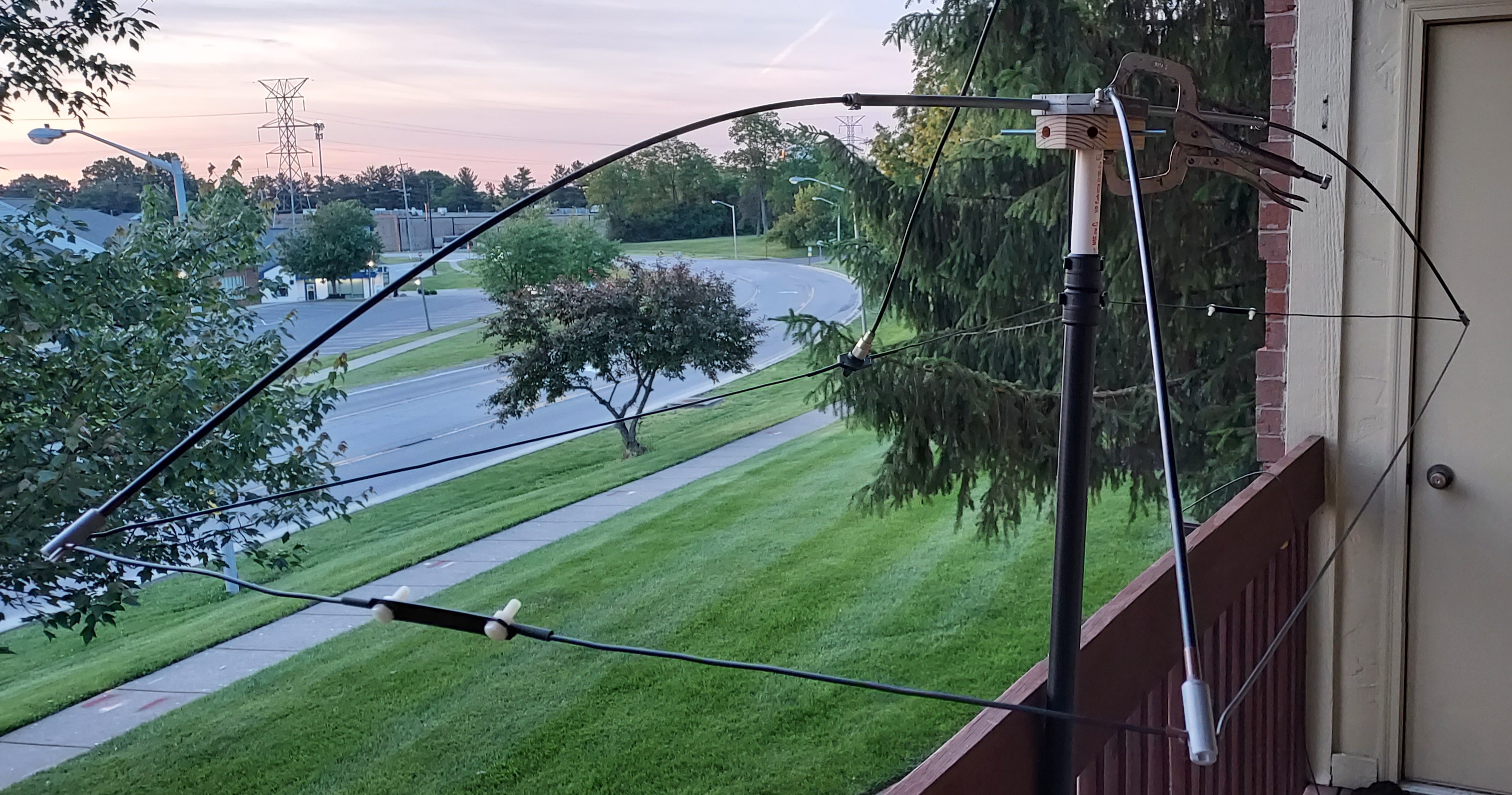

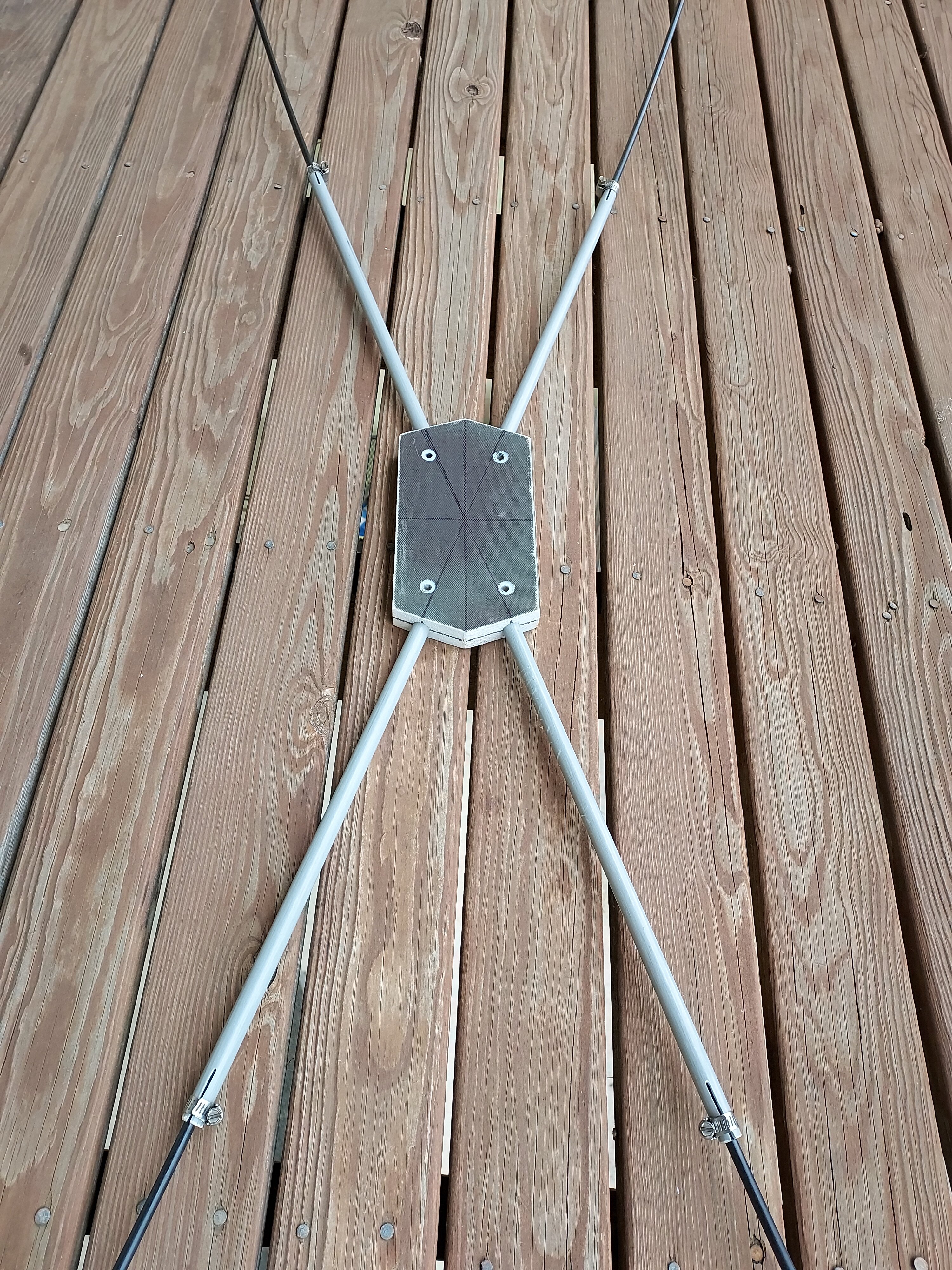

Ok, it's been 7 months since I started this thread, life happens, and my QTH hasn't changed. And the proposed 10m Moxon has morphed into an actual 6m Moxon. The basic design I chose hasn't changed however, just a few minor things. The principle is exactly the same.

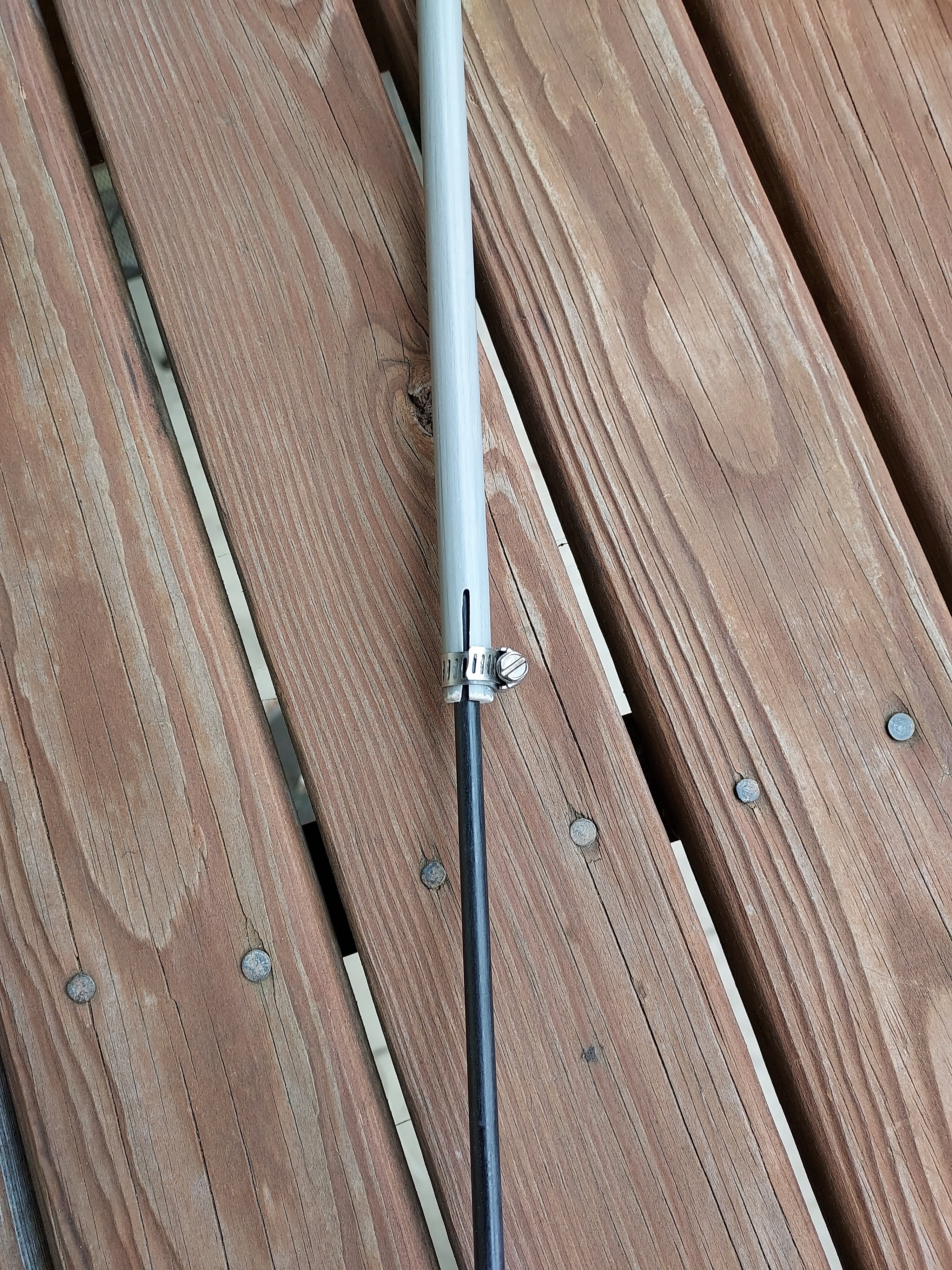

The hub is cut from a piece of 1" thick plastic cutting board. The spreaders are a 1/4" OD fiberglass tube slid inside a 1/2" OD.

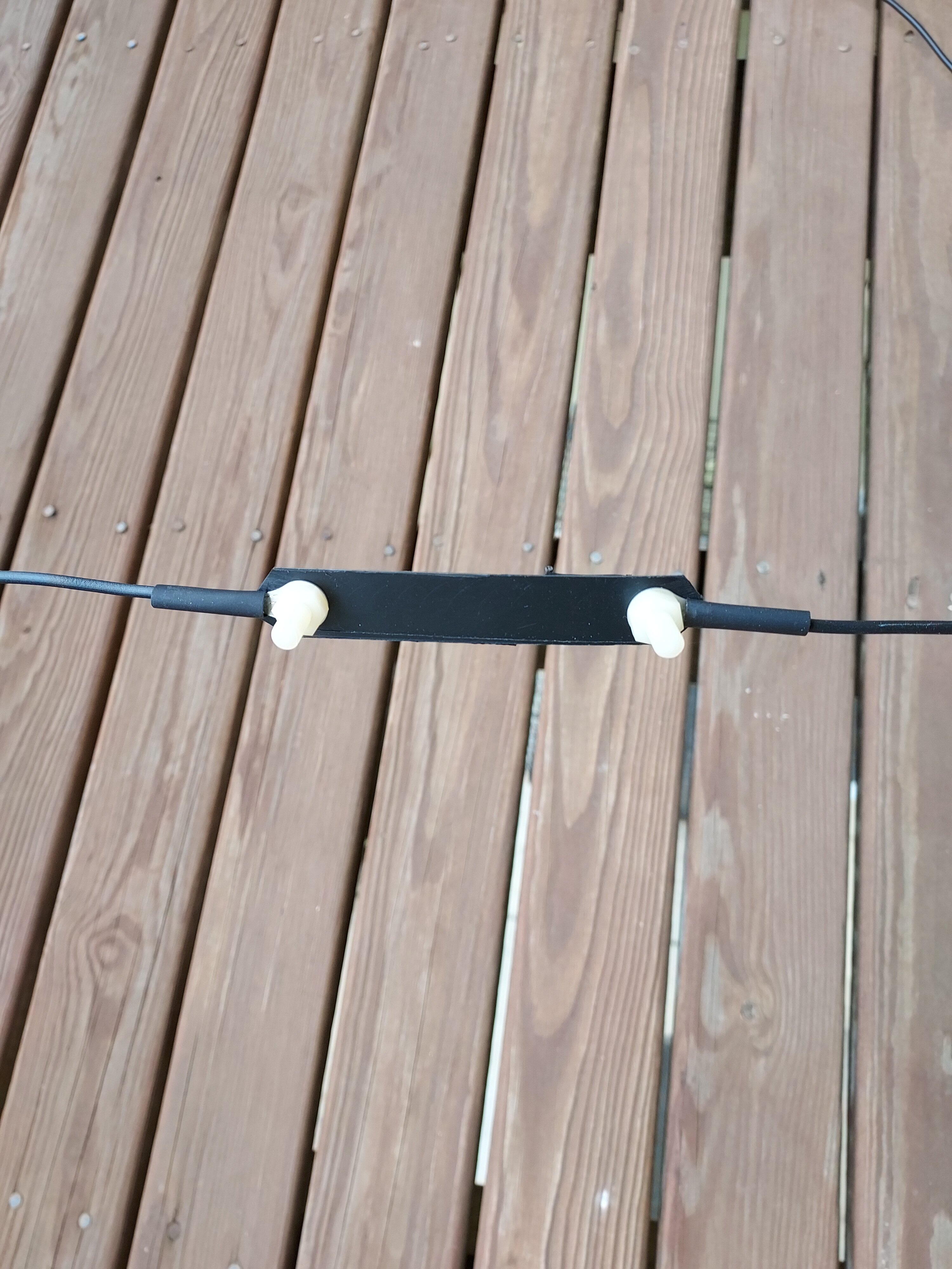

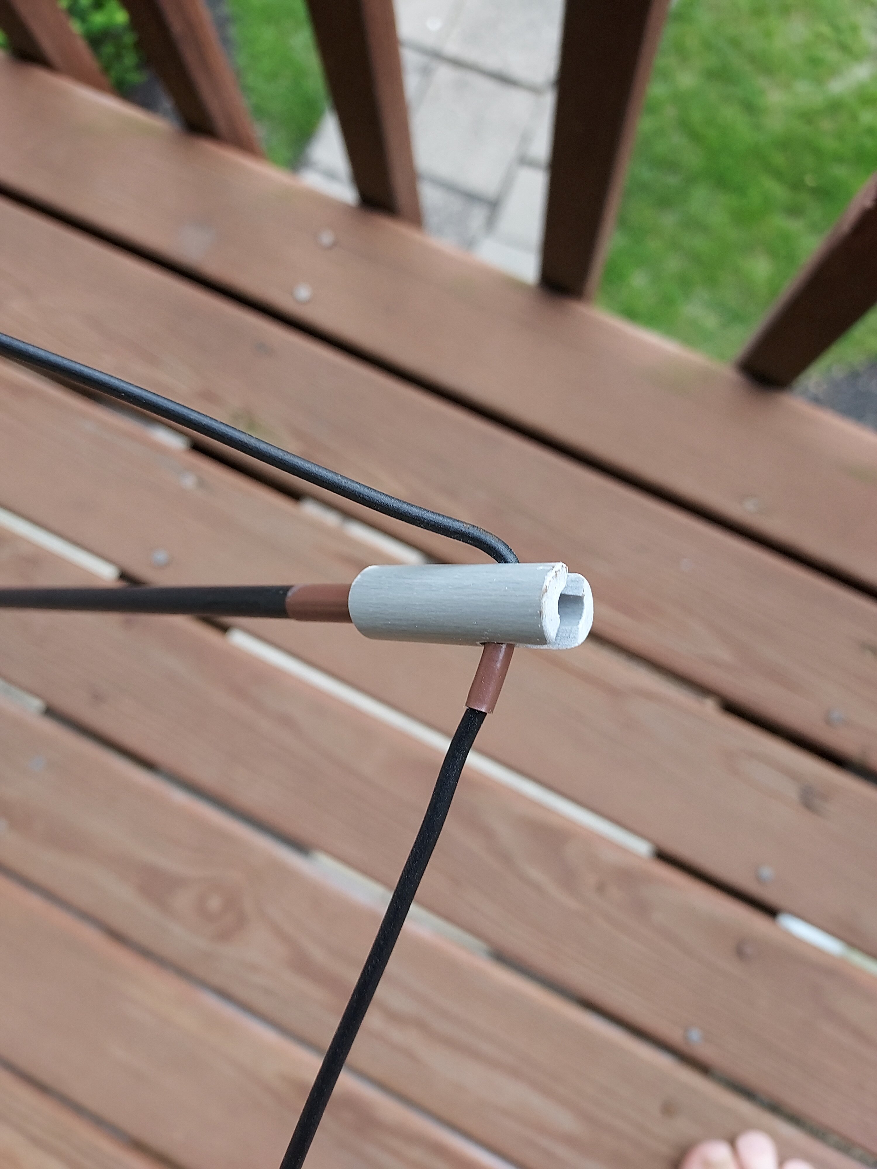

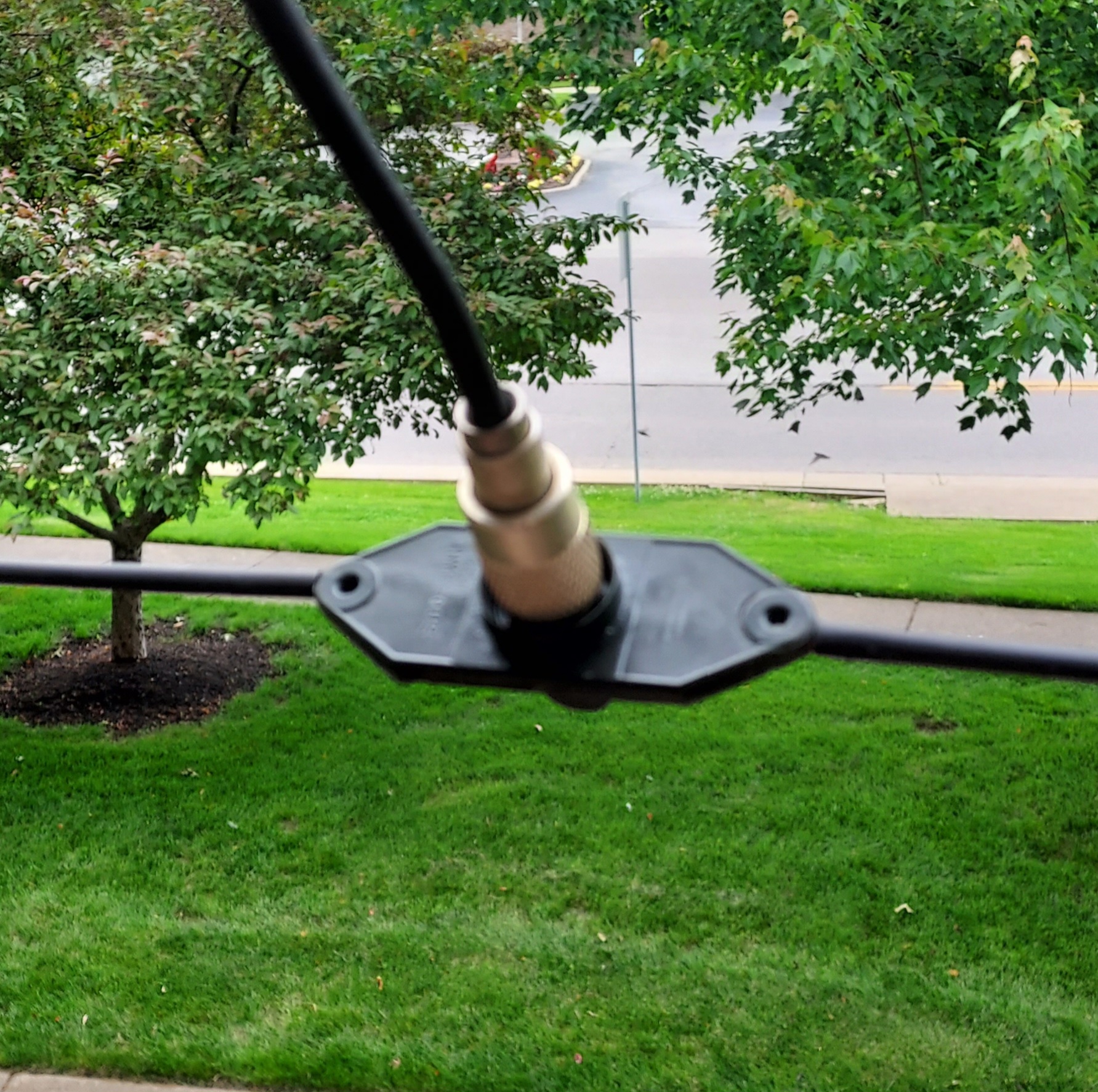

The element end spacers/insulators were chopped out of a small plastic washtub. A Budwig dipole feedpoint on the driven element.

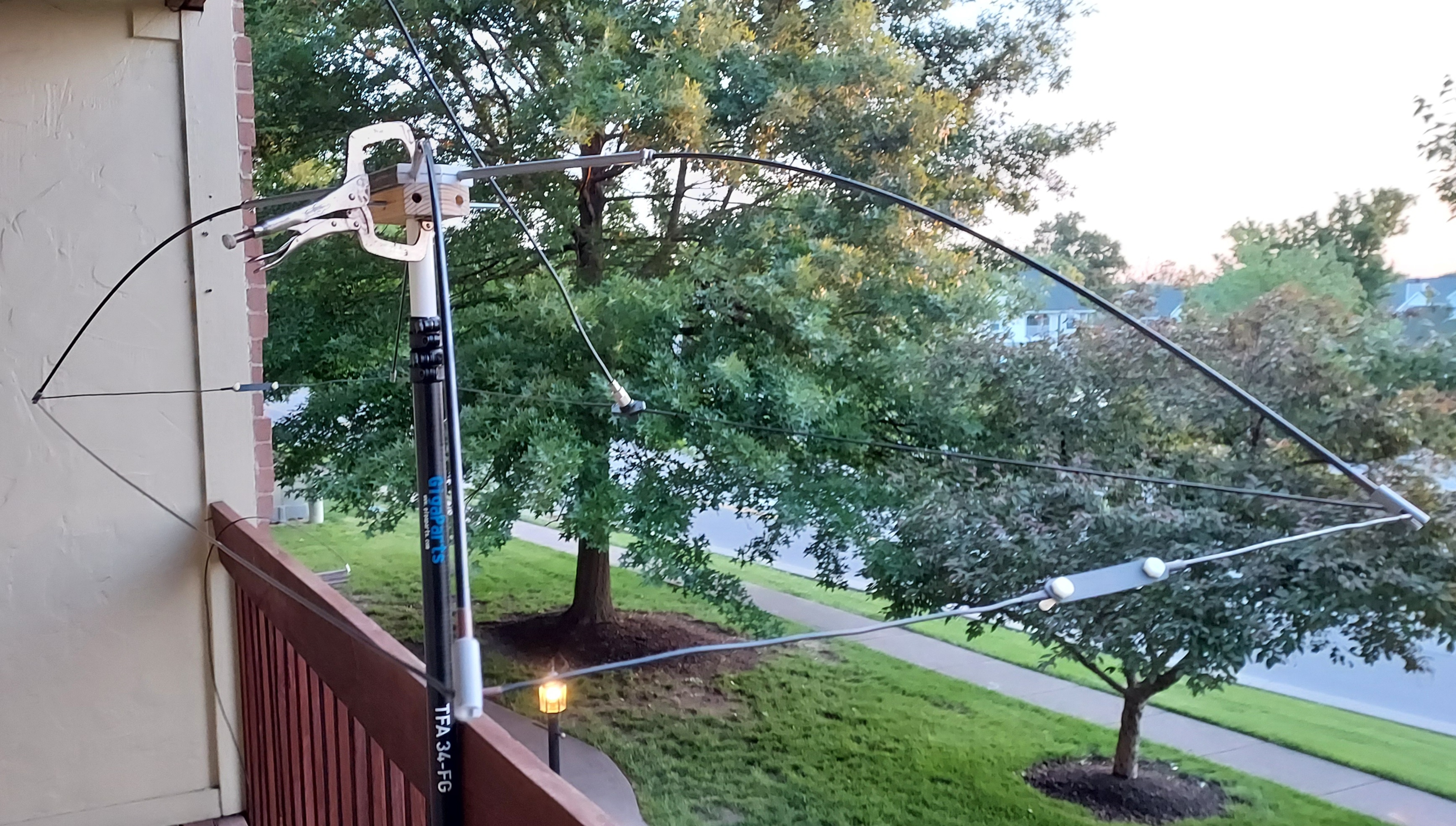

Just a temp mount today for some testing.
So far so good. Seems to work well, have made a few decent distance contacts on it. It's solid but very lightweight, would be simple to use portable on a push-up.

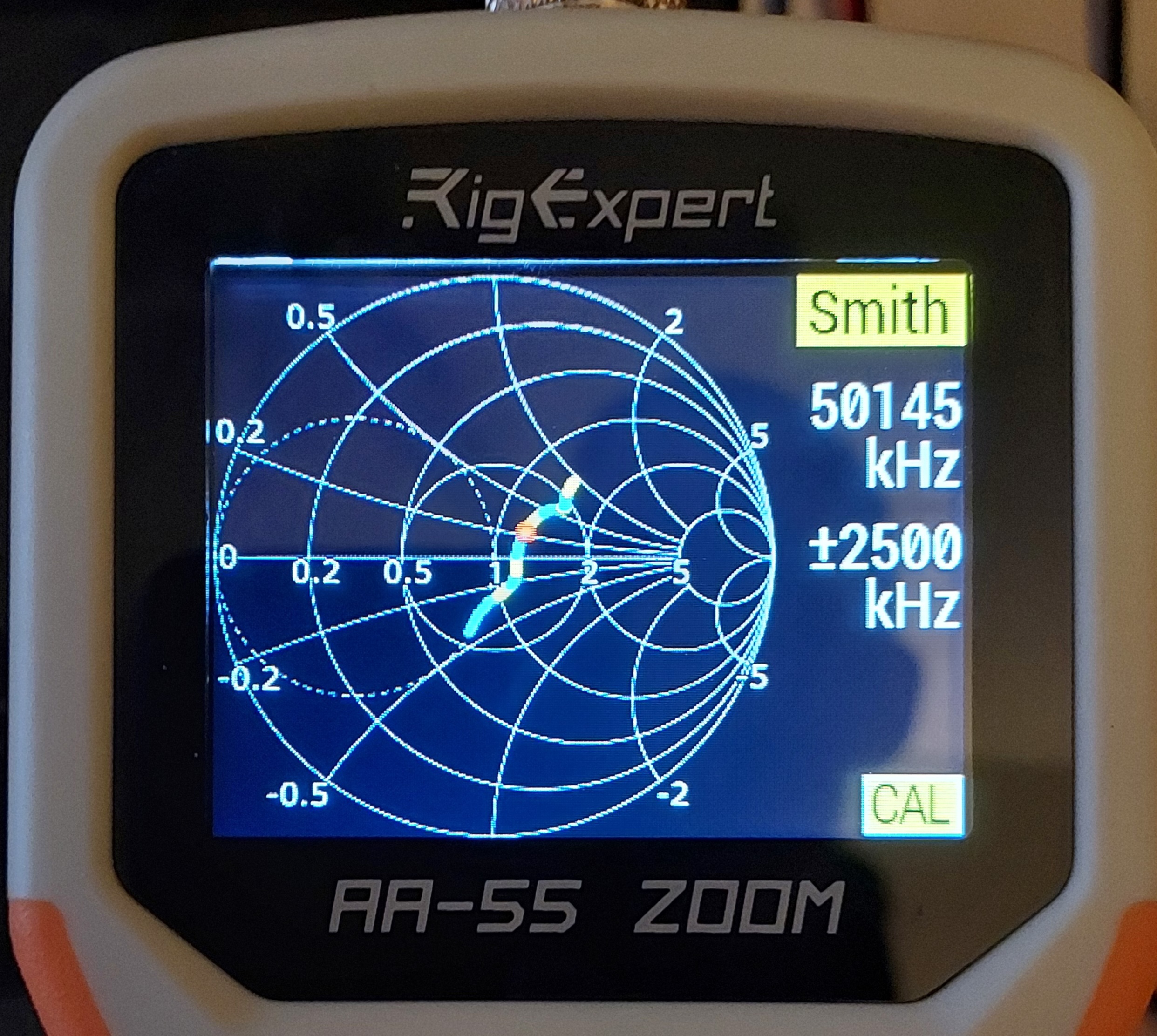

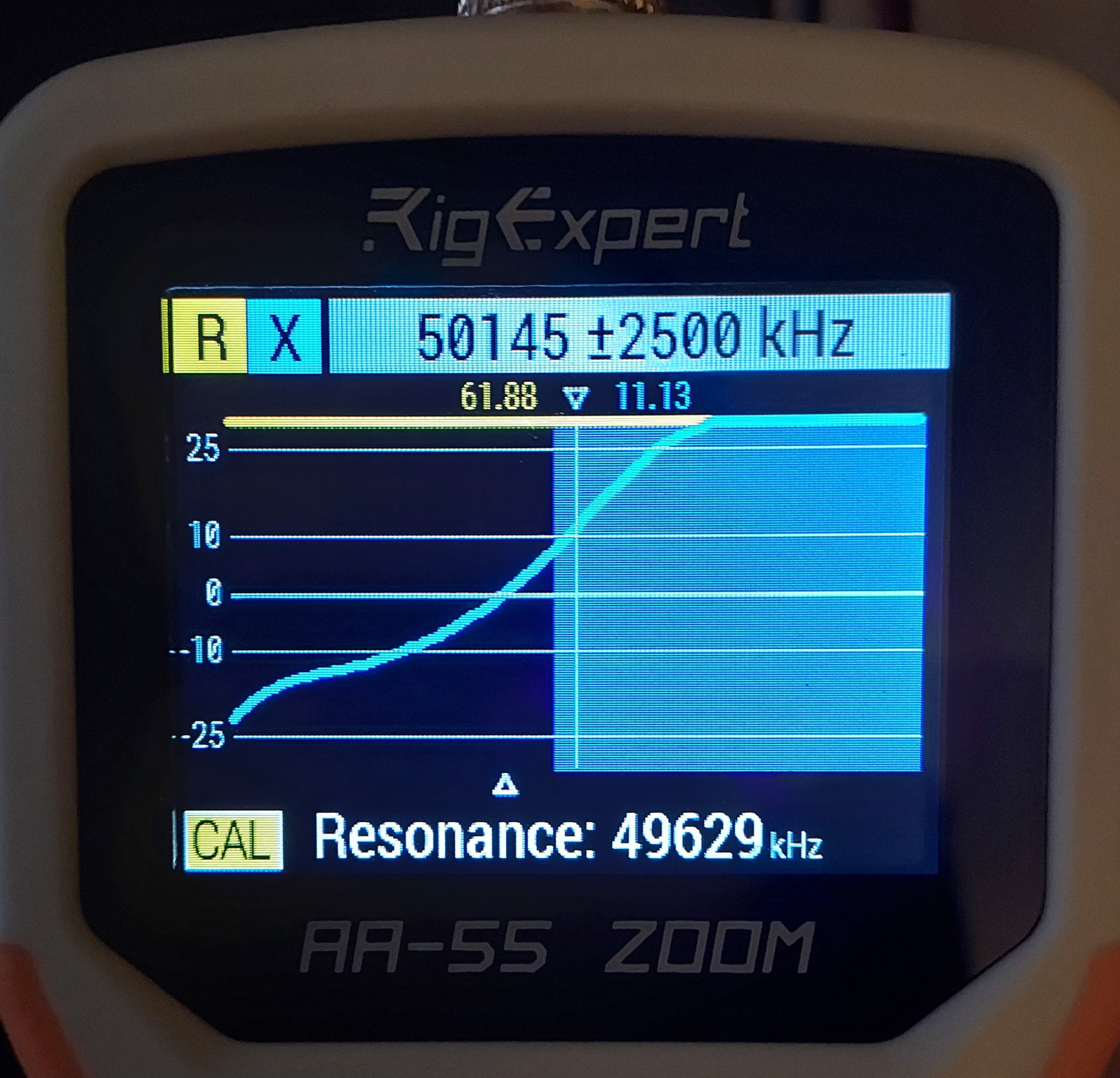

If anyone's interested here's the initial numbers on the 6m Moxon in its temporary mounting:
I plan on tuning closer to resonance once the antenna is in its final position and mount.

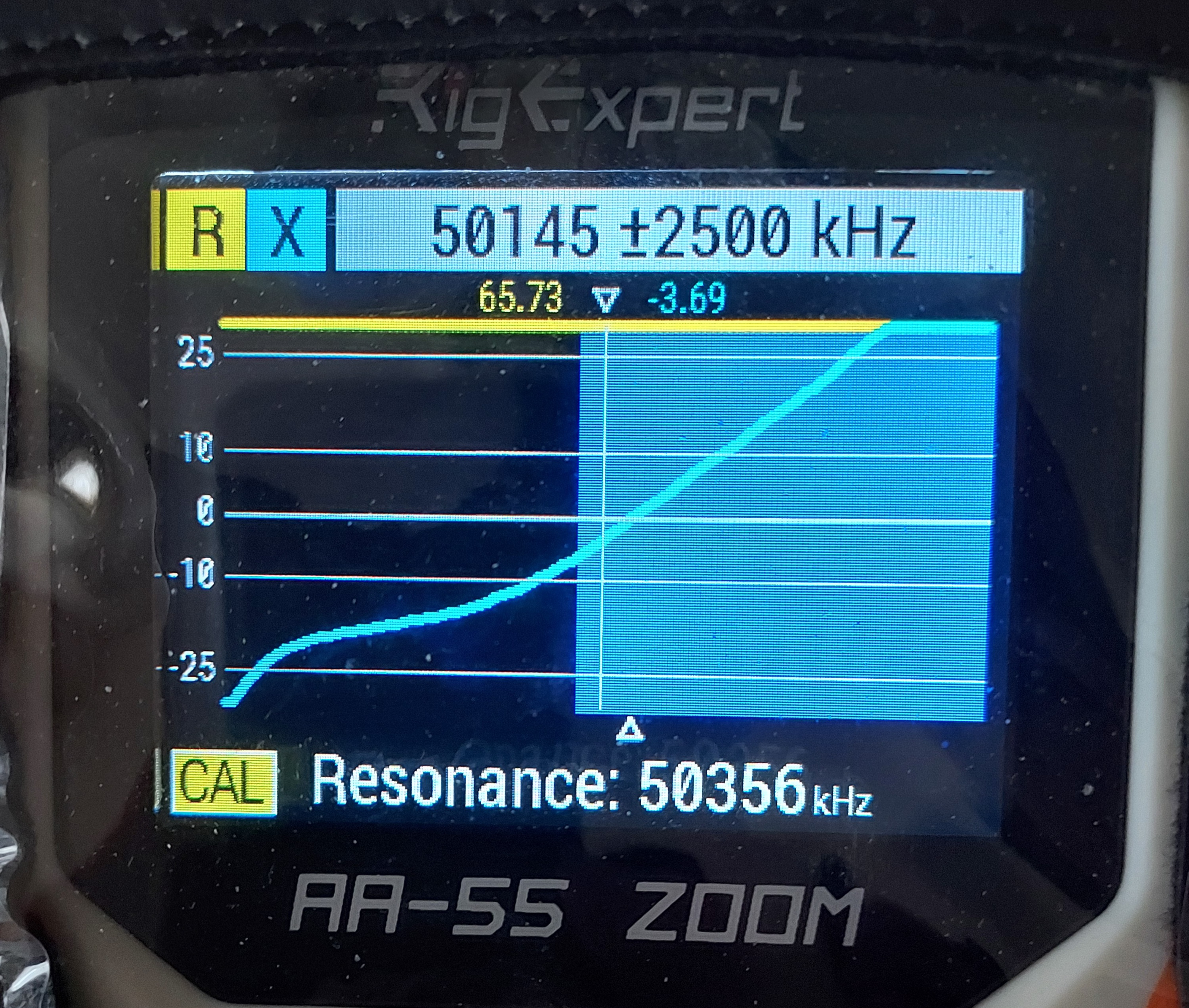

As I suspected MoxGen calculates long (good idea), so I entered 50.3 aiming for 50.125. It's still a bit long, but I think won't require excessive trimming. Of course YMMV.

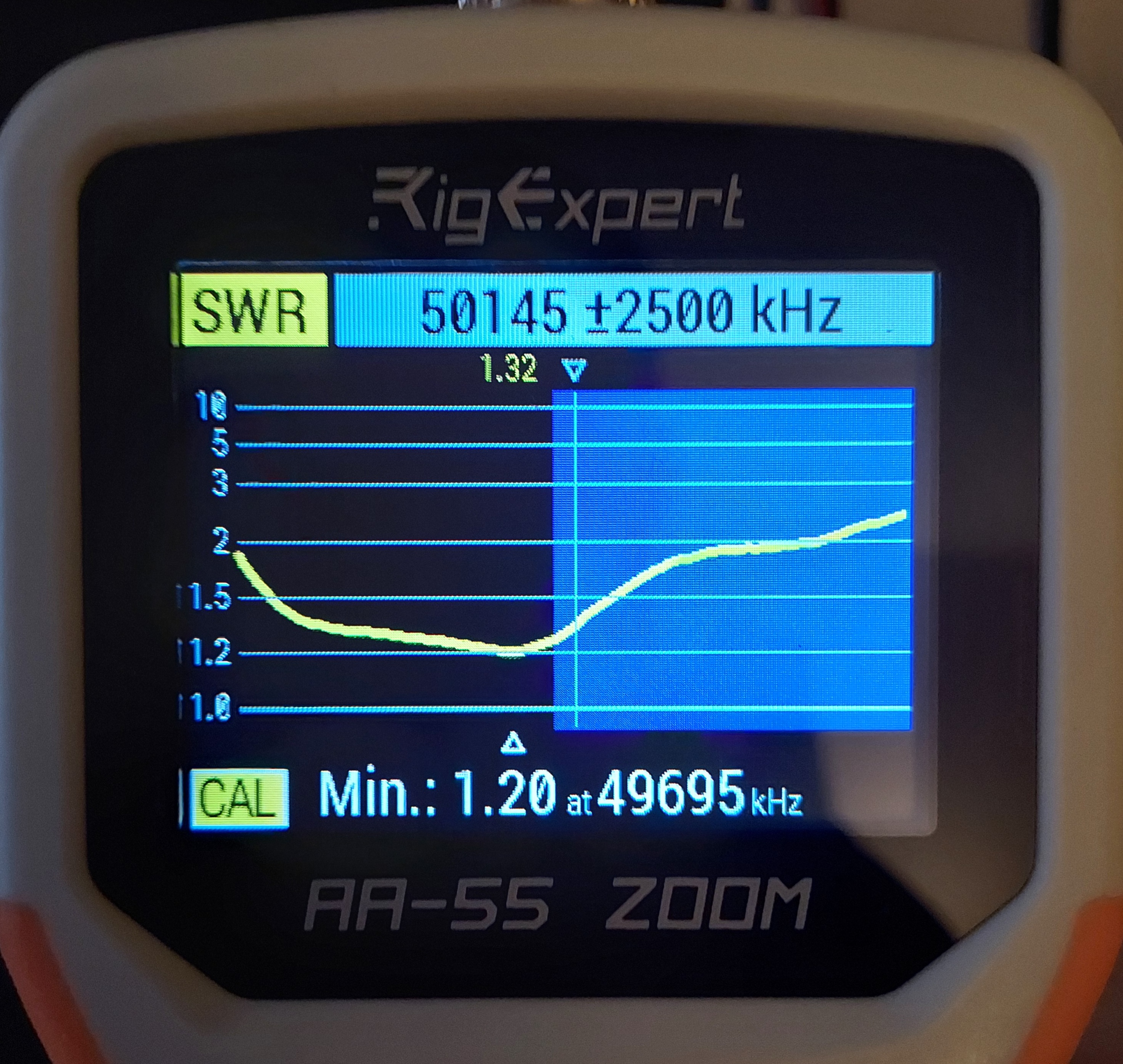

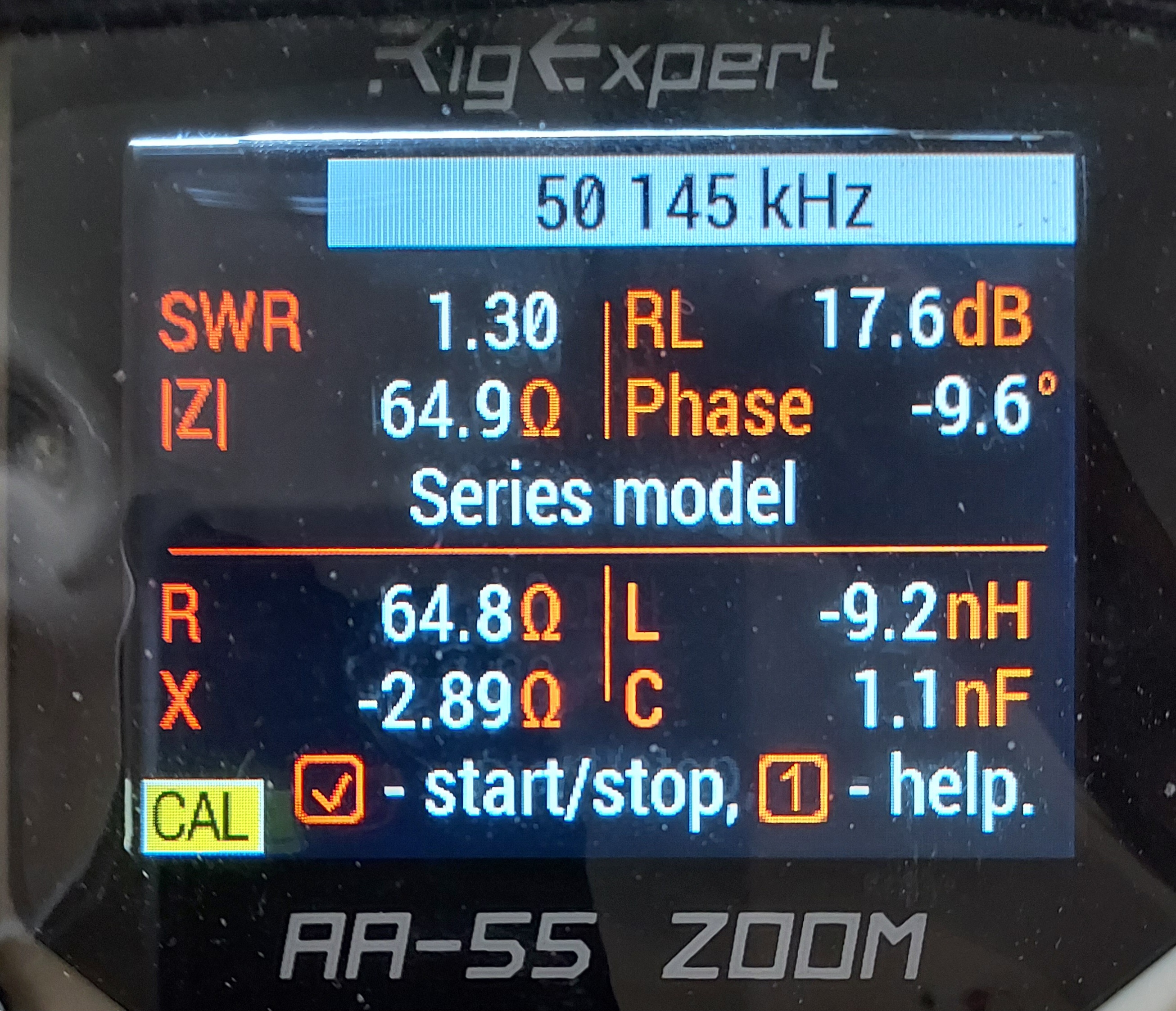

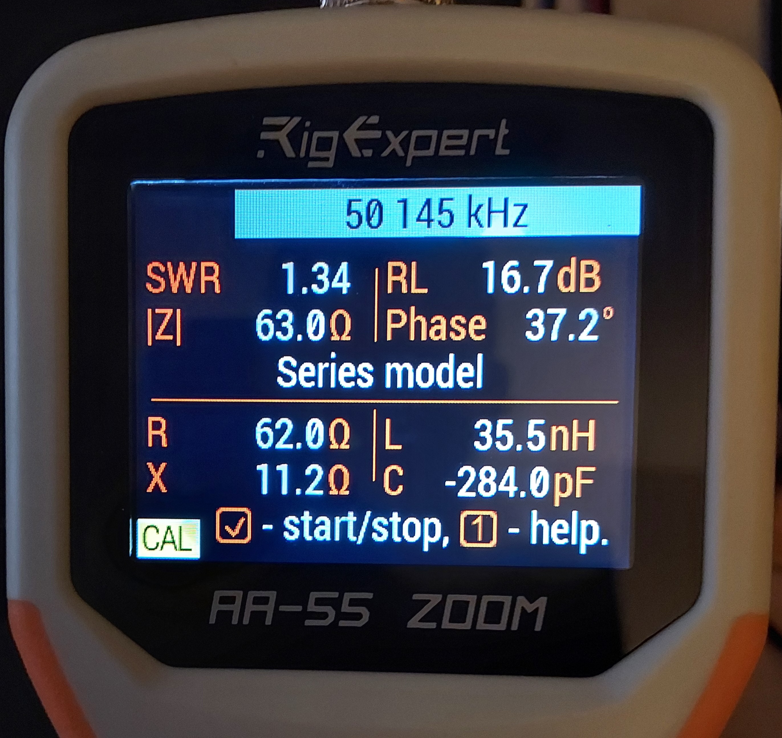

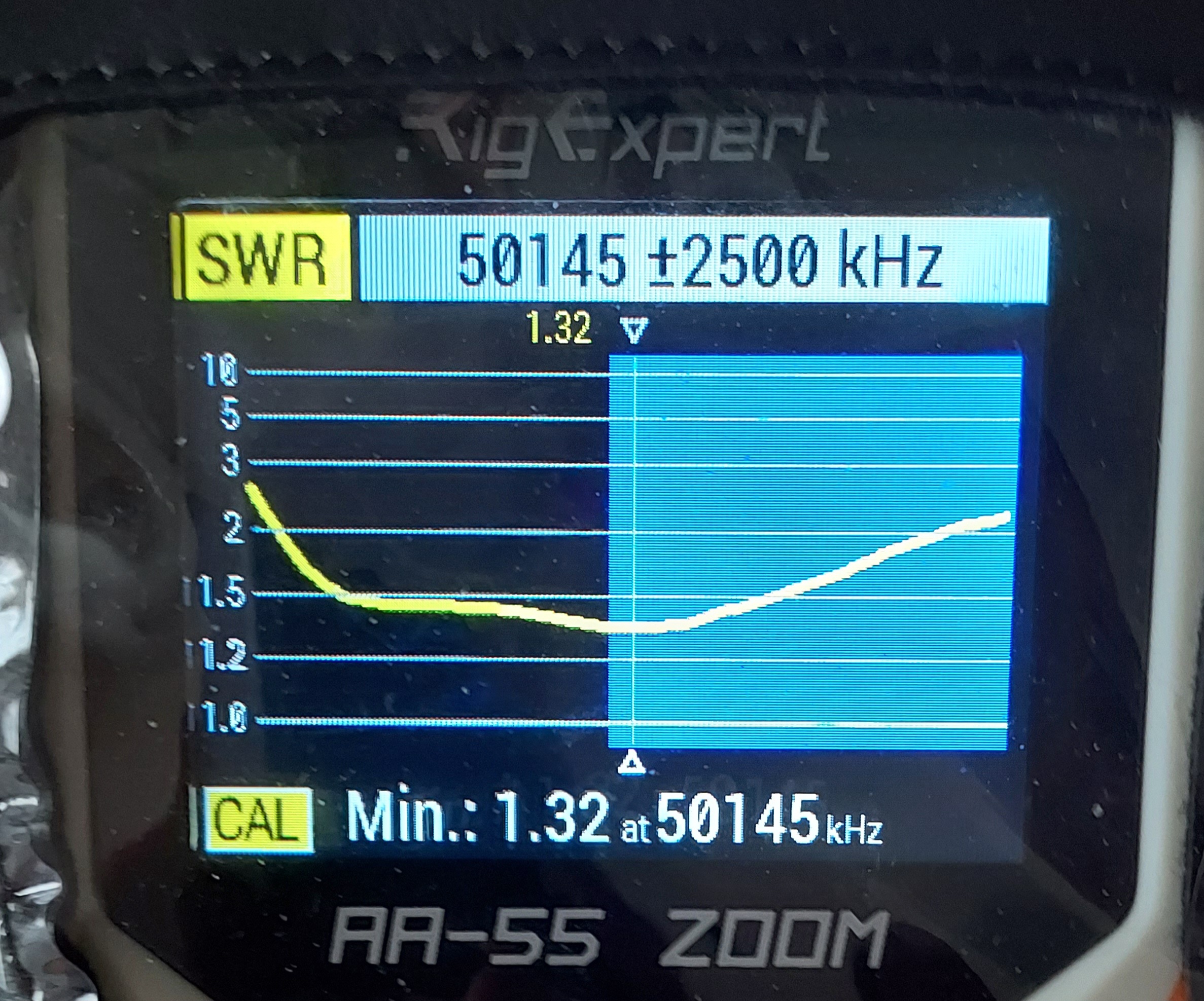

Here's the final analyzer run on the 6m Moxon after some trimming, tuning and re-postioning:
I was aiming for resonance near 50.145, looks like I may have trimmed once too often. But I can live with those numbers just fine.
It's working well for stateside contacts, several at 1k miles+. We'll see how it does for real DX if/when 6m really opens up.
