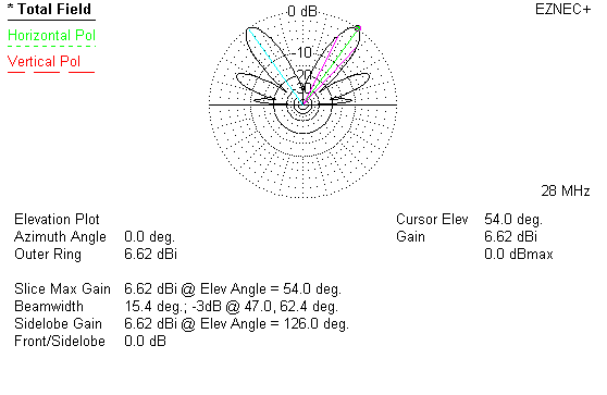

Most of the radiation is up in the sky at a high angle. The angle is so high, it is even useless for skywave.
This is a NEGATIVE gain antenna at low angles. A 1/4wl ground plane would seriously outperform the I-MAX 2000 or any other 1/2 or 5/8th wl antenna that does not have a large ground plane.
This pattern is over real earth, where a conventional dipole has about 8 to 8.5 dBi gain. This antenna about -2 dBd gain maximum. It has negative gain over a dipole. The gain over a dipole at most useful angles for DX is about -10 dB....significant negative gain."

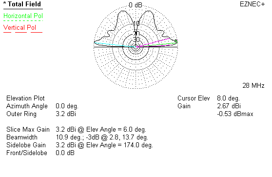

Even if we use the optimum feed line and mast length, here is the very best the end-fed vertical antenna will do is this pattern.
In this case we now have 2.67 dBi at 8 degrees elevation. This is actually an amount that is unnoticeably less than a perfect 1/4wl ground plane will produce! These severe common-mode mast and feed line currents make "no-radial" verticals extremely sensitive to mounting height, mounting structure, feed line length, and grounding. CB'ers for example often talk about grounding coax or changing coax length to match an antenna. If changes in mast length or feed line length or grounding affect the antenna pattern or SWR, it is an antenna design problem.
The gain over a dipole is now a few db at some really low angles, so it can be better than a dipole. At slightly higher angles for shorter skip, the dipole takes over and can be several dB better than the vertical.
This change is entirely the result of altering height and feed line/mast length!!! No antenna changes were made!"
