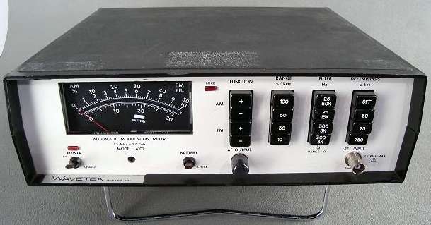

Forget using your meter to monitor your audio. Use a scope.
Agreed. The ONLY meter I will look at when checking modulation is this one. At nearly $1000 new it certainly is no Dosy and the quality and accuracy is no Dosy either. It does AM (and SSB) and FM from 1.5 Megahertz to 2.0 Gigahertz, 0-100% mod + and - as well as FM deviation from 10 KHz to 100 KHz full scale both + and - deviation as well. It also provides sampled audio out for monitoring.For general use I still use a scope.
