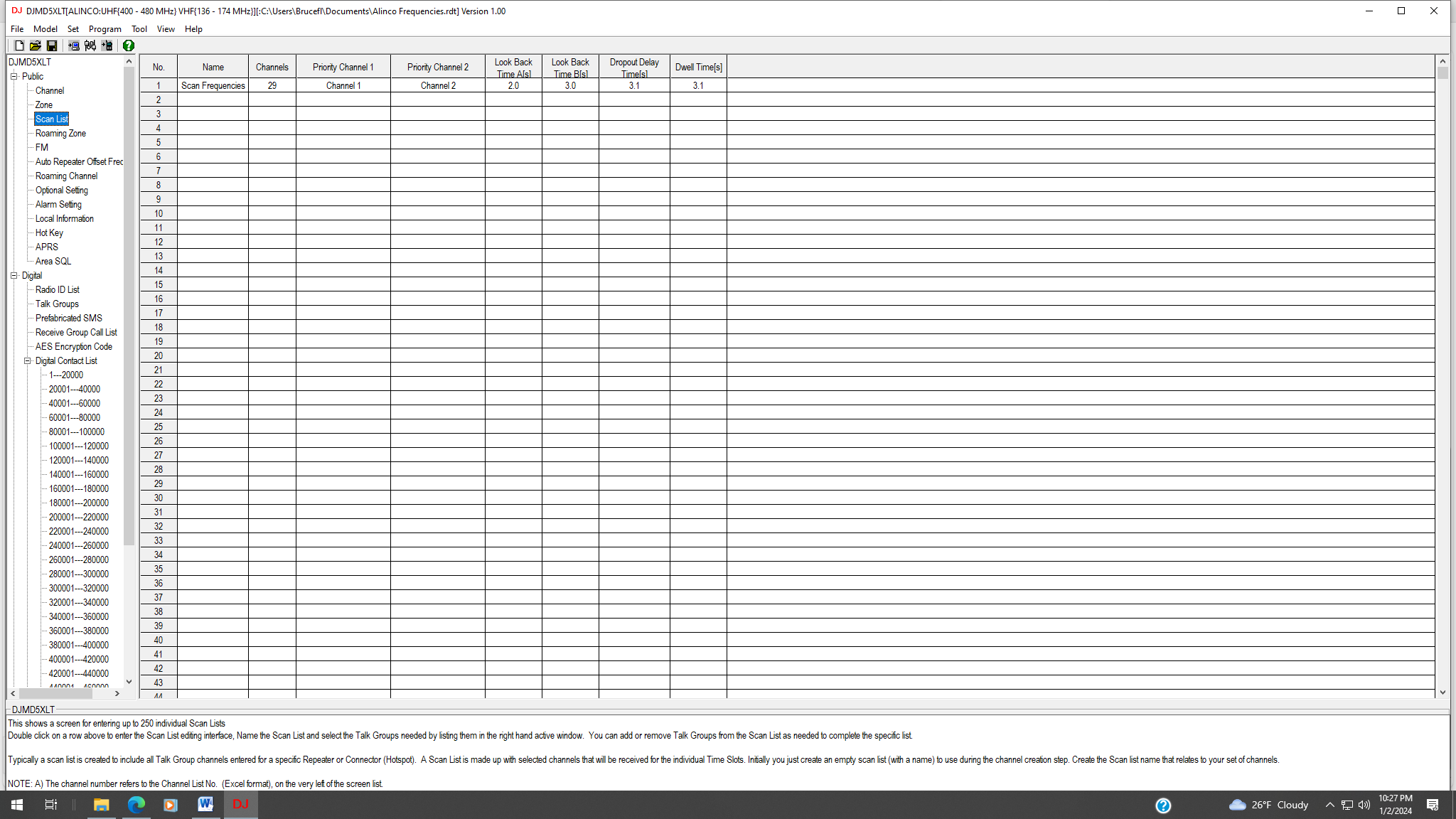

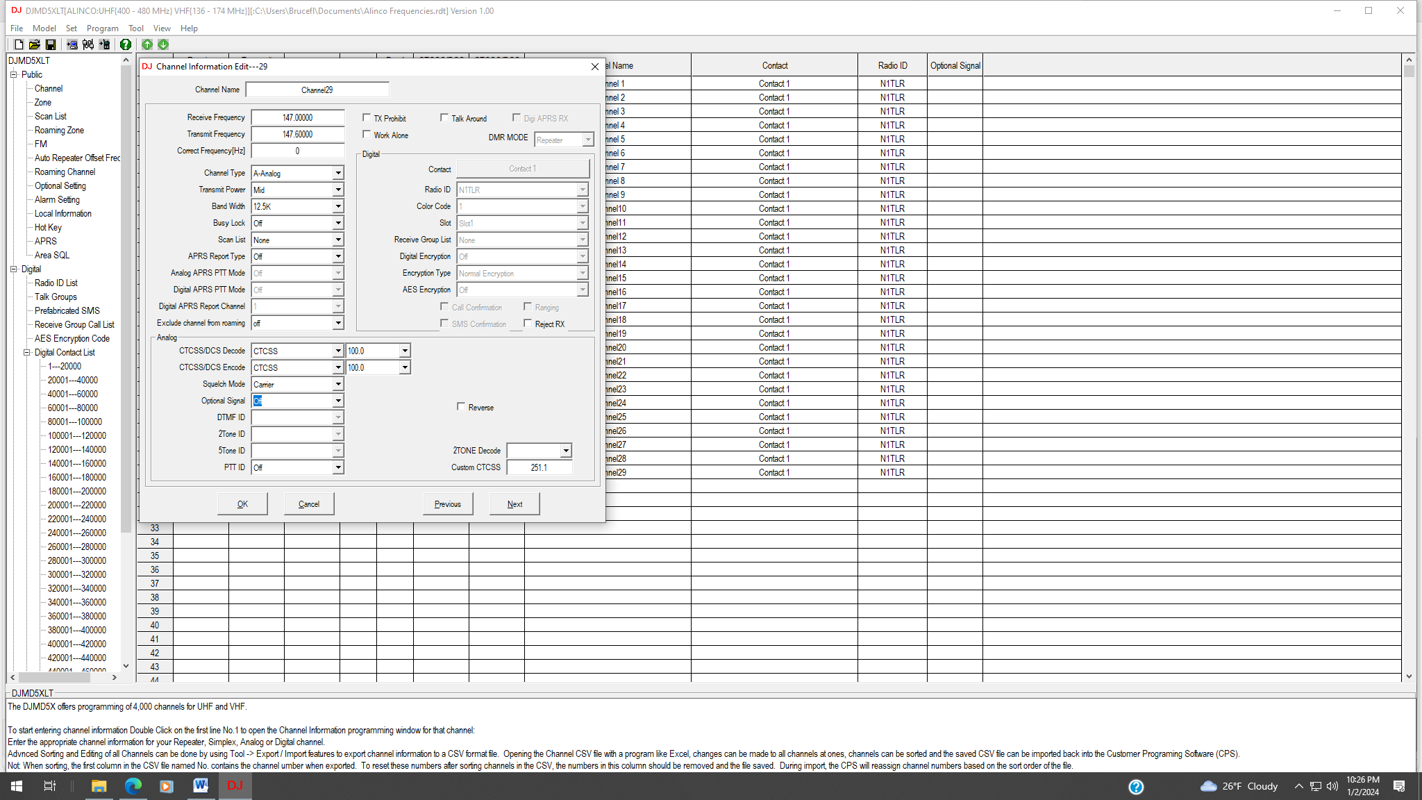

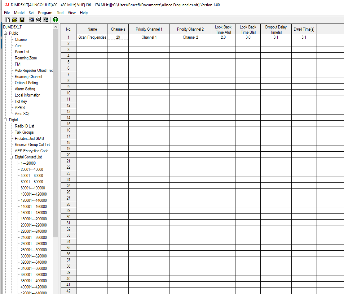

Hi, I am having quite a learning curve with the DJ-MD5 and would appreciate any help! I have programmed (I thought) 29 freq. some public service and some ham freqs. It loaded into the HT and it will not scan. I go to menu; scan click the on I get scan list No Select! I have attached a few pictures to show. Also on Ham frequencies, the TX is freezing. I hit the PTT and release, and it still shows it transmitting. Hopefully this comes out right. I may need additional help. 73's Bruce

It's hard to say from just those print screens, but it seems to me that you've got it right. Perhaps check to see if you have the latest firmware? Also the PTT hang-up doesn't sound good to me. That definitely sounds like a firmware issue. Have you tried contacting Alinco support?
