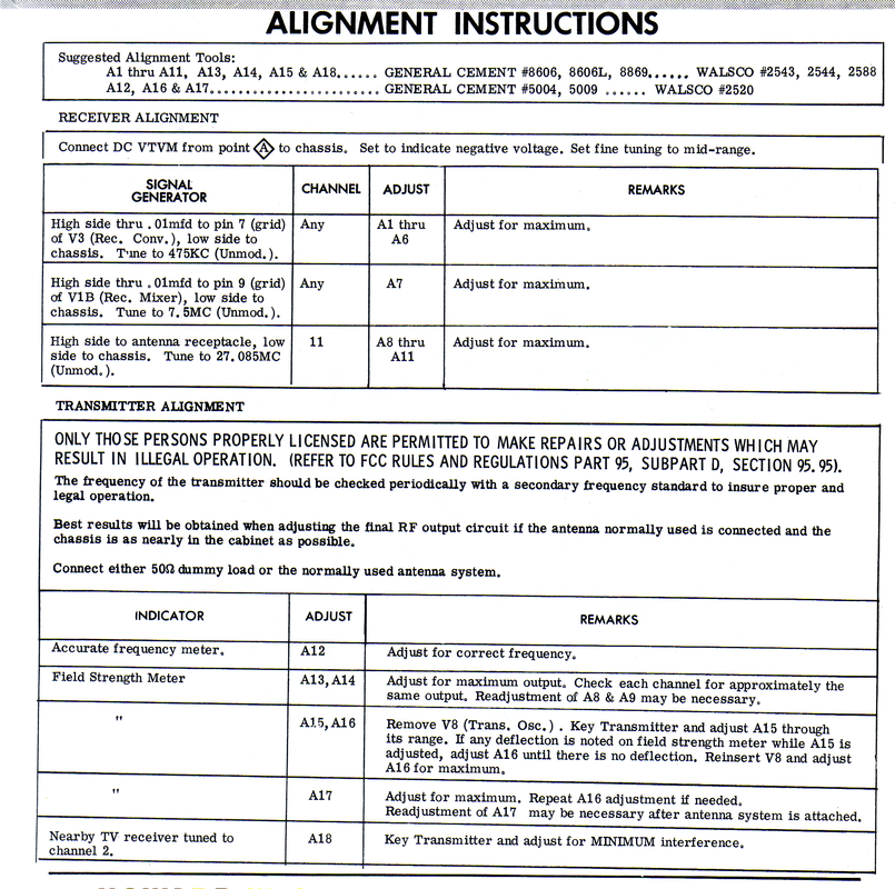

Hello,
I have a Cobra CAM 88 which is a simple 23 ch AM tube radio with equally simple alignment instructions. This alignment seem perfect for a first time attempt. There are really only a few steps each for the RX and the TX on this radio. I just recaped it after not using it for nearly 30 years and it appears to be RX & TX as it did when I last used it in the early 90s. I hope I have the necessary equipment to do at least a moderate alignment, but need some advice/assistance on how. The second half (for the TX) seem pretty strait forward, but the Receive alignment is what I am not sure about. For RX, it looks like I'm just injecting signal at a pin of a tube, then another tube, then the antenna jack and making my adjustments along the way. But what signal?
I have a B&K 2040 Cb Signal Generator. I read that the 475KC first called for here isn't really a standard used on most CBs, and the only way I see to change the frequency is the regular 40 channel dial on the generator. 27Mhz is far from 475KC. I am guessing this means I can't dial up 475KC with the B&K 2040 (or 7.5MC)?
I also have a frequ. counter, scope (though I'm not fluent using it), Bird watt meter, dummy load, B&K 1040 Service Master. Admittedly, I don't have any experience with the BK CB servicemaster/Sig Gen., but I do have a fair amount of basic electronics knowledge and I am great with direction. Any guidance on doing this?
Unless it specifies, and I may be wrong, I would assume you would inject the frequency identical to the channel you tune the receiver on. I would probably choose channel 12. So, unless I am wrong, I would inject 27.105.
Reactions: Handy Andy
If the B&K can only generate the actual CB channel frequencies then you will need another generator capable of generating the other frequencies needed. You could just inject the signal in the antenna jack as stated in the third step and adjust A1 thru A11 for maximum keeping the output voltage of the generator to a minimum, usually under 1 micro volt. You may have to start out with a higher voltage at first to get a reading and as you adjust and the signal comes up, turn down the voltage. Some times instructions will have certain sections adjusted to certain frequencies just to get them back in alignment if they are way out and then will have them all adjusted over again at the last step while the channel frequency is being injected into the antenna like in the third step.
