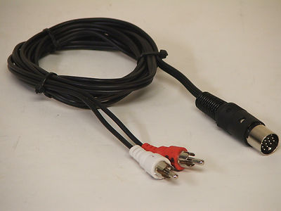

I suggest getting the amp control cable which has the ALC cable. This assembly has two cables running from radio control point.
#1 RCA Jack marked relay
#2 ALC (also RCA jack)
The ALC helps control any over drive.
(The IC-7300 is notorious for ALC overshoot) (as many radios are)
This is a way to help control that issue

Icom IC-7300 Amp Relay Cable With ALC & Relay Buffer

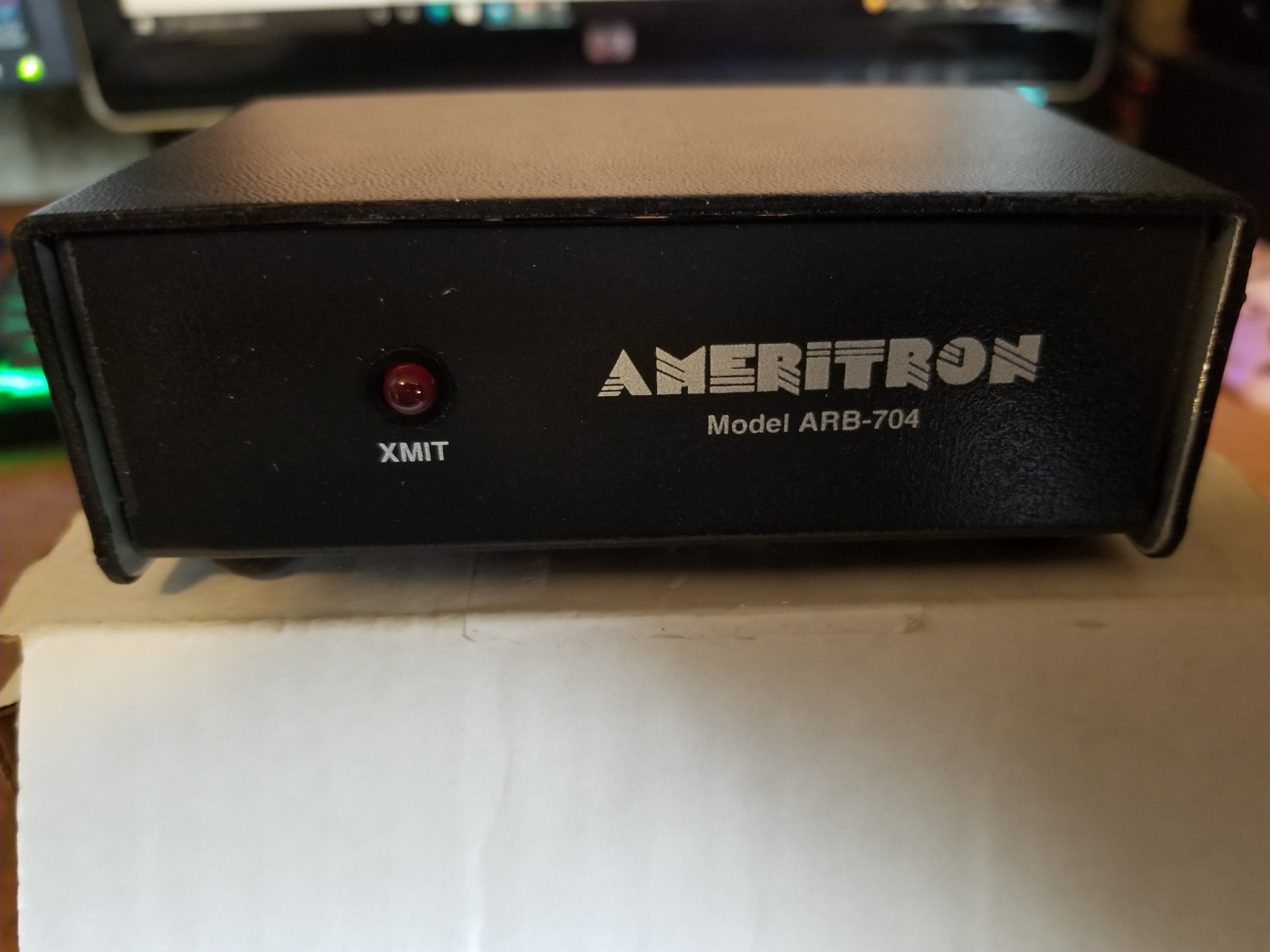

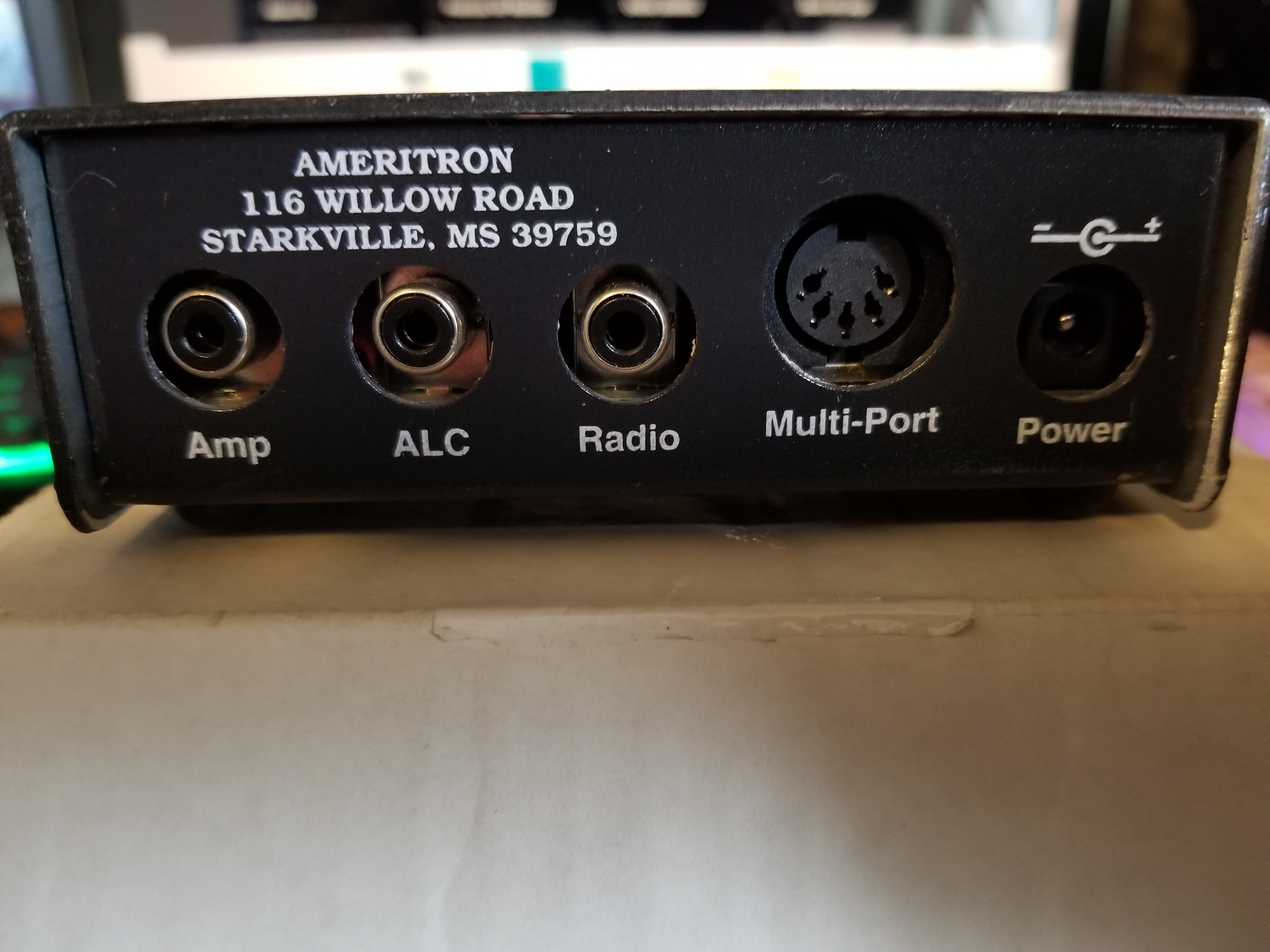

In the string up above I mentioned that I had Ameritron ARB704(12) for Icom. I think you stated that it didn't need a buffer but from what I understand in this reply is I should have the buffer and ALC control because of the 7300. If I am correct the ARB704 will do exactly what your suggesting I buy from Ebay. It has an Icom control cable to run from accessory on the 7300 and cable to run from the alc on the 7300 direct to the 704. Then the 704 has an amp out and alc out to run direct to the 811. Is this ARB 704 going to achieve what your suggesting? I just want to make sure I'm not missing something. Thank you.

Richard: Sorry did not return answer sooner. I had to look at specs for that unit. (Never used one that I remember)
Only had my IC-7300 for like 3 weeks sold it.
MFJ, says as long as the correct cables are used it should work.
Thus, that DIN Plug connection to the IC-7300 ...then to DIN connection on control interface...then 2/RCA to RCA cables (simple audio style) for the relay and ALC should be done deal.
The ALC feedback voltage must just be a feed-thru coming out of the control interface (no isolation).
Thus, the control knob on back of amp should work to control drive.
