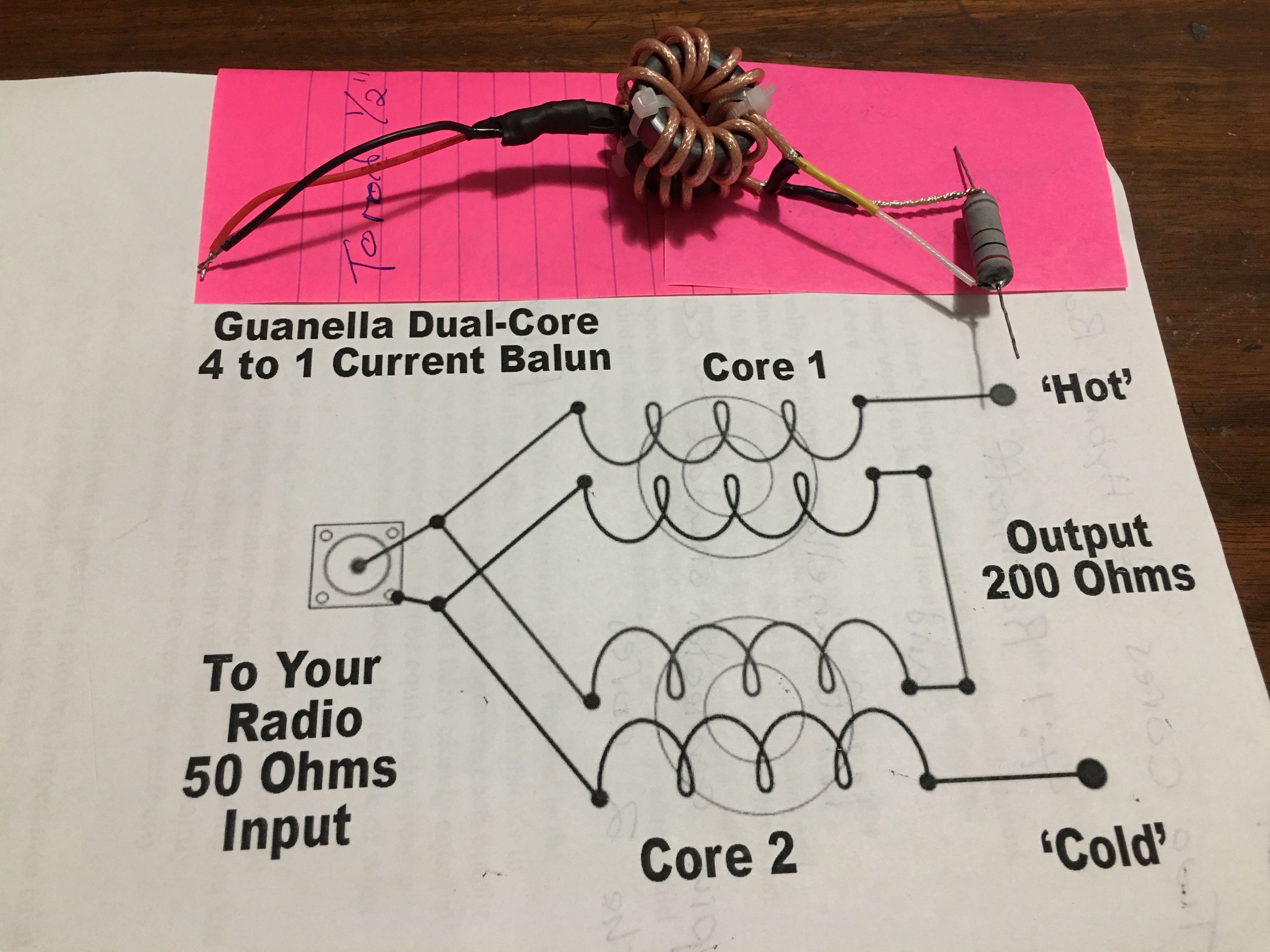

Amp working good on bench without an ATU. Been rewinding inductors like an Elf. New band switch, 6 inductor settings. Need antenna work before qro. Preparing to revise the EFHW. Currently, it's a 2 core (240 size) 49:1 unun feeding approx 27' counterpoise horizontal in-line with 70' main wire). Original plan was add another core and Receive preamp board which required a new enclosure & another relay with another pair power wire. While I'm up there- temp install a Guanella 4:1 balun (two 140 cores w/ RG316) experiment to see if an OCF is better use of the same wire.
EDIT: SWR Analyzer shows good. A day on the roof soon.
