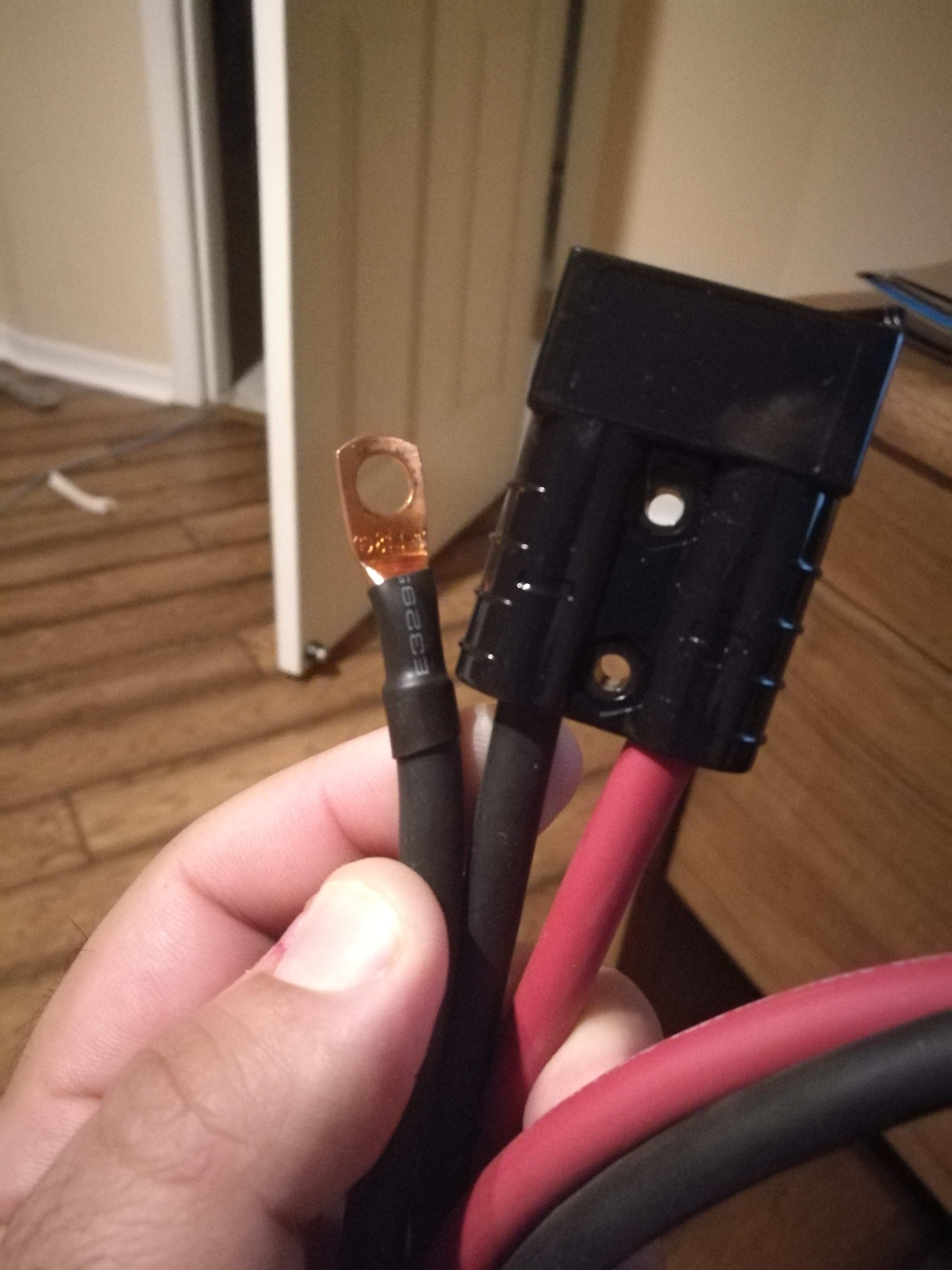

Hello Dear Fourstringburn, I hope you are having a great evening, cheers for that information. I think I will use the 8 AWG welding cable I have left over for the DX500V cord upgrade. I already made a nice ( to me ) quick disconnect for the 2970N4.
So would like advice on how to remove the existing chinsy 10 AWG on the DX500V and perhaps also bypass the dual glass fuses . Ill buy some sb50 black andersons. I think this is the one I used for the 2970N4 which it also came with. My concern is how much wattage is required to solder 8awg to the board on the amp? Im thinking 80W weller with chisel tip should be fine? I just dont want too much heat to damage pcb.

Heres the one I made for the RCI.

Your RCI connector looks great. That's what I would do with your Texas star. Leave the pigtail and use the power poles on this amp. Those glass bubble fuses actually use the better glass fuse types, use them. I'm sure someone will argue my next statement which seems to be the norm, Your fuses should be at the end of the power cable near the power source. They don't really protect your amp Per Se, they protect the line from excessive power surge which can overheat the wire insulation and cause a fire.

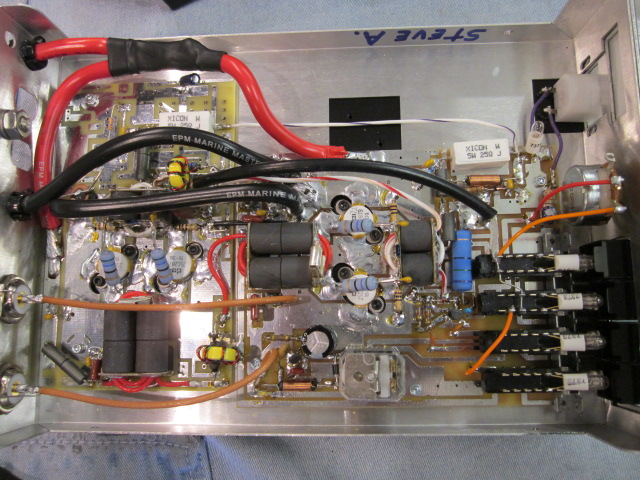

Here is my 8 gauge power wire upgrade with the fuse holders deleted. I used Marine grade fine strand cable ....... I also used a Craftsman 150 watt soldering gun ..... I have done about a dozen Texas Star 500's and about 6 Texas Star 350's this same way.... I then install a 75 amp Anderson Powerpole connector on the end.
I installed a MAXI FUSE holder in the positive power wire about 8 ~ 10 inches outside the chassis using a 60 amp MAXI FUSE in the TS 500, and a 30 ~ 40 amp in the 350's........
I like these Texas Star amplifiers. I have repaired several of them in the last couple of years. And I have communicated with Mike Hawkins, the Texas Star guru mechanic, and learned a lot from him.

Cheers. Did they ever mention why they used 10awg cord?
I currently extended the existing 10 gauge via soldering and heatshrink to 2 feet of regular stranded 8 awg.
I noticed you also upgraded the internal power cables also. My amp is currently set to pep at 400W tops . the current draw doesnt seem high either last i recall was about upper 20s to 30 amps at 13.9V.
