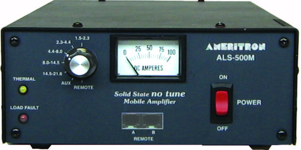

An Intresting Idea, what do you think about this mobile setup???
Basically I am. Im just using the heat sink, PCB's and transistors. Also there thermal on off for the fans.
But Im installing a keying circuit for use with HF transcievers and am thinking about auto band switching through the data in the radio, but more than likely, just a remote swicth to power onboard relays.

Are you saying they make a filter for in band IMD or that the ALS will have less IMD than the TS amp?
I meant that the Ameritron amp will have less IMD than the TS.
Also the TS will have MUCH more gain on the lower bands than the higher ones. The Ameritron amp will have a more even gain figure across the bands.
To keep the gain stable across all bands, I planned to pad either the input or output of the input filter network according to the drive required for that freq. That way 100 watts input will achieve full output on all bands regardless.
