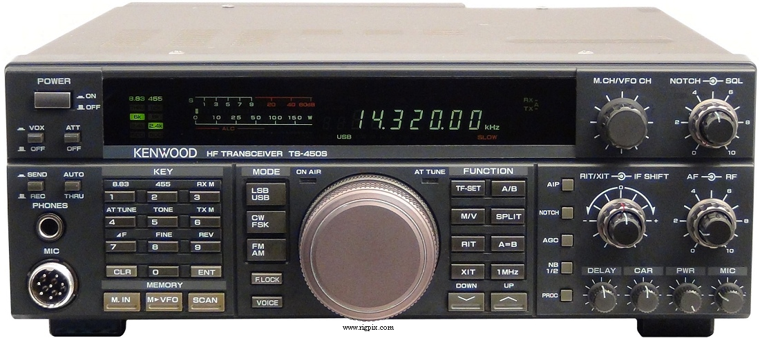

The Kenwood TS450S is a little nicer radio and are easily found in the used market for decent prices.
