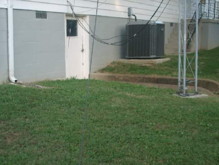

Ran across a 30 year old tower that is priced right imo. Comes with a beam, what I'm wondering is what to look for, is it worth refinishing and putting back up? Any pointers would be greatly appreciated!

Yes Cody: Looks like "25G" style.
OK...What are your plans on getting it down???
Look as if maybe a tilt base. That said that is a ton of weight...Tower/Rotor/Antenna(s)/feedline etc.
Looks like fair to good condition. Appears from pictures to have some rust, would expect that.
Cody, if it does not have any pins holes or splits then at least 40 ft or so would be worth the trouble.
Used Price on true ROHN 25G is $50 - $100 per section, that being said age wise that tower would be toward the low end.
New Tilt Base cost you about $250 for a GOOD ONE, with base plate/j-bolts for concrete/nuts/washers etc.
Yes Cody, I would say $150 very acceptable.
Well check it out, once it is down.
