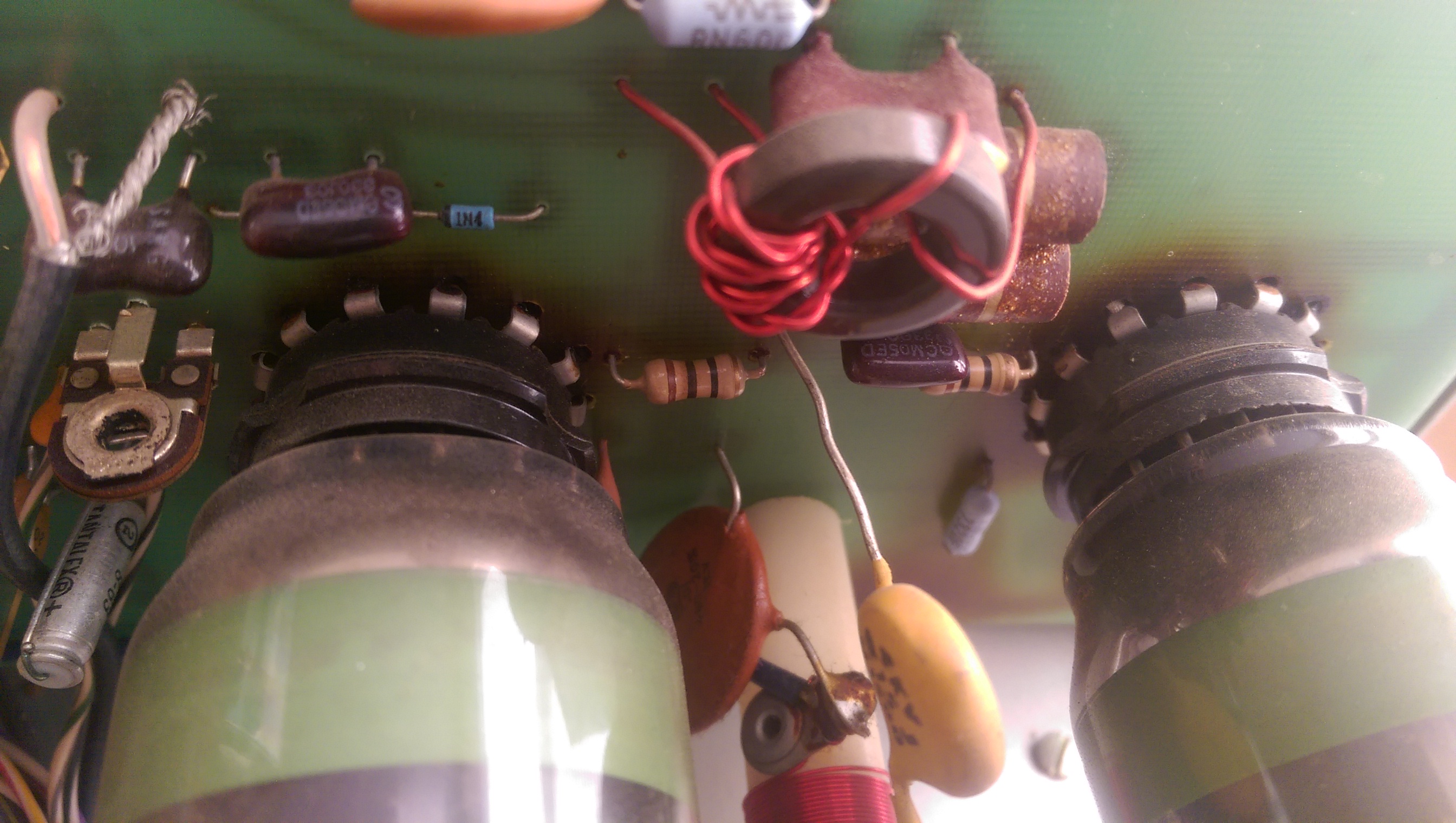

The amp in question has burn marks under the tube sockets and doesn't turn on, I will have to figure out how to fix that, maybe rewire the board? This will be a project in the near future.

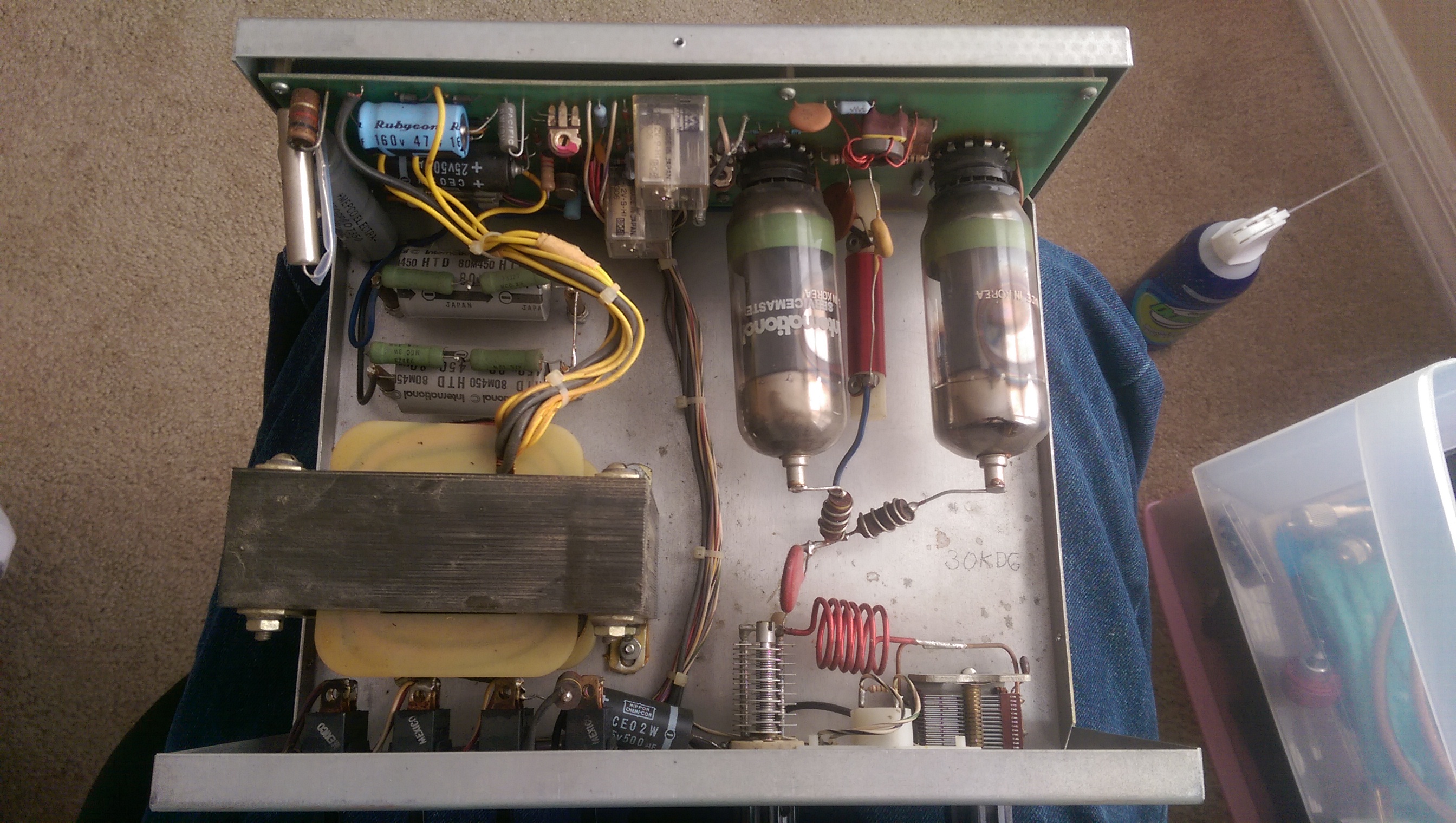

Take some pictures of the inside and let's see what you have there.

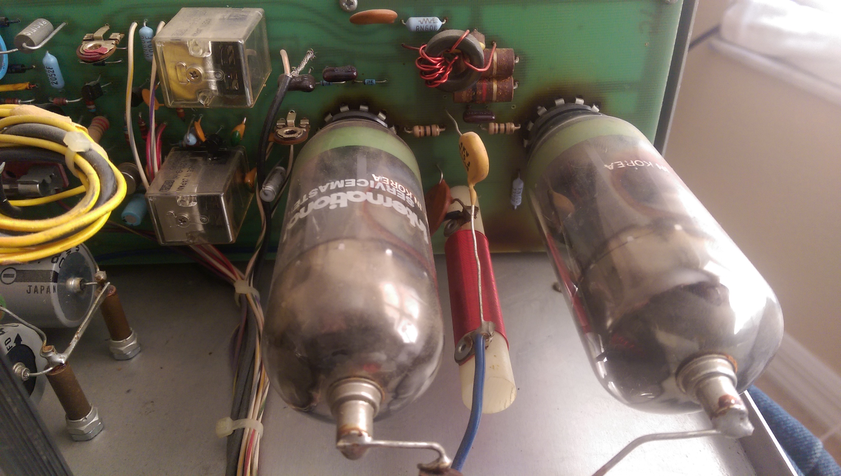

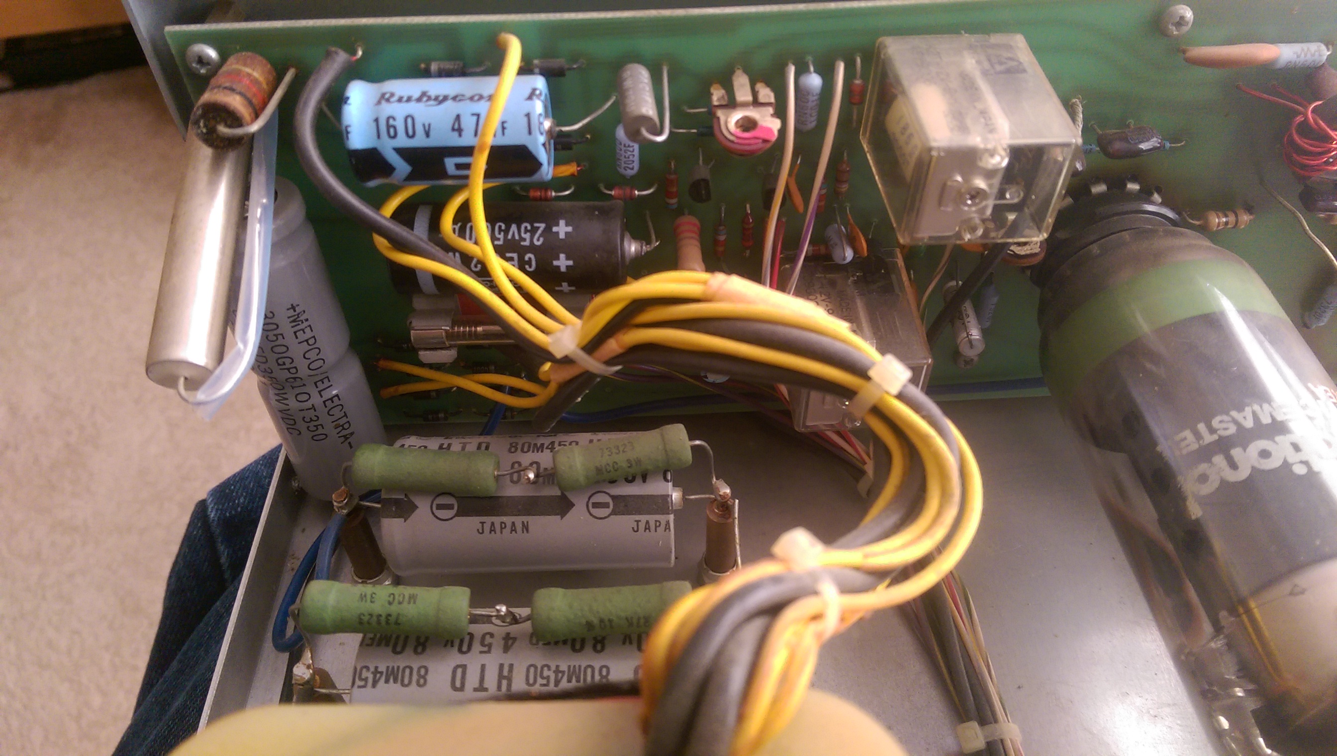

Tubes are 30KD6. See pics with the tube sockets (looks burned), I was thinking of using the powersupply on the left side to power 4-6 pills on the right side. Will also add fans to the case for cooling. ideas?
Take all of the tube parts out carefully including the transformer and store them so you can sell them once you are happy with the result. Those power transformers cost a bunch of money, and easily be sold for parts. PCB's too.
Put in a Megawatt power supply and drop in the amplifier of your choice.
