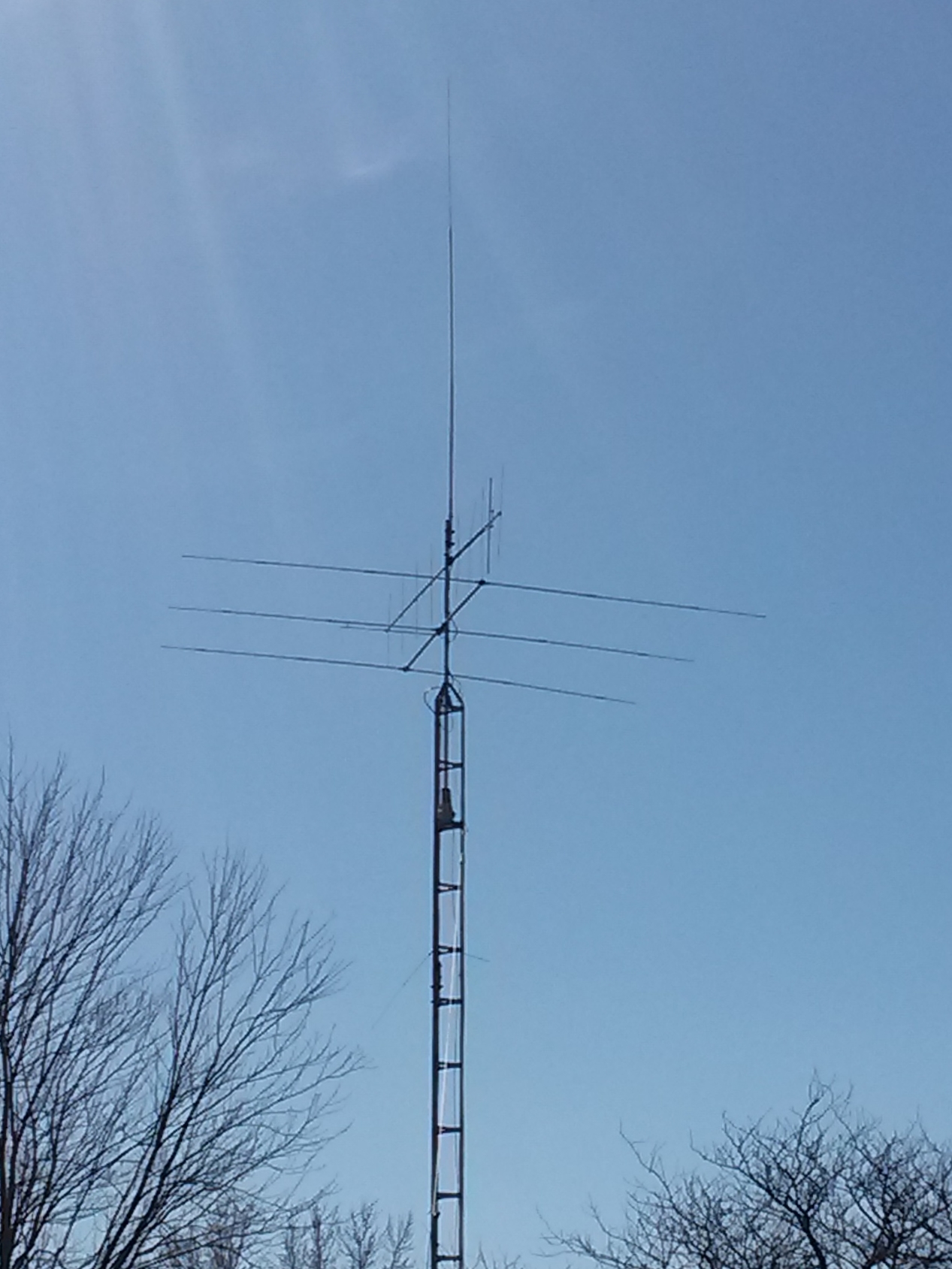

So I now have a Antron 99 on my tower. I didnt adjust the tunning rings and installed just how it came from the factory.
See my results below with a MFJ 259b analyzer hooked to it.
My coax is 75ft of Dx engenering DXE-8X.
Antenna is 45 above ground to the bottom of it.
I have a Cushcraft 10 element vert 2 meter yagi just below the A99. The swr was affected and is now above 2.0:1 from 144-148 mhz. I figured this would happen adding a vertical on top of another vertical antenna.
Below the Cushcraft yagi is a Sirio Sy27-3 yagi.
The Sirio is working great.
The Antron 99 is also working great.
The Cushcraft yagi is still working but the Swr is to high imo.
See picture below.
Antron 99 results with a Mfj 259b in its current mounted position as shown in the picture below.
17.827 mhz/
Swr-1.1:1/
R=50/
X=6/
18.110/ 18.168
Swr-2.2:1/ Swr-2.4:1
R=113/ R=106
X=10/ X=48
21.275/ 21.350
Swr-3.2:1/ Swr-3.3:1
R=13/ R=14
X=10/ X=14
24.930/ 24.980
Swr-2.9:1/ Swr-2.9:1
R=17/ R=18
X=1/ X=4
26.965/ 27.205/ 27.405/ 28.000
Swr-1.2:1/ Swr-1.0:1/ Swr-1.1:1/ Swr-1.7:1
R=62/ R=50/ R=46/ R=48
X=0/ X=4/ X=6/ X=27
28.300/ 28.400/ 29.000/ 29.600
Swr-2.1:1/ Swr-2.3:1/ Swr-3.2:1/ Swr-4.0:1
R=71/ R=87/ R=121/ R=29
X=47/ X=47/ x=83/ X=60
From my results I conclude the Antron 99 is usable from 17-10 meters with a antenna tuner. My Kenwood TS-2000 will tune the antenna up so there is no need for a wider range antenna tuner. I feel the Anton 99 when installed from the factory is a CB antenna first and foremost and a compromise on the amateur bands at best.
For the low price and ease of installation I'm quite happy with it.
I paid 65.00 dollars to my door for it.
