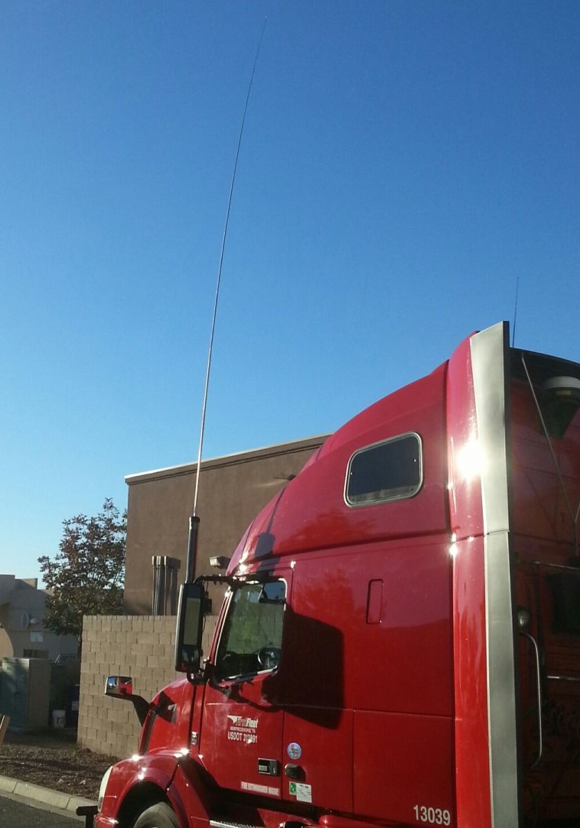

I use a 17ft telescoping whip for 80m when parked and that whip dramatically increases efficiency on 40 and 20m.
Just something to consider…
I have the High Sierra Sidekick, close to the small tarheel. I use a 72" whip and while its not as nice as the 17' option I can tune 80 much better.
The longer the better!
Try a 17ft whip when your stationary (obviously). it'll really increase the efficiency. That'll make up some gain for not being able to run an amp.
On 20m (and above) you'll have to collapse it some because it's already a 1/4 wavelength on 20m.
