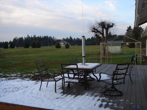

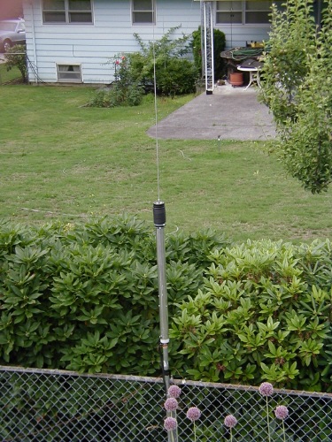

Been stuck in the apartment "stuff" before....
Having been around a little more since then....
I would be looking to do something like this!.....
Most certainly if I was 2 or more stories up and had ALUM gutters to use for a counterpoise....
I covered my "Balcony deck with "chicken wire" ;)....and used a Hustler Mast and loads....
