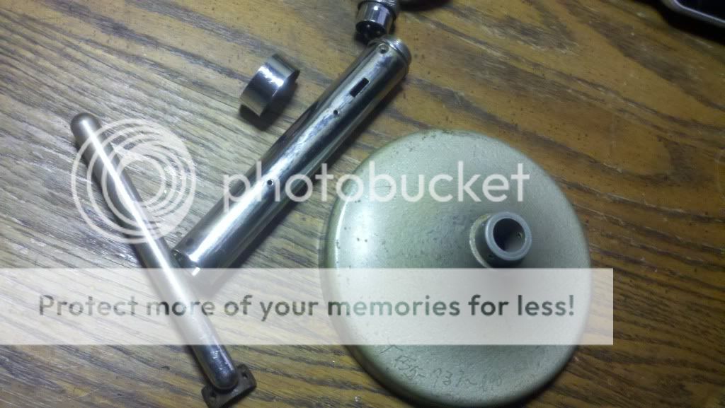

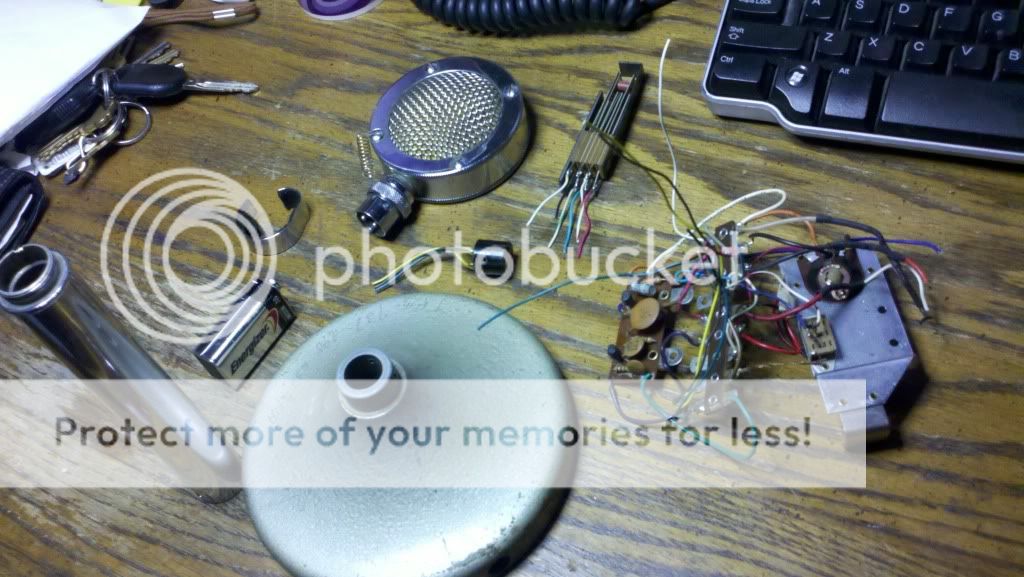

lastnight i dismantled it time to rebuild.
im going to clean up the chrome and paint the base black or gold flake black.
the spring gives it that Japanese gong / ping sound when i key up :)
the element is nothing like i have seen before? it has Asbestos attached to the grill and the element is like a thin sheet of aluminum on the back is two wires red and white. i will be re soldering those wires on the mic to give it a clean look and a new 9 volt plug.
Check out Rustoleum #7213 Silver "Hammered" to match the original Astatic base finish.

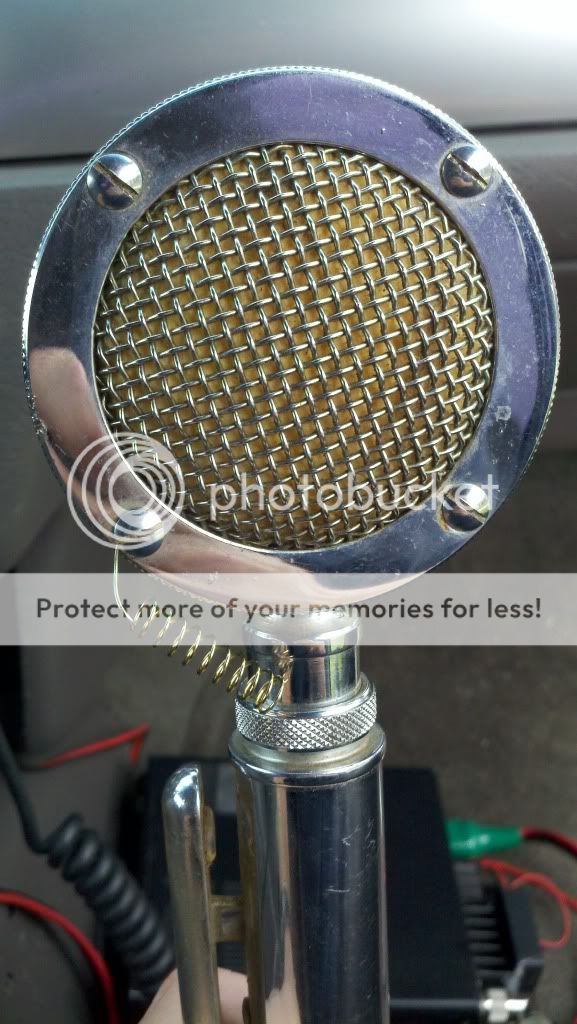

still has intermid static on transmit. needs a new cap on the amp section. i rewired the inside of the neck ptt and the base, onvously repainted and cleaned up the chrome. chicken choke has to be re chromed.
Get rid of that crappy preamp in the base of the microphone and build a new one,there is a good preamp design at grinchradio website,just google the site.

I gave an old D104 to a local just recently, and he built that same FET preamp for it.
