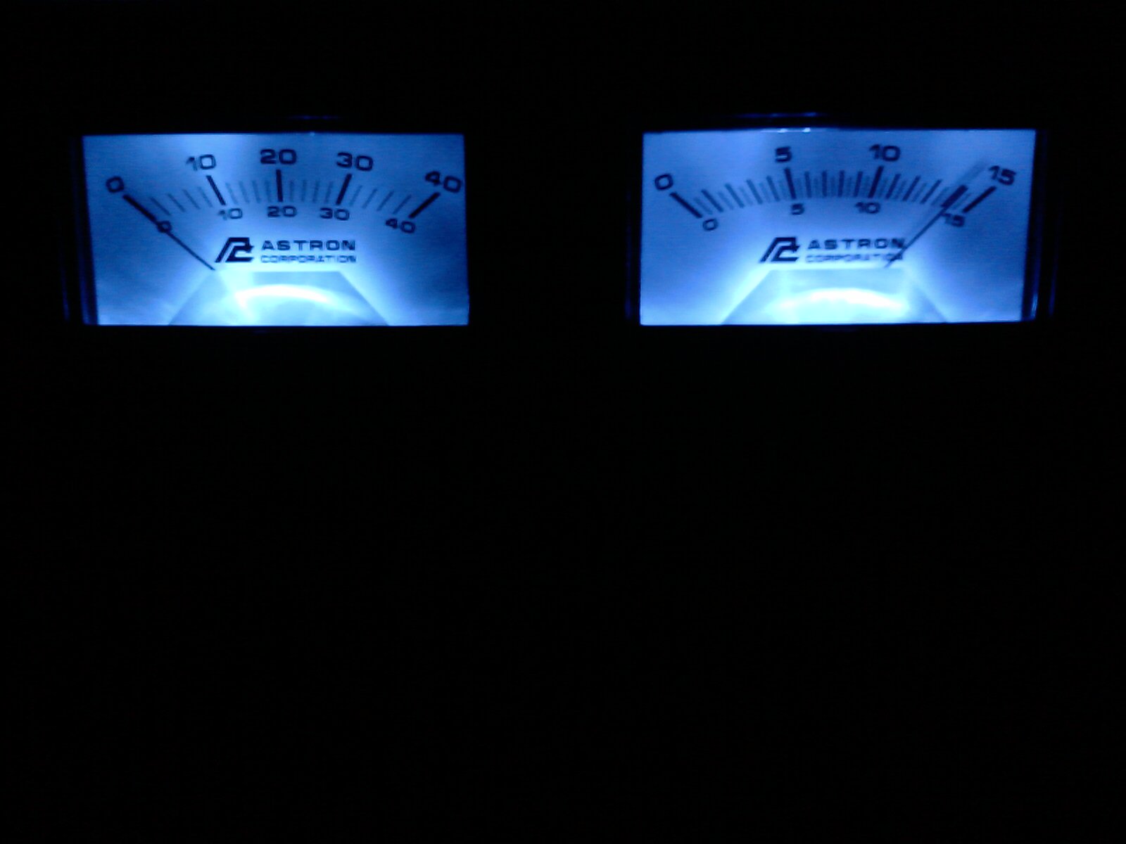

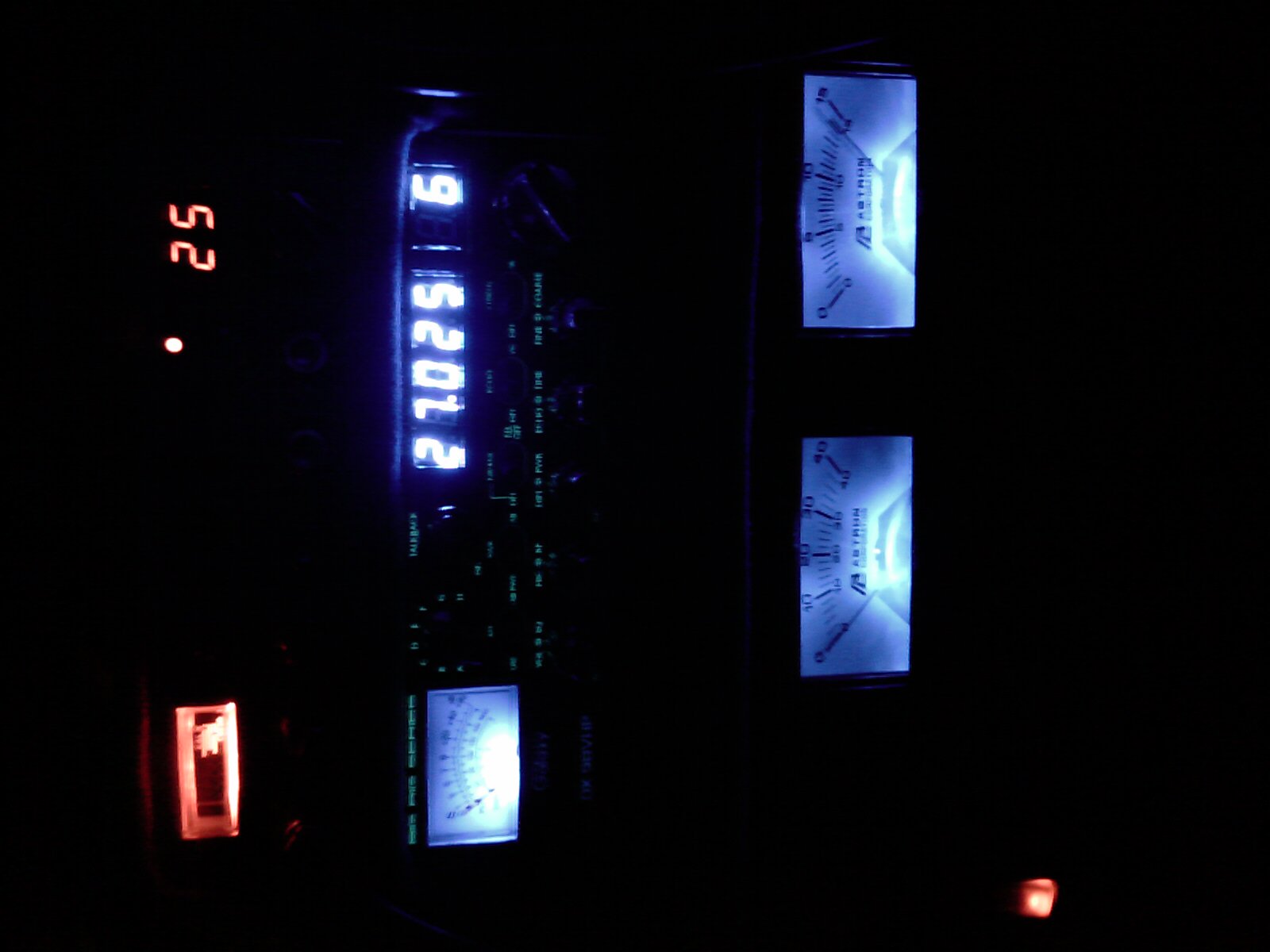

I know some discussion has been made about meter lights on some Astron models. Mine had no meter lights. With alittle patients and a few led's you can add lights to the meters. I know you can purchase lighted meters from Astron. But I wanted to give it a shot myself. The meters are sealed. If your careful you can seperate them. The rocker switch will be canged to blue as soon as it arrives. I was planning on putting a switch on the led's as well.
Here are a few pics I wanted to share of my RS 35M with blue led's.

I have also done this with a few different power supplies and swr power meters. all it takes is a few minutes.

i usually dont like blue led's cause theyre so darn bright . but those meters have a nice blue glow . i just got a rs-35m , only had it a day but no problems yet .

It's going to depend a lot on just how those meters are made. Some are opaque enough that positioning those LEDs can get sort of complicated. Some have face plates/back plates that light will shine through. I have no idea what yours are like. Another qwerk of LEDs is that most of the light is aimed straight forward from then, very little to the 'sides', which can get to be fun when trying to spread that light around a little.

Just a quick note on one way to make those LED's have a broader pattern of light rather then the pin point spot light effect. If you sand the round part of the lens down with sand paper you can broaden the light pattern up quite a bit. Also, when the Astron stops making output voltage under load, simply replace the LM723 IC voltage regulator on the board. It's an easy fix when it goes bad since the chip is in a socket. It's the number 1 failure in Astron power supplies.
