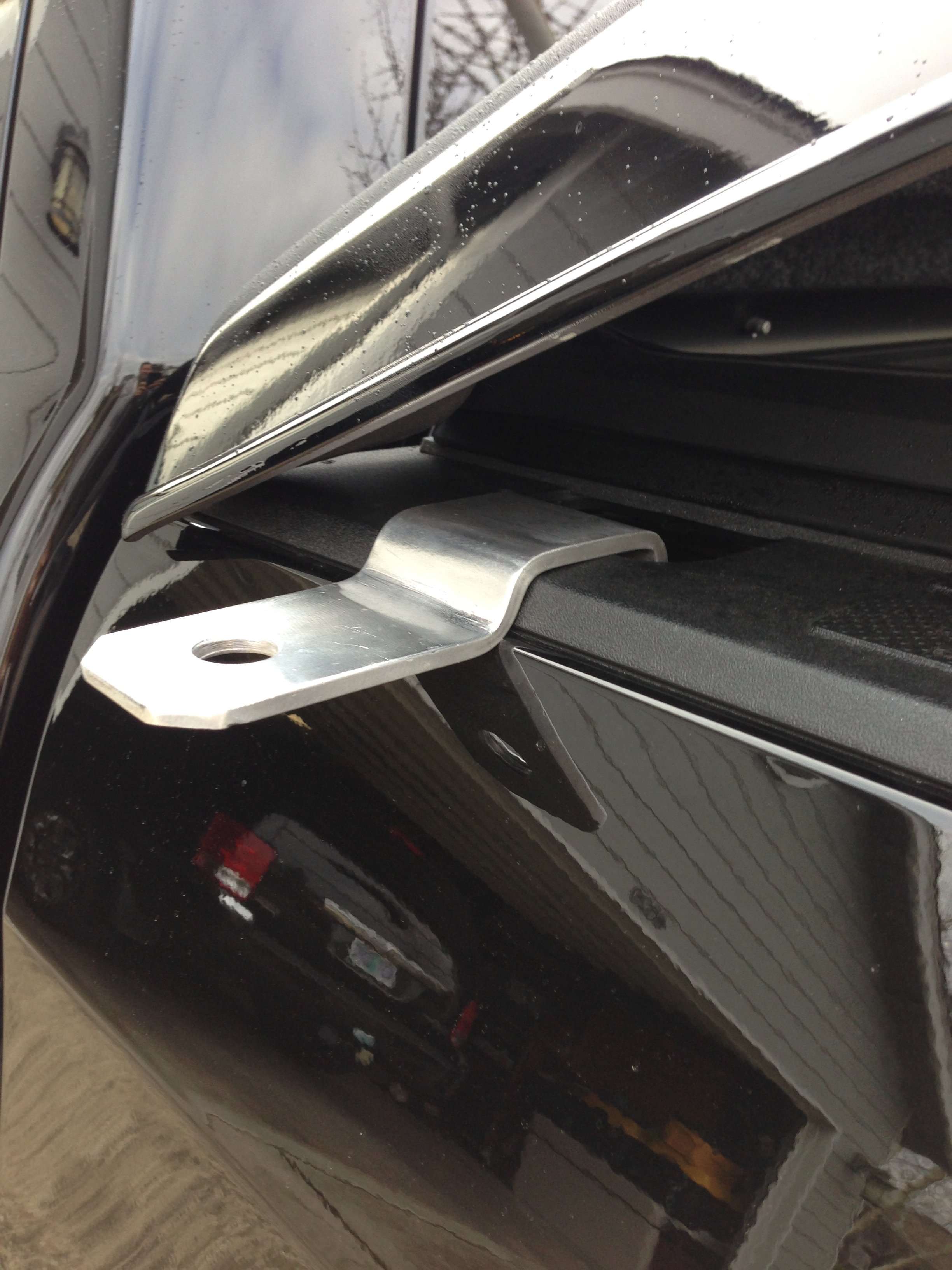

I use a bracket custom made for my ATAS 120, been using them on 3 different vehicles since 2006. Bolts into the stake pocket and I run a ground below to the frame.

Reactions: Mudfoot
