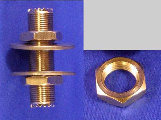

Since you already have a hole in your trunk, why not make the hole big enough to mount a barrel connector click here SO-239 BARREL CONNECTOR
You may need a large type fender washer under the connector inside the trunk for a little bit more support.
Thank You HH! I've been looking for something like this. While I do believe the K400 would work fine, I much prefer to use the existing hole I have in the trunk lid (even if it needs enlarging/reinforcing). I didn't much care for the Diamond RG 316 coax. This will allow me to use something better (LMR-400UF?)

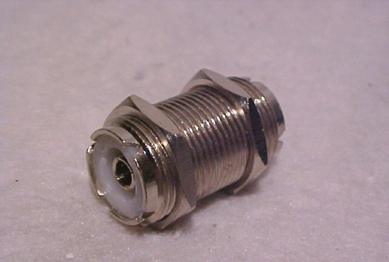

Those bolts shown above will work too. Just make sure its grounded properly. This antenna is very picky..but if its grounded right, it will work the balls.
