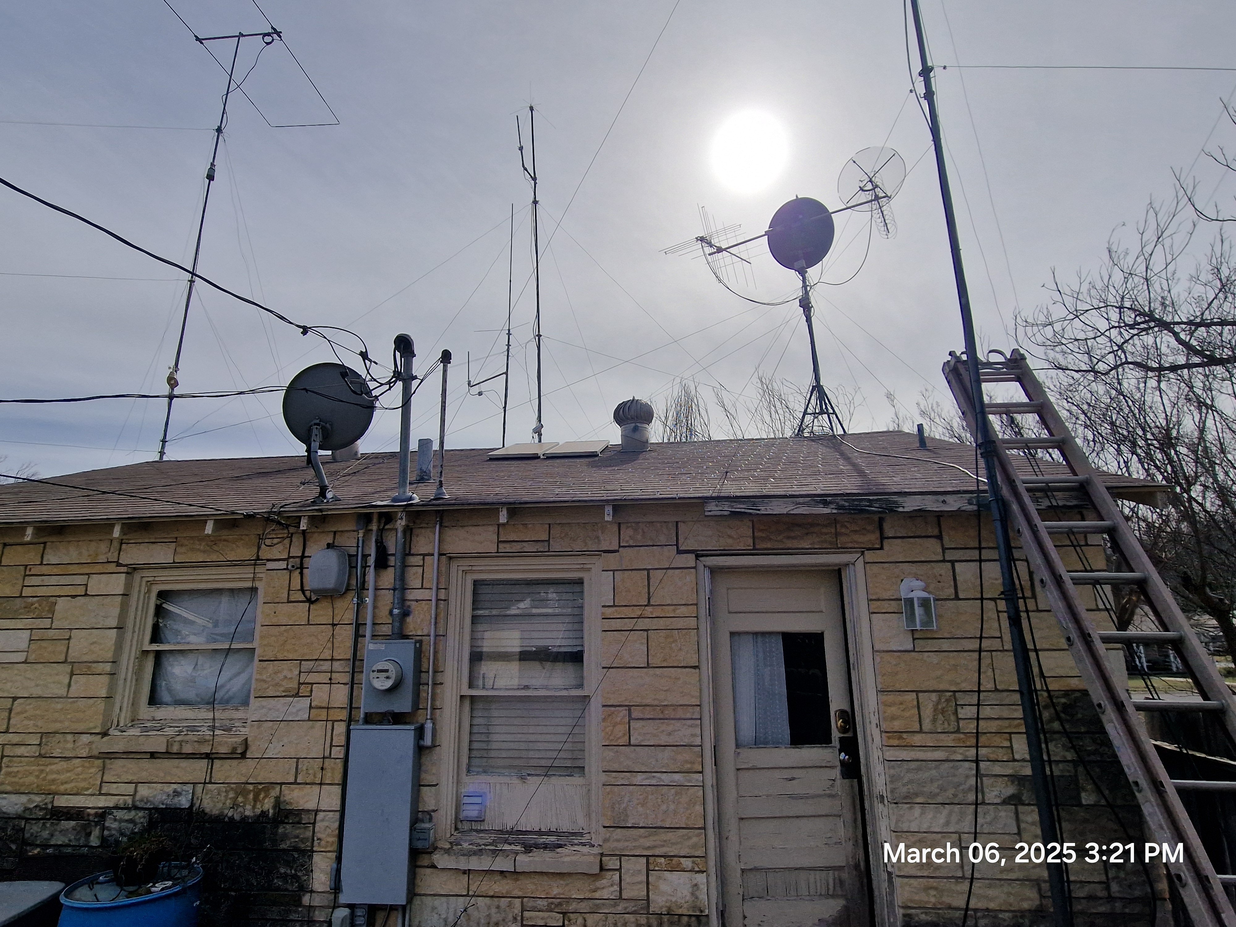

I have a Discone for the scanner but it can also be used to transmit. It is my highest antenna. Second down I have 2m/70cm vertical that is going to the FT-847. Don't know about the other bands but would put up at least two antennas if I was looking for that coverage.
