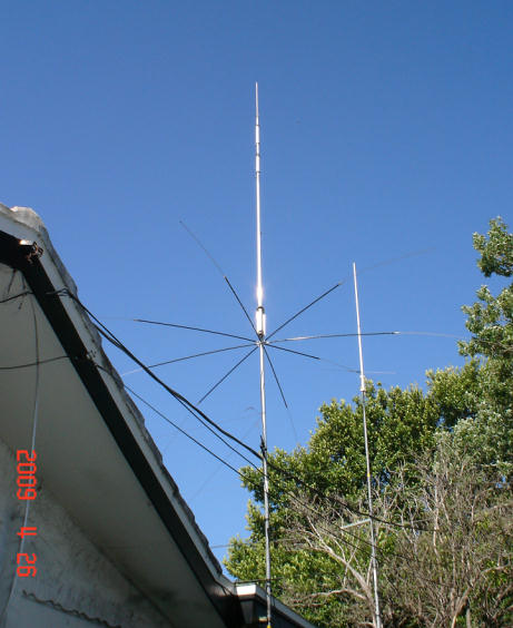

It is like the JETSTREAM JTB5 antennas sold by R&L Electronics .... I have had several of them they work well.
R&L Electronics
my old one liiked like this ... it is the one to the back and on the right ...

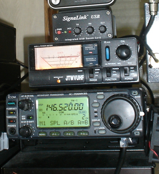

What frequency are you planning on using the SWR meter. You may be hard pressed to find one that covers HF & VHF/UHF. A MFJ 259B analyzer would be a good choice, but not cheap...

I got a Diamond dual band SWR/Power meter at HRO for about $60.
Thank for the info guys. I dont plan on using it in the 440Mhz. mainly just 151.700 is what we'll be running. and up or down a few.. Im not looking for any crazy meter just one that'll give me a good reading so i know im not damaging the radio or anything else..
"...mainly just 151.700 is what we'll be running..."
Then I would suggest getting a radio approved for that band, not an amateur radio. The only reasonably priced one that I've had any experience with is one of the 'Wouxun's, an HT. As for an antenna, you could probably cut down an amateur 2 meter band antenna and have it do just fine.
