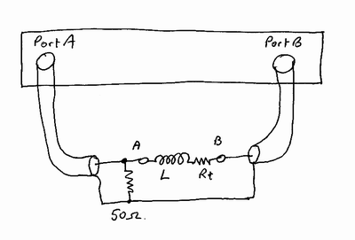

This is the arrangement I use for 2-port VNA measurements:
Firstly calibrate the VNA by lifting the two coax tails (from Points A&B) and connecting them together.
Then connect the choke between A & B and make a measurement of S21 Amplitude and Phase.
Then:
Zchoke = 50*(10^(-S21amp)/20) - 50
Rchoke = Zchoke*COS(-S21phase)
Xchoke = Zchoke*SIN(-S21phase)
The 2-port method gives more accurate results and can cope with much higher choke impedances.
73,
Steve G3TXQ
