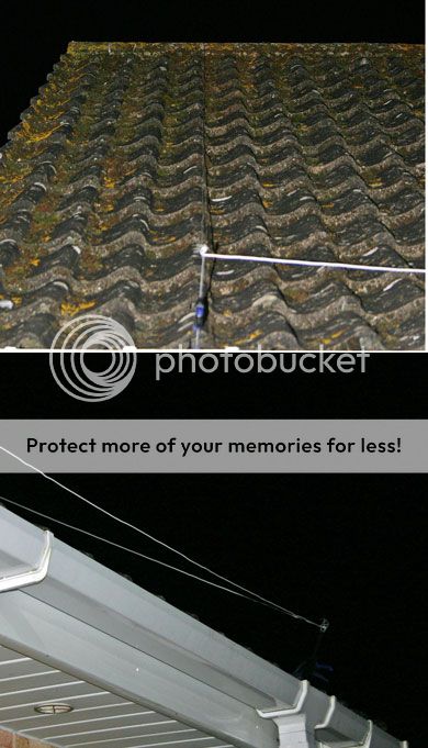

Hi,
Get a lot of channels towards evening on Band 5.7 but the other bands are pretty silent. Sometimes find a signal or two on Band 11.5
Would boosting my antenna help? Currently I have sheathed copper wire going round half the rooftop
- could I double back on this by adding a new length of wire - would this improve my reception please?
Also have an old tv loop antenna - was wondering if hooking that into the rooftop wire set up might produce some unexpected results?

What frequencies are you talking about? Band 5.7 and Band 11.5? Are you talking shortwave 5.7 Megahertz and 11.7 Megahertz aka the 49m and 25m bands?
Yes - sorry, I'm new to this - have results at shortwave 5.7 Megahertz and (less so at) 11.7 Megahertz.
Also have SW Mhz Bands 3.5, 7, 9.5, 14, 15, 17.5 & 27 which are pretty quiet day & night.
Would adding to the antenna help please?
Thanks,
R
For general shortwave reception a wire antenna as long and as high and as in the clear as you can get it will work the best. Anything less is a exactly that....less. I miss the good old days of my 600 foot long end fed wire that was about 10-15 feet off the ground suspended from various trees running roughly in a straight line towards the north-west. I could hear an ant fart in Mongolia :D but then again I could also hear the 10 Kw driver output in standby mode leaking thru the finals from the LF navy transmitter 12 miles line-of-sight away too.:confused: Key down output was 250 Kw which made my receiver scream in pain. :eek:
Thanks, I guess I'll just double up on the copper I've already got on the roof - can't do any harm and might rope me in some more stations.
Can't find that loop antenna anyway - under a ton of stuff somewhere in the garage no doubt :LOL:
