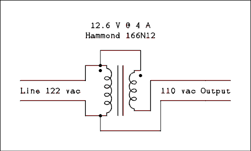

This diagram is wired/phased to "buck" (the 12.6 volt secondary lowers the primary voltage by 12.6VAC) To wire it for 12.6V of "boost", you invert the polarity of the secondary. The transformer needs to be the same VA as the plate transformer it's feeding. The amount it boost/bucks is determined by the secondary voltage of the transformer. A 24V secondary would give 24VAC of boost/buck.

In this setup , yes , I can understand that you would need it to be the same va as the main transformer but isn't there a way to accomplish this with a smaller unit? I saw a website that was showing something about it only needing to be the total power of the bucking.
Yes, most of the line current flows through the secondary of the boost/buck transformer so in theory, this winding is what needs to be of sufficient gauge to handle the amps the line is drawing. So lets say the plate transformer is 120 in and 1200 out at 1 amp, it will be pulling roughly 10 amps from the 120V line at full load. The Boost/Buck transformer needs only the secondary to be beefy enough to withstand 10 amps. One way to get a 24V Boost/buck on the cheap is to use a transformer out of a junk Pyramid/Astron/Tripplite power supply. A transformer from a 35 amp supply can be used to Boost/Buck up to 35 amps of line current. You can use 2 of them in series/parallel to Boost/Buck a 240V line.

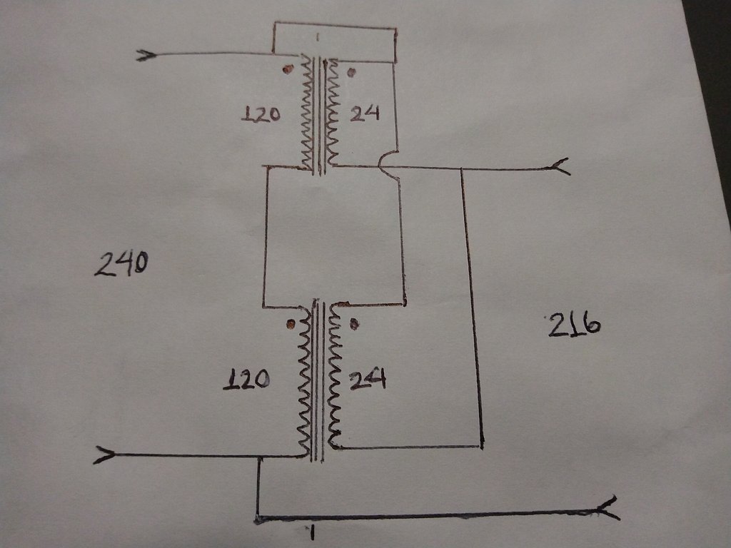

Could you draw out how this would be connected using a second transformer as you described?
I don't have a scanner or printer right now and I got a lot going on for the next couple days but when I get a minute I can hand draw it and take a pic with my phone and post it up.

Do you know how to phase transformer windings? (start and finish of each winding)

Unless they are marked I've just been verifying with a variac. I've successfully series and parallelled transformers before.
This example is using a pair of 120VAC primary 24VAC secondary Pyramid/Astron/Tripplite transformers with the primaries in series for use on a 240V line. This is configured for "Buck" mode to reduce 240 to 216. For "Boost" mode, everything is the same except swapping both secondary windings end to end to get 24 volts of boost. (264VAC) The "dot" on each winding is the "start" lead which is the end of the winding closest to the core/bobbin. Phasing parallel transformers is important so they don't fight each other. Remember when bridging two transformers like this they must be identical voltage and current wise. You can test it first with a variac set for 24VAC before you hit it with full voltage.
