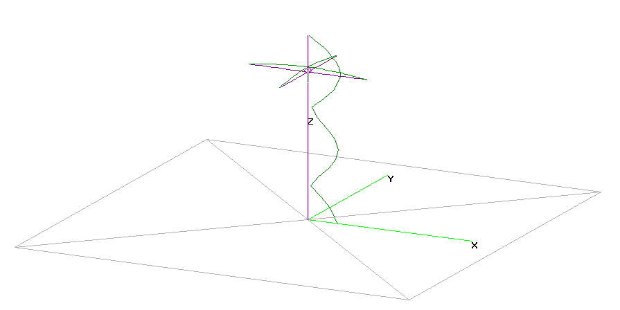

Wow, just wow. Did you actually look at the models in that linked album?
I have a few suggestions for you.
Look at what is being shown in the album, specifically the two models at 36 feet above ground. I will post them here side by side to show you...
[photo=medium]6508[/photo][photo=medium]6510[/photo]
Does doubling the number of radials affect the currents on the mast at all? Nope.
Will adding more radials have any significant effect? Nope.
Why? Ohm's Law.
