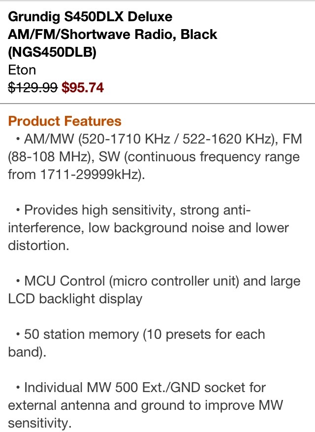

Is this it? Here's some specs but I'm familiar with it
Maybe someone else can steer you in the right direction for an external antenna
