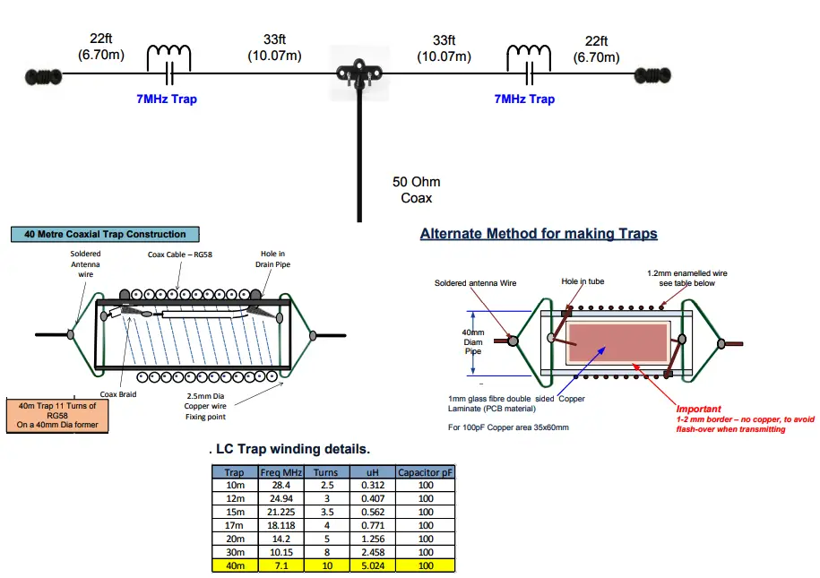

aka a fan dipole, aka HexBeam. Probably others I'm not thinking of. It's late.

What most replies here seem to suggest are multiband antennas—those that operate passively by radiating on the elements that are resonant for whatever frequency is present on the feedline. Fan Dipoles, Whiskers, Spiderwebs and Hexes all sit comfortably in this category. In those antennas however, the signal is being fed to all connected elements and one could argue that there is loss from RF energy being fed into the non-resonant elements. SWR matching also is an onerous task, as every antenna will reflect energy back down the feedline based on antenna height, proximity to other electrically conductive objects and precise construction measurements, just to identify three of the most common.
