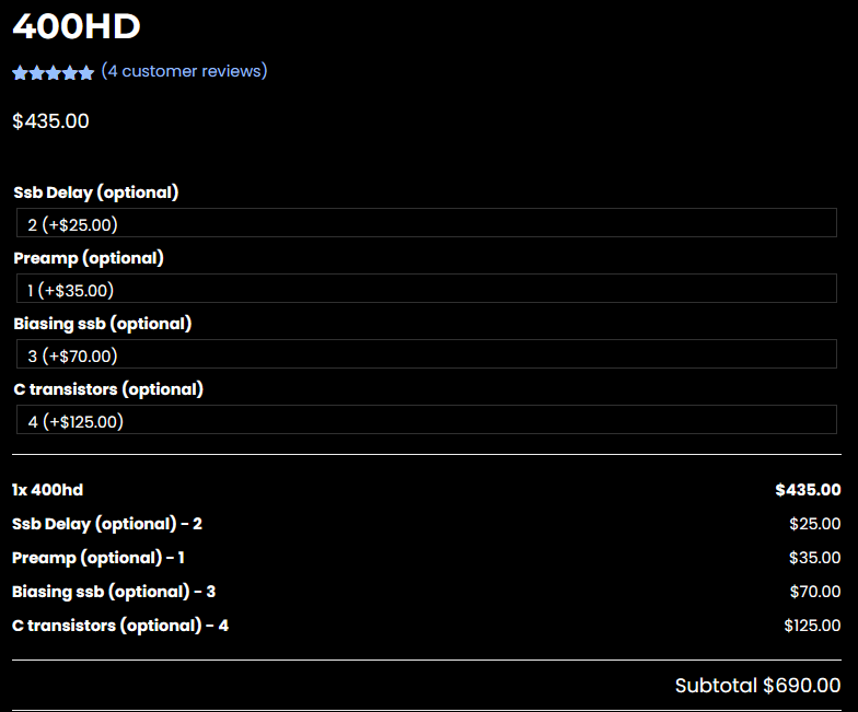

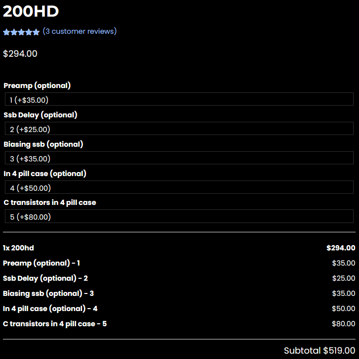

Actually Carl does build biased amps, you just have to check the box for it at the time of purchase.

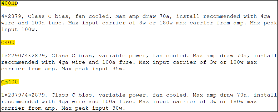

The bias he uses is class B schottky diodes and resistors. Garbage amps.

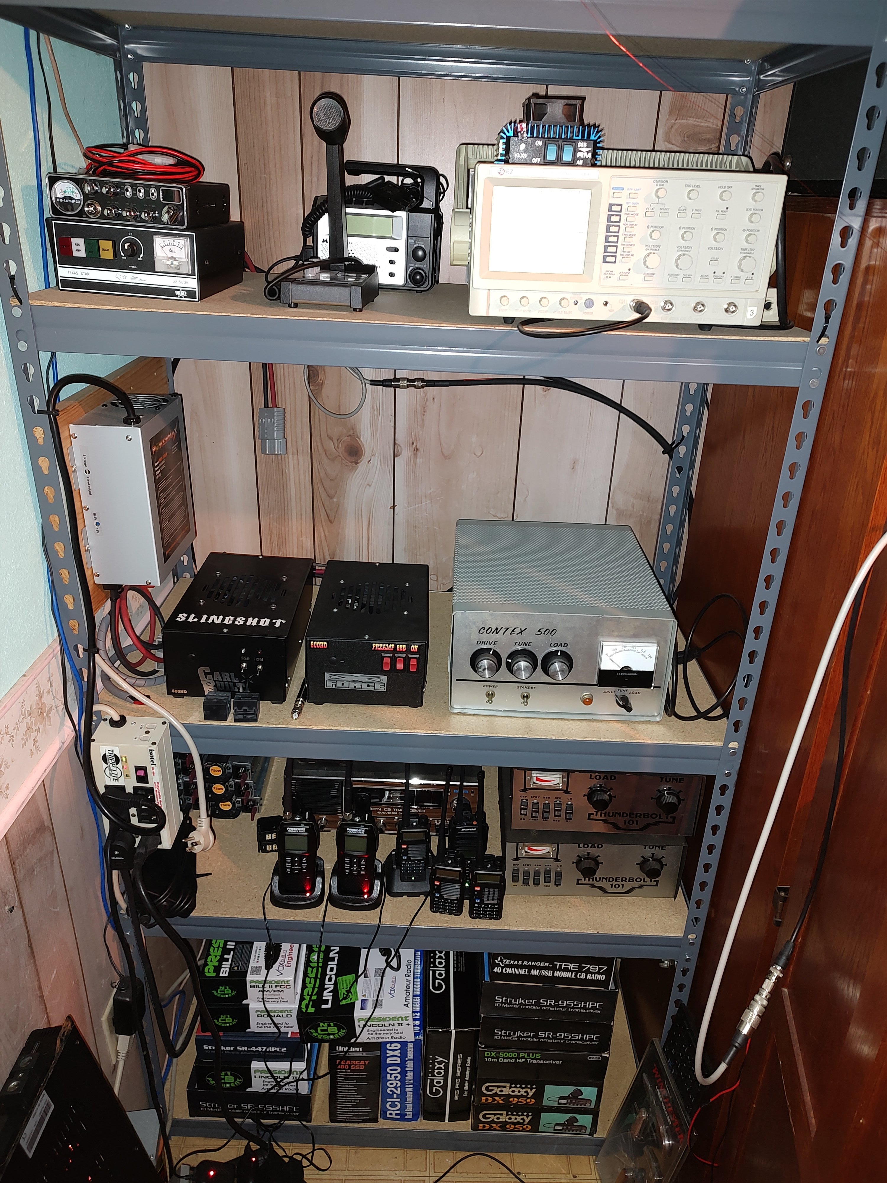

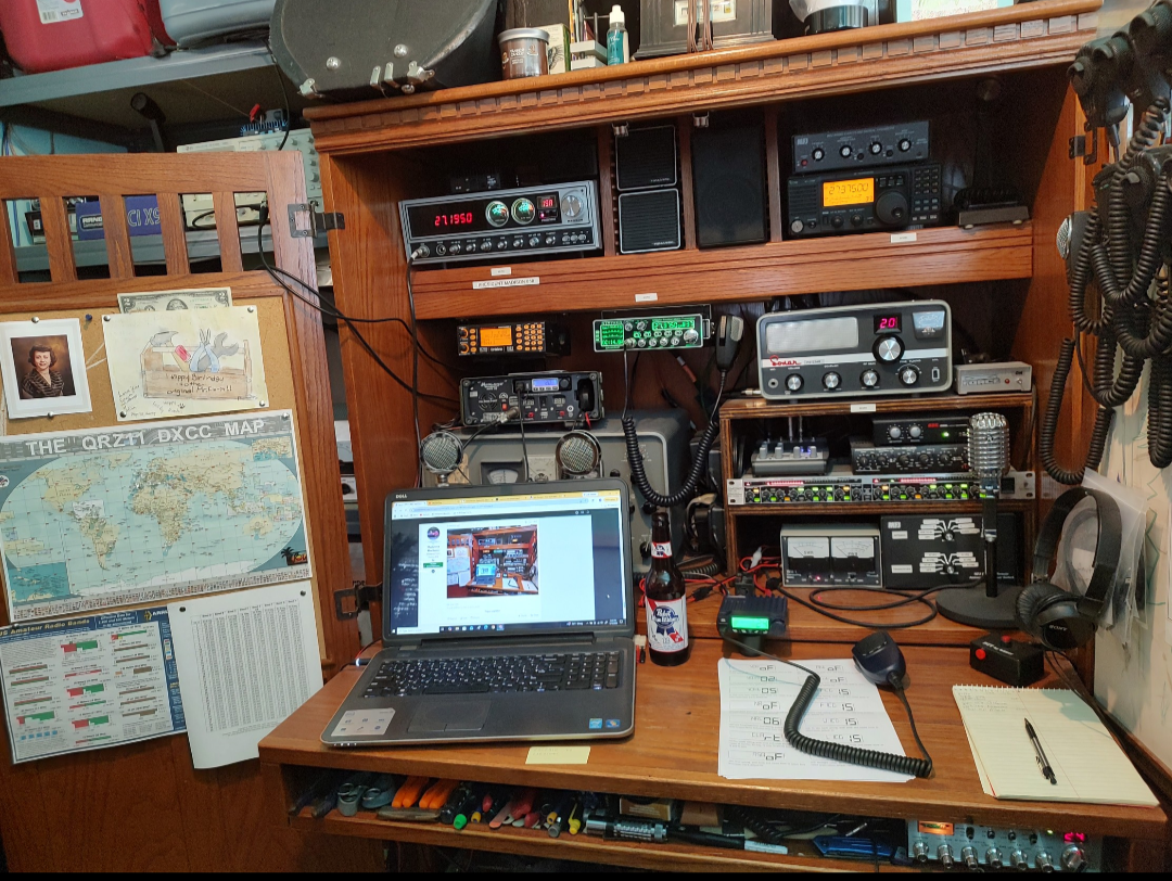

This is on my bench today

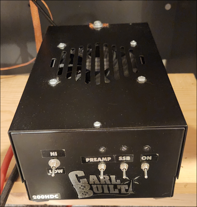

Make sure you keep the fan and vents clear and clean of dust and obstructions.
have you seen fan failure or overheating issues with Carl's boxes? c80 and hd200 models with lots of talk time on ssb. with 7w PEP per 2879 and 5w per 2290, these boxes have never got above 100° in a 70° environment, or a poor audio report on ssb. kept clean, smoke free, and with a low standing wave.
original poster: i recommend the variable power option. 1 of the boxes i have does NOT like the high position on the output power switch (200hd). having a panel meter showing draw on the power supply and a decent swr meter told me something was set to go way too hot. i stay away from what he recommends for drive input or power output.
Did not say they overheated, this is just a precaution I mentioned as some might not be aware to keep the vents in the clear and the fan area clean.
