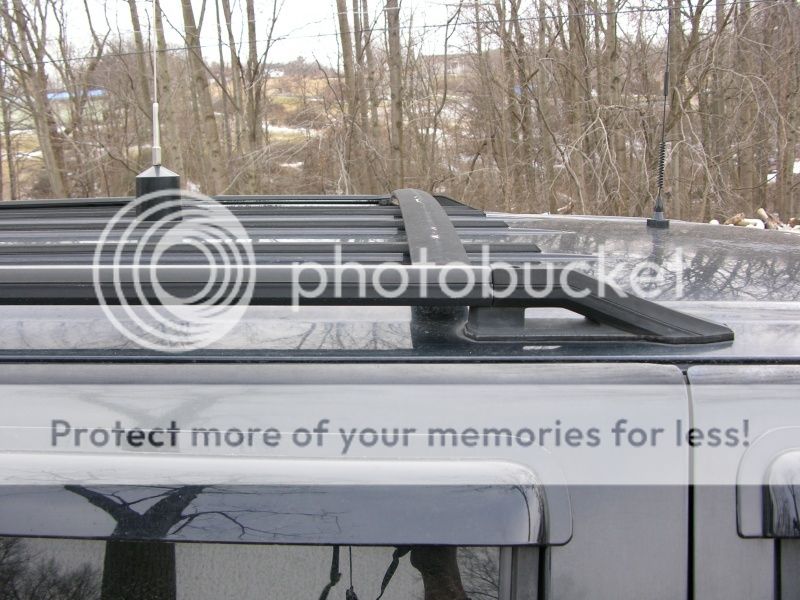

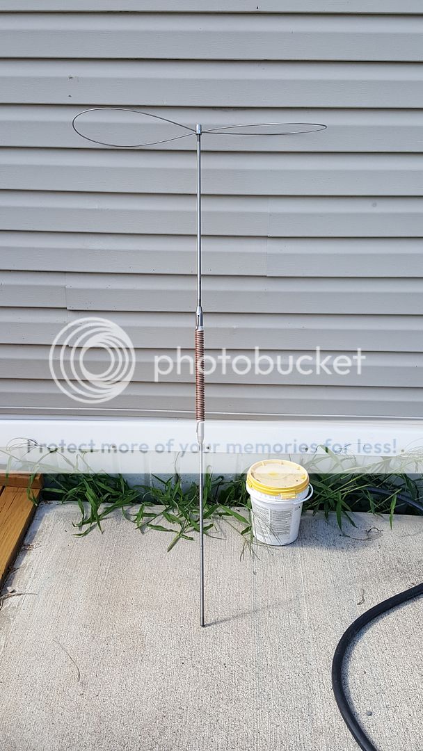

It depends on the vehicle and the mounting location. Center load is ideal but unfortunately nobody seems to make a center load antenna for a tractor trailer so you pretty much have to make one yourself from scratch like these. These would work great on the roof of a car or truck but unfortunately they would also rip a hole in your roof if you hit a bird at 65 miles an hour.
A center load on a tractor trailer still won't perform anywhere close to how this bottom load performs on my Chevy Tahoe though.

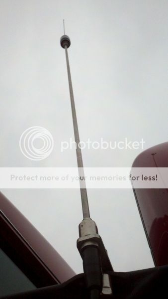

Geez Rabbi I thought you were more knowledgeable on mobile CB antennas. There is plenty of center load mobile antennas out there that can be used for cars or trucks!
The Predator 10 K first comes to mind like the one pictured below., Monkey made, K-40 SS steel coil, and even those steel coil truck stop cheapies are center loaded.

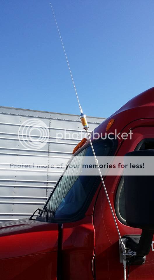

Unfortunately none of those antennas have a tunable coil and are a predetermined length. You are correct they can be used in any situation but they will never be ideal for every situation. The ideal antenna would be as long as possible but with a tractor trailer that's generally not going to happen so to make it as long as possible would require a custom coil tuned to match a specific length to fit within a specific space on a specific vehicle. Sure I could put a gunny Puck on the roof of my Tahoe and put a heavy antenna on top of it and smash into a tree branch and rip a hole in my roof but why would I want to do such a thing when I can make such a small compromise and put a bottom load on and enjoy the benefits of having a huge sheet metal roof?

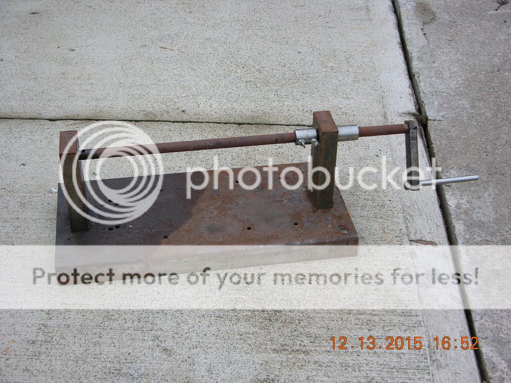

You can put the world's greatest antenna on a tractor trailer and it will still not ever come close to the performance I can get out of a bottom load antenna on top of a giant sheet metal roof. One nice thing about my antennas is that I can make them any length I want and simply tune the coil to match the physical length. This coil Winder sure comes in handy for making uniform spacing.

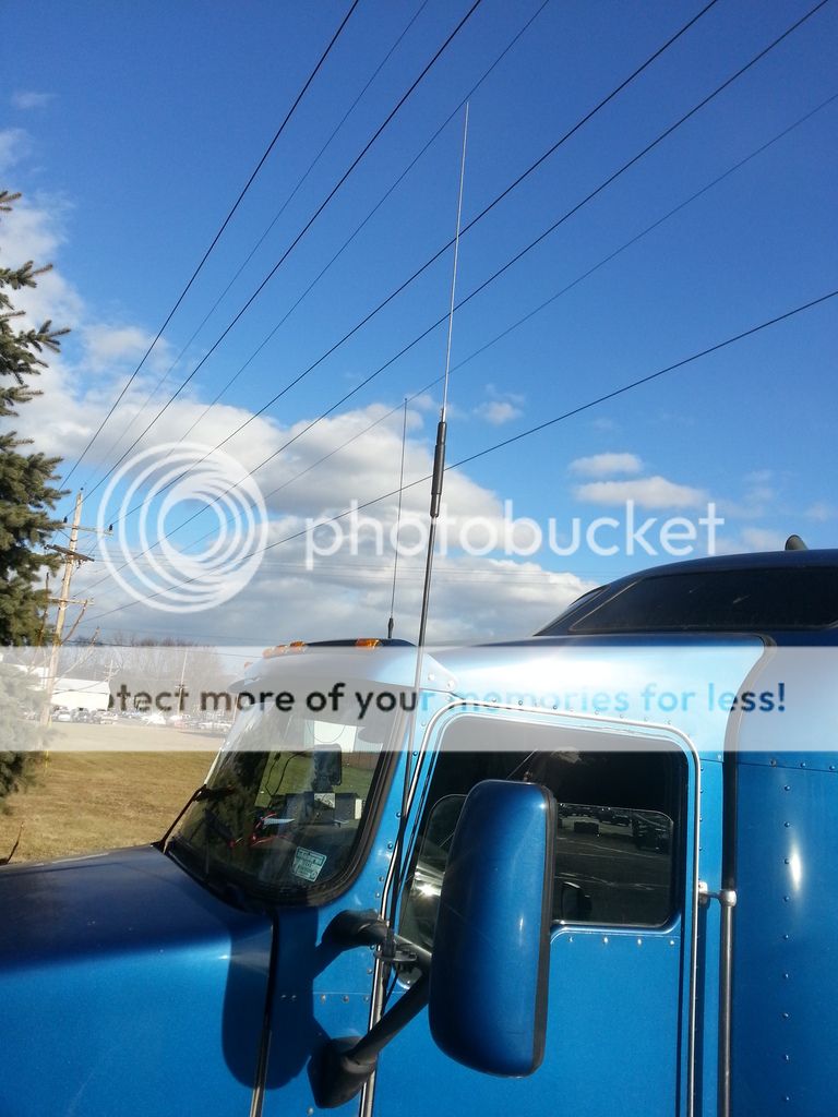

If I had a Kenworth T600 with an antenna mounting location 81 inches off the ground that would give me 81 inches of room to put an antenna without going over my height restriction and unfortunately none of those manufacturers make an 81 inch antenna so I had to build one for myself and tune the coil to match the Physical length. In a perfect world, The antenna should be as long as possible and the coil should be as short as possible which means that every antenna should be custom built for the specific Vehicle and the height restrictions. Nobody wants to pay that kind of money that's why we have monkey made and Predator 10-K antennas available to the public
