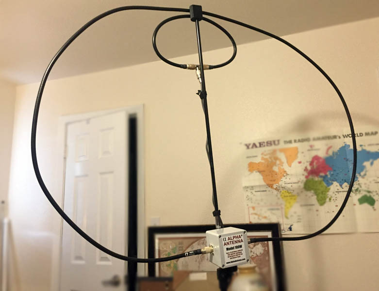

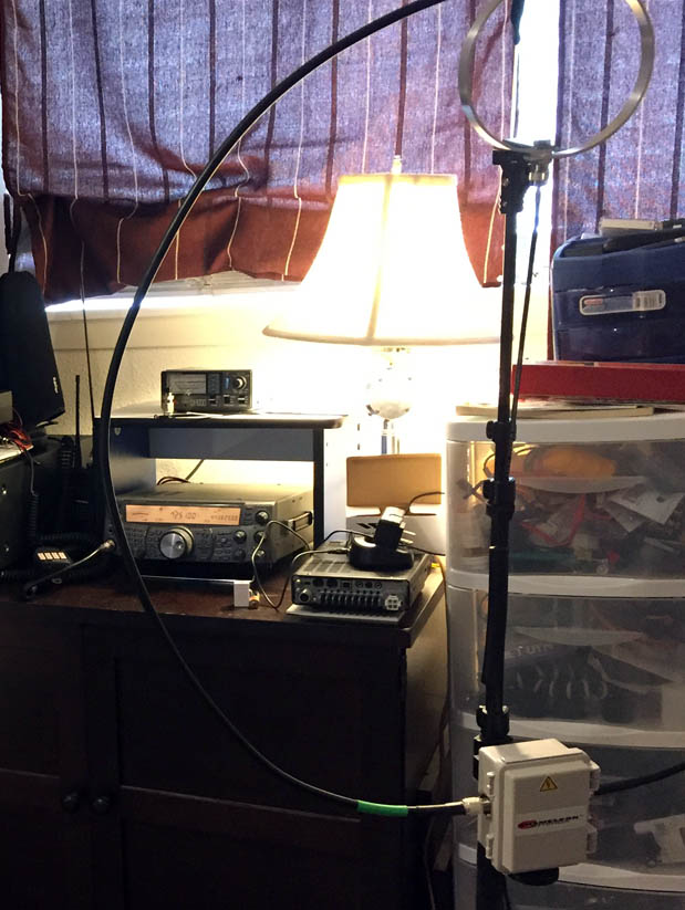

I found a shot of the Chameleon and here's one of the Alpha as well ;)
Did those work good indoors next to your station? I wanted to do that but was always afraid the strong magnetic field would harm the hard drive in my PC or the monitor :eek:, screw up my wifi router :mad:, or ruin my TV :(. LOL. :ROFLMAO:

Yes, works good (y) My wifi router in mounted to the wall 5' from the loop (as well as my pc) what I've been able to do is slowly rotate the antenna until the null reduces the noise. As pictured, one null is pointed in the direction of the rig, while on the side, the null points to my pc/router.
Because you have to re-tune quite a bit having it in the same room is necessary, albeit dangerous. With only 4-5 watts there is several thousand volts on the skin of the loop:eek:
